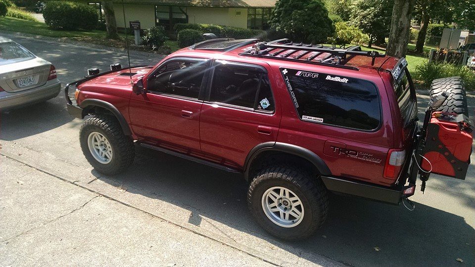

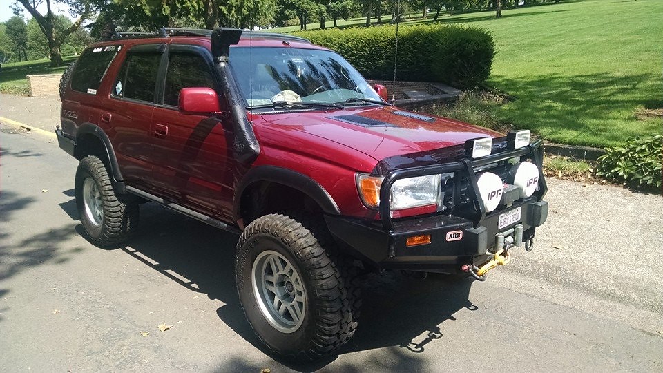

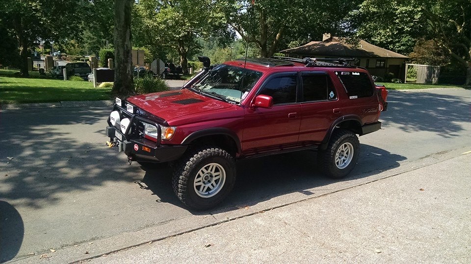

now to the OP my i suggest buying some run cool hood vents RunCool Hood Louvers - Hood Vents For Your Vehicle - Cool Your EngineHood Louvers | RunCool | Hood Vents For Your Vehicle ? i put a set on my runner and wow there was a huge improvement in under hood temps. so much so that my dual Efans did not have to run constantly, and only ran intermittently. you can see and feel the heat venting from these even after the truck is shut down. not to mention they look cool and are easy to install.
