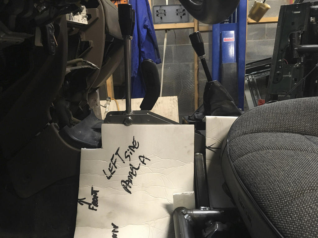

So I gave up on the brakes for the night and I started designing the center console area as best I could by making templates to cut from 18 gauge sheet metal. Then got tired (been a long day at work). Oh well, I'll take the day off tomorrow and get as much as I can get finished.

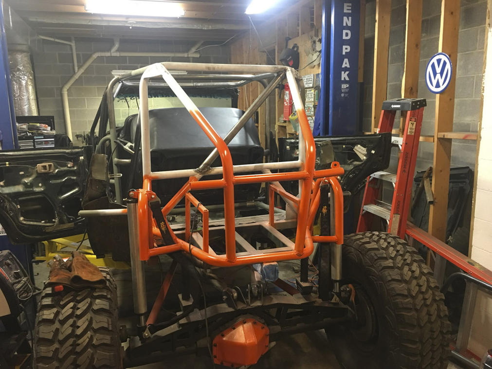

Took the day off Wednesday to get more done. The amount of work left to do is starting to spook me a little. Spent the morning my oldest son, who just graduated High School, on supply runs. Mig wire, flap disks, return a broken grinder, and you know a bunch of other piddly $h!t that can stop you dead in your tracks on the weekend when all the welding supply places are closed. Then spent the rest of the afternoon in my happy place welding away.
Still waiting on some brake supplies and a few other parts that will be in today, so I started final welding on the items I knew I wasn't going to change. Started from the back and working my way forward. The entire back half of the cage is fully welded, except for the seat harness supports and the rest of the cross bracing. In between phone calls, and letting things cool off, I tried to be efficient and not waste my time, so I painted what I knew was finished and started making mounting points to bolt the rear quarters back on. You won't see any of the suspension tube unless you look inside.
For those of you wondering why I cantilevered the rear shock hoops, It is so I have an additional mounting point for the rear quarter sheet metal. And yes, some of my welds look like crap, but are strong like bull! Being 6'4" with bad knees it's difficult to climb around in those tight spaces to get good welds that also look pretty. Besides if I wanted pretty, I would TIG them and take my time. I'm on a schedule and it's an offroad vehicle designed to get beat up and look like a turd...soooooo, nice stacks of dimes and shiny paint or powder coating isn't feasible. A rattle can of primer and Kobota Orange, however, is perfect. :pimp:
If you don't know much about building roll cages, it's all about the Trigonometry. Triangulation baby! The smaller the triangle (space between tube sections) and the shorter the tube runs and bends, the stronger the cage. Also, don't make any stops in the center of a tube because as the force of an impact is distributed, the force will stop at the end and bend the next tube (think crumple zone). You want to place another tube on the other side to continue distributing the force around the passenger compartment to a safe and stronger stopping point, like the frame for instance. Look at the next picture at the rear cross bracing (blue arrow). The cross tube continues down at the same exact angle past the first section of tubing as if flowing through the horizontal tube, which essentially that's what the impact energy will do. Yes, I'm going to do that going the other way too. Why? Cause my kids will be back there that's why.

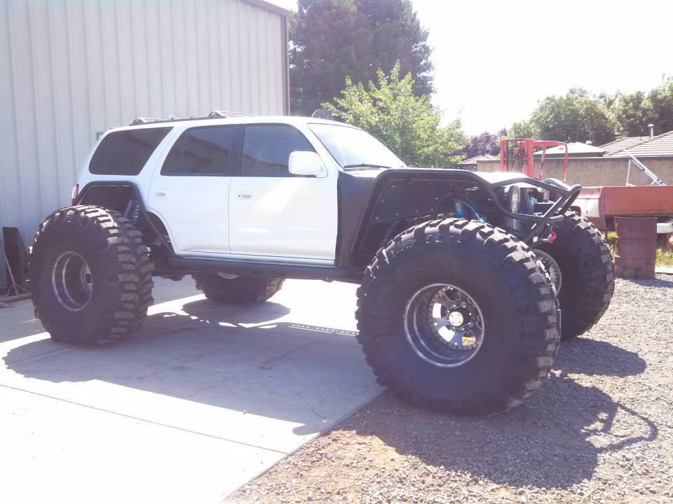

Thanks! To date, I think it is the most extreme 3rd gen 4Runner build that I have seen online. I've seen them modified, cut up, and SAS'd, but never have I seen one yet that is running full tons, custom drivetrain, custom suspension, cut up this extreme or modified like this. If I'm wrong, let me know.
This one is extreme, but has a mostly stock body.
97 4runner: LQ4 6.0L with a Z06 corvette can, headers, and custom tune. Turbo 400, 203/atlas2, 60 front with chromolly shafts and ctms, drive flanges, 70hd rear, Arbs in both, 7.17 gears, 54's on 20" stazworks double bead locks.
4link front & rear

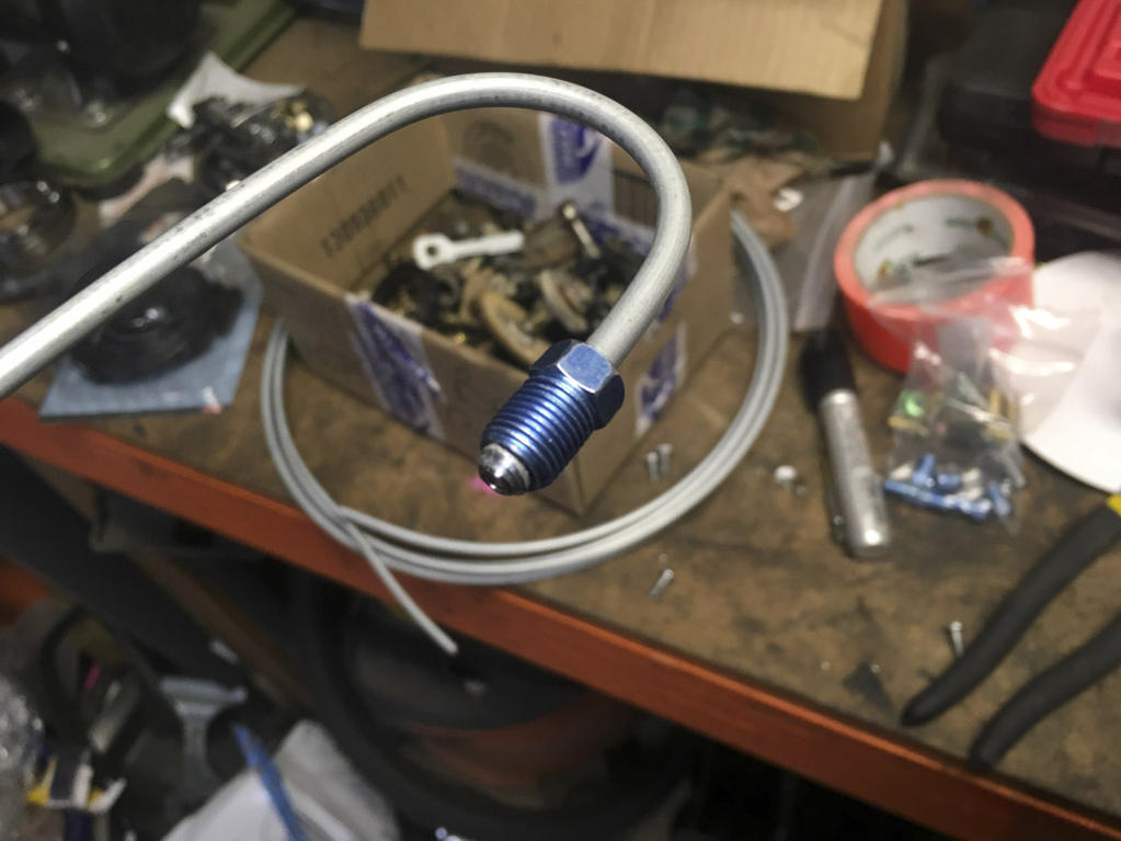

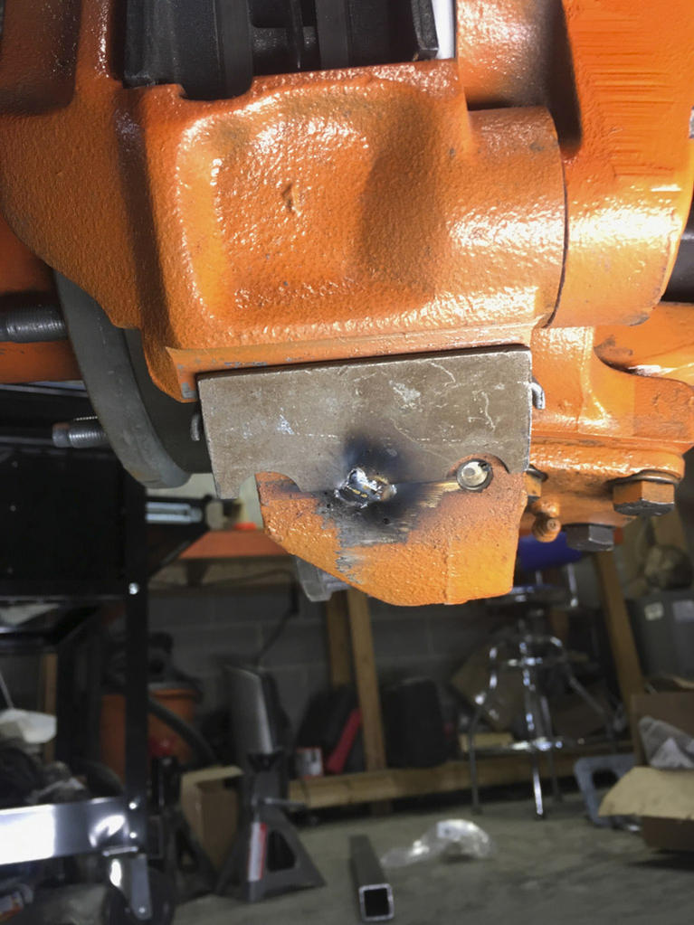

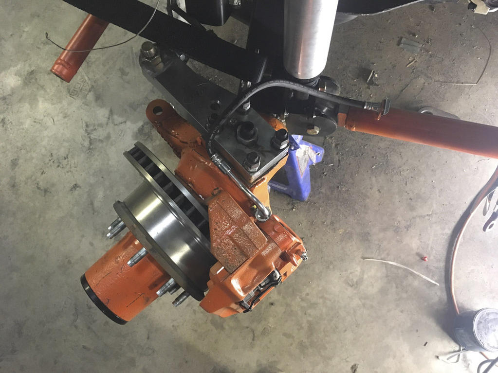

Finished up the front brakes this evening after work. Will finish the rear tomorrow because I found out one of the calipers is wrong and the banjo bolts aren't the same thread :ybrick: ....so, I need to swap it out or find the correct banjo bolt. Best to make it match the left side.
I took the day off tomorrow so I can try to catch up. Won't be long now. I want to finish brakes and fuel lines, pump, etc. tomorrow. We'll see what happens.

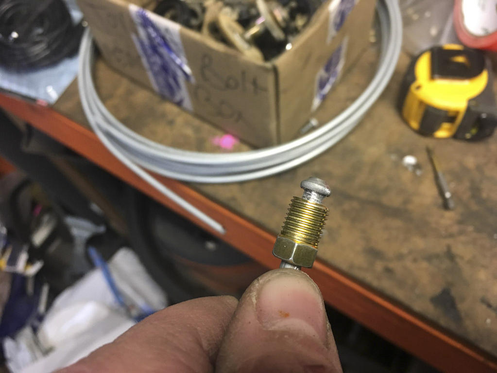

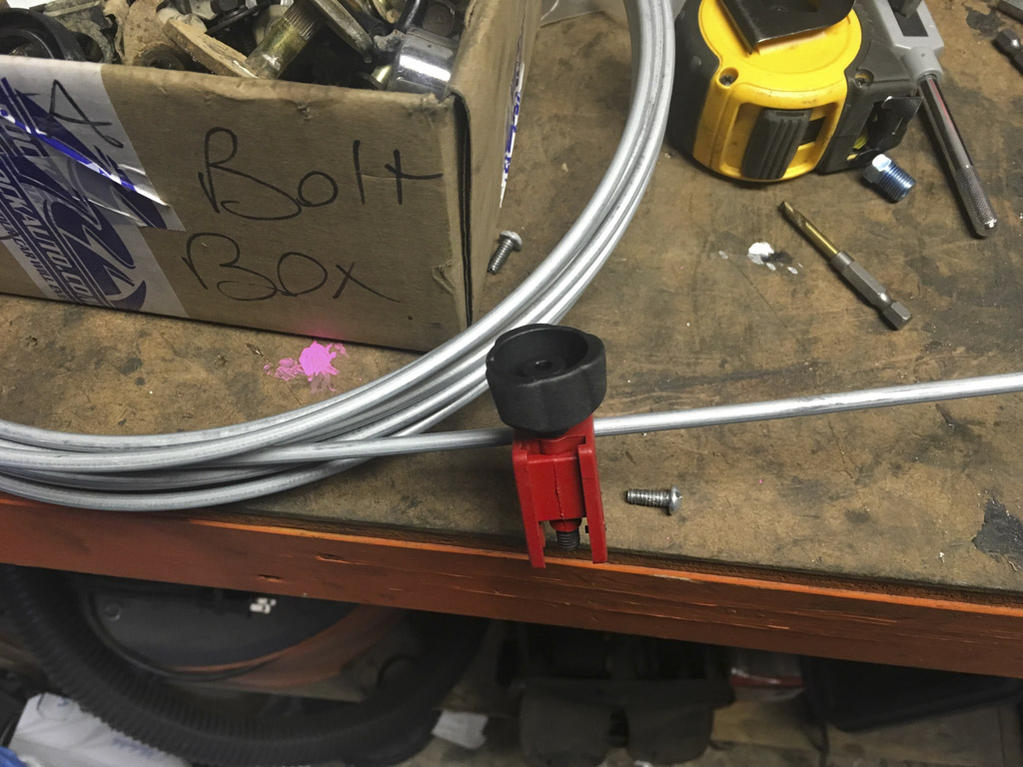

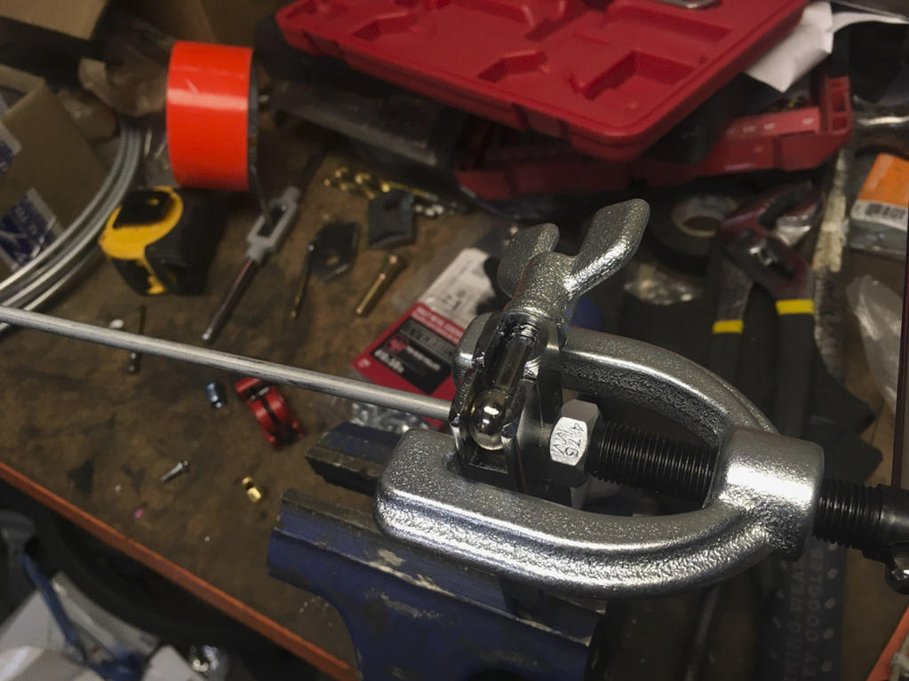

It's important when installing custom hard lines to have the correct cutting and shaping tools.

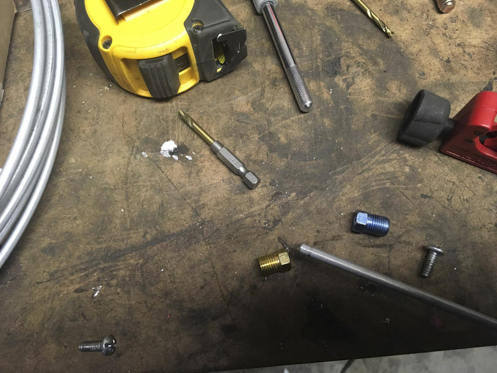

SAE 3/16 (for Ford Dana 60) is gold and the blue fitting is Metric 10mm for Suzuki / Toyota lines. Hodge podge, but that's ok as long as it works.
Flairing the hard lines.
All flared up!

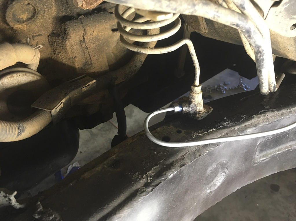

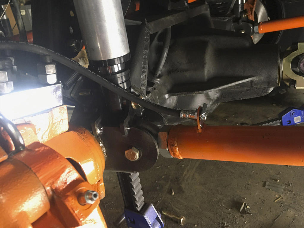

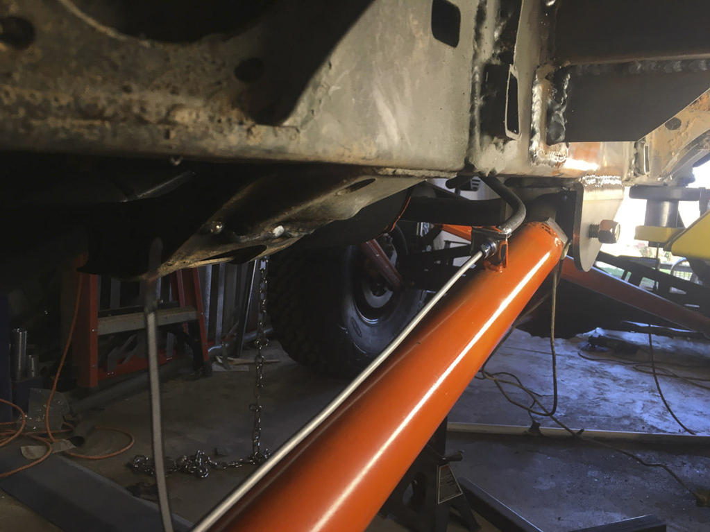

Hard lines connect the Dana 60 flex lines at the axle to the Suzuki flex lines at the frame via the link (on both sides).
To save some space and reuse the factory front brake line blocks, I curved the line to fit.
All installed and not leaking at all!
