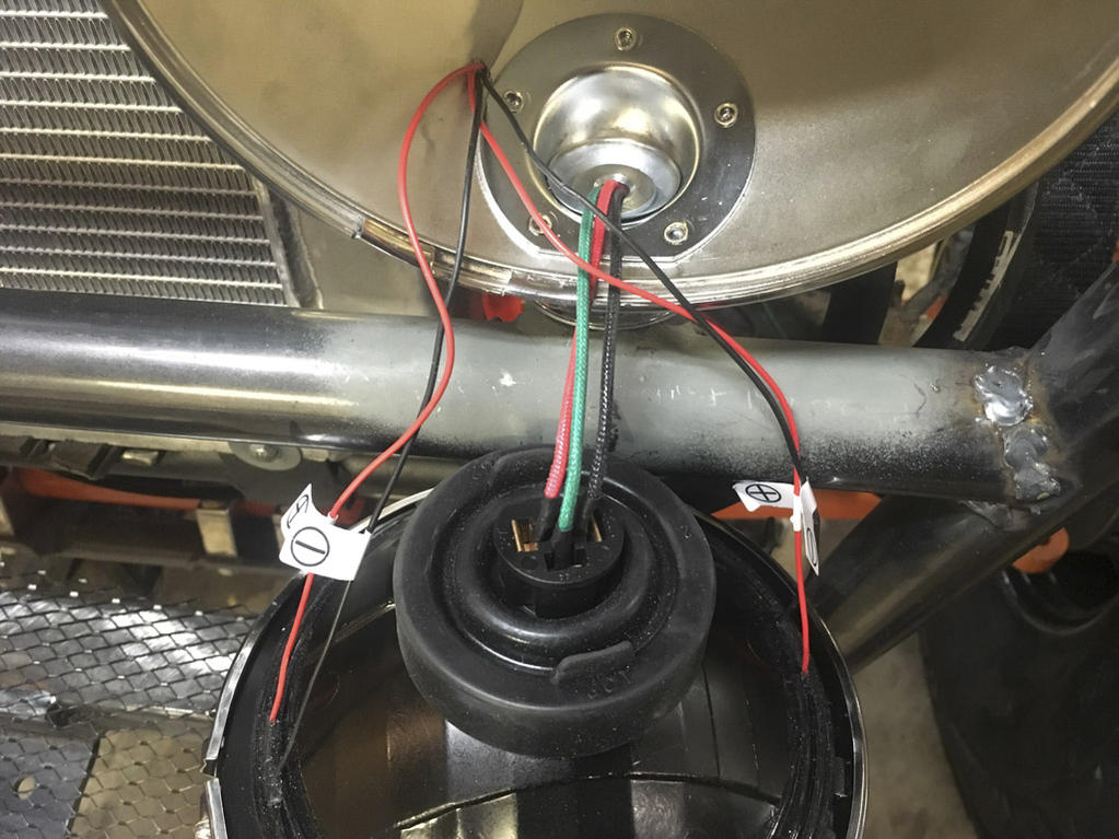

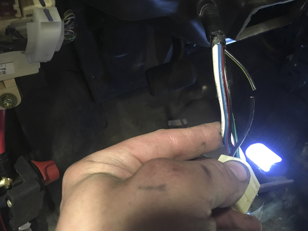

So this is pretty much ALL I got done today. Mostly because I am ANAL RETENTIVE about good wiring. I ran the wires to the fuel pump and tank sending unit. Yup, that's it! They are tucked away nice and neat. Good crimped and soldered connections, neatly heat wrapped and taped, and all properly grounded and fused!

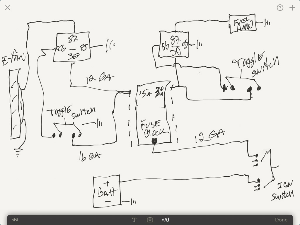

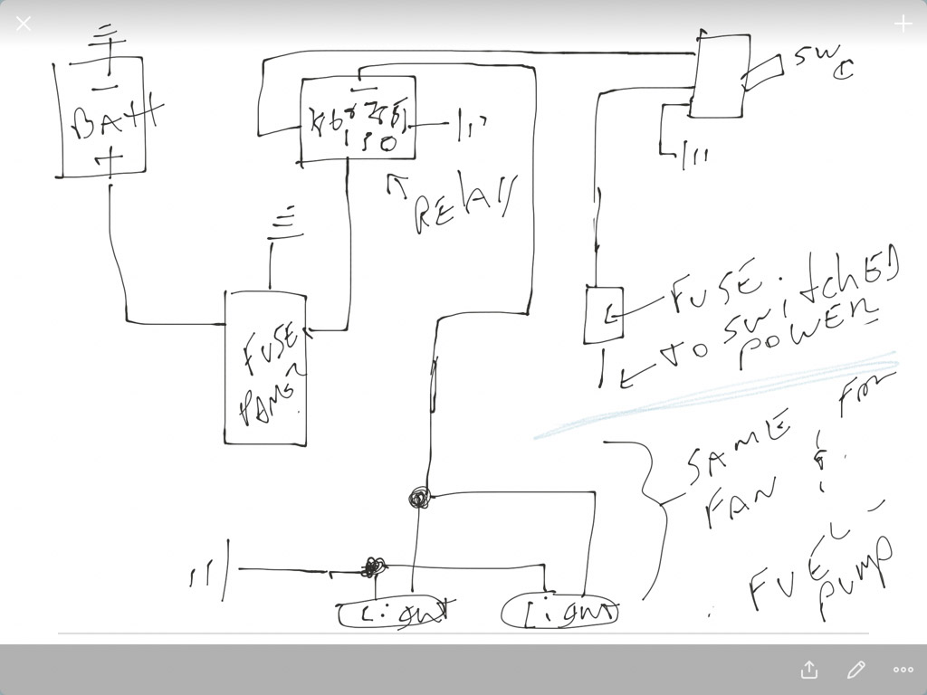

I always start with a good schematic I draw up of each circuit.
Why use a relay you ask? Well, you'd be stupid not to. You want power going to the device (Fan, Pump, Lights, etc.) not, through the switch. The relay takes the bulk of the power (using thicker gauge wires) and the switch just has enough power to flip the relay on. Keeps your stuff from heating up and catching fire! And ALWAYS go through a fuse. Inline or a block. I'm using a secondary block with blade fuses.
If you looked at the schematic I drew, you may be wondering what switched power is. Well, it's exactly what it sounds like. The power from the ignition switch. If you are wondering where that is on a 3rd gen T4R, it's the black wire with yellow stripe.

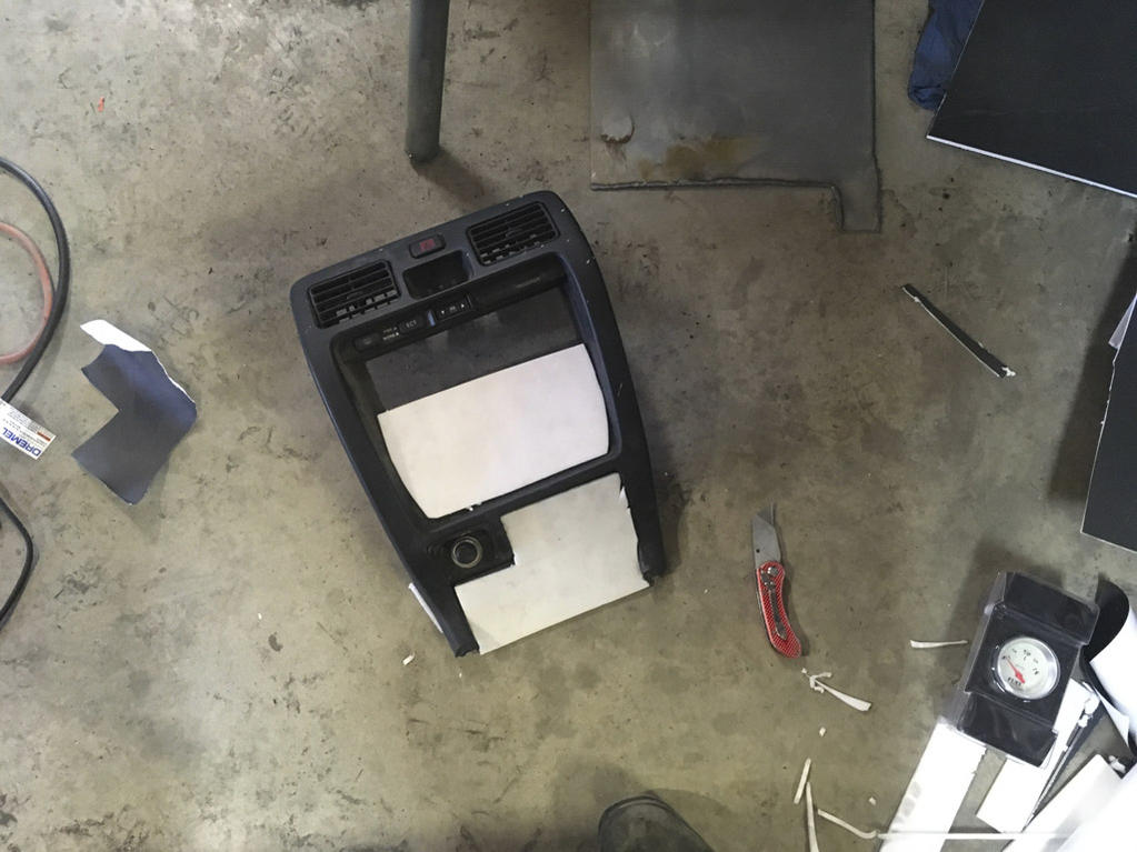

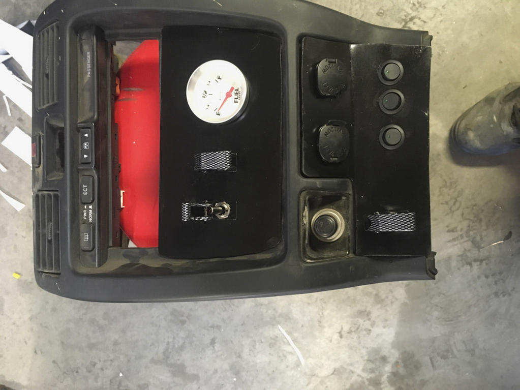

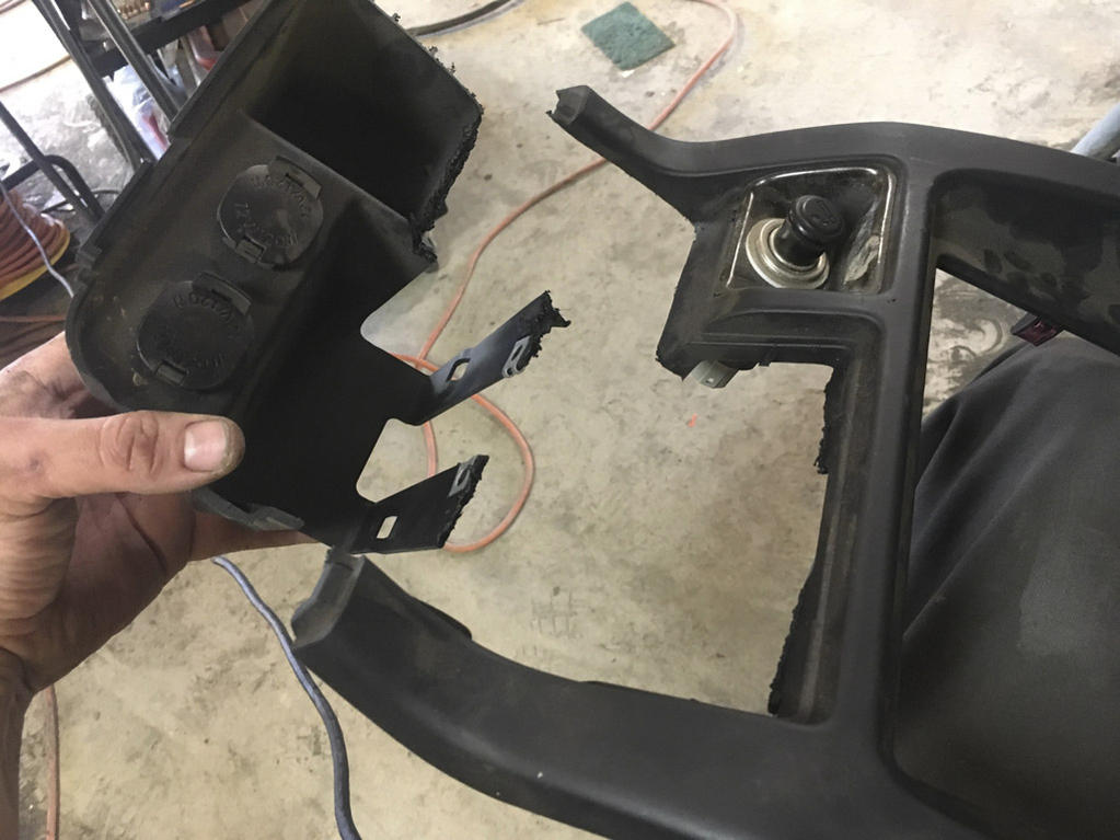

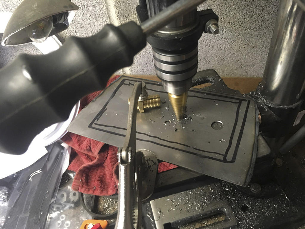

i cut out the ash tray and 12v plugs.
Made some templates using foam board.
Cut and drilled the sheet metal. 16ga.

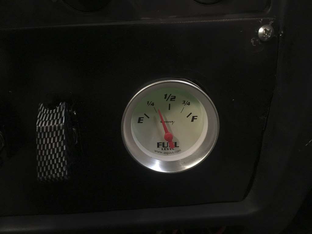

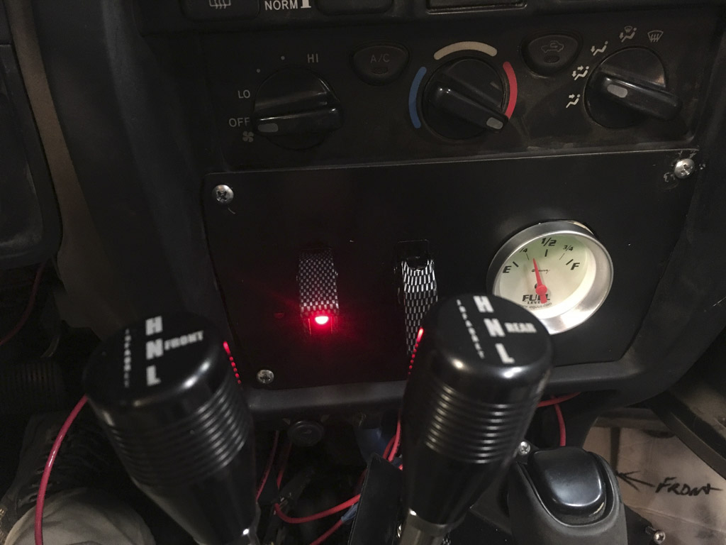

Painted them up and installed all the switches. The two switches by the fuel gauge are for the fuel pump and cooling fan. The lower carbon switch is for the rear line lock and the rest are for rock lights and light bar. Yes, I could run the fuel pump to the ignition switch, but I'd rather have a separate fused switch for safety reasons. Easier to just kill the fuel with a switch.

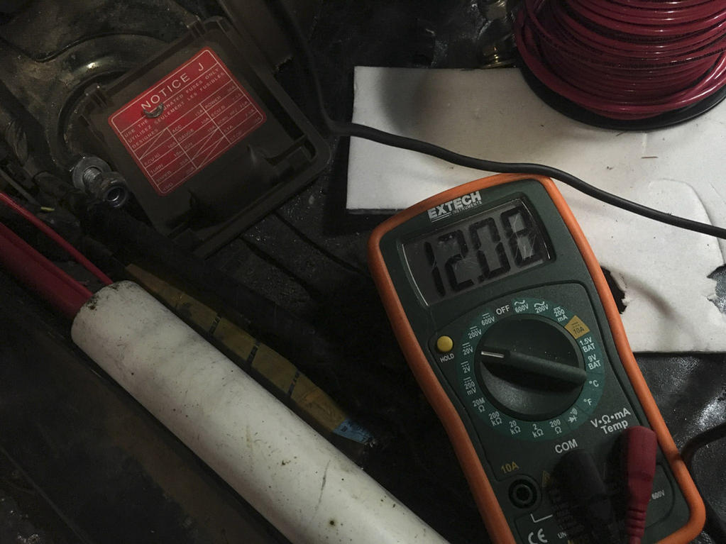

I always test each circuit after I wire it up just to make sure it works correctly. This is testing the ignition switch power lead. Good to go!

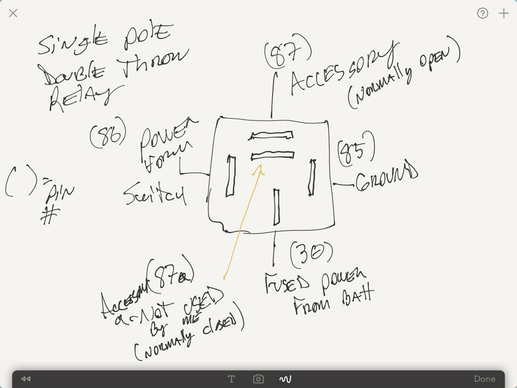

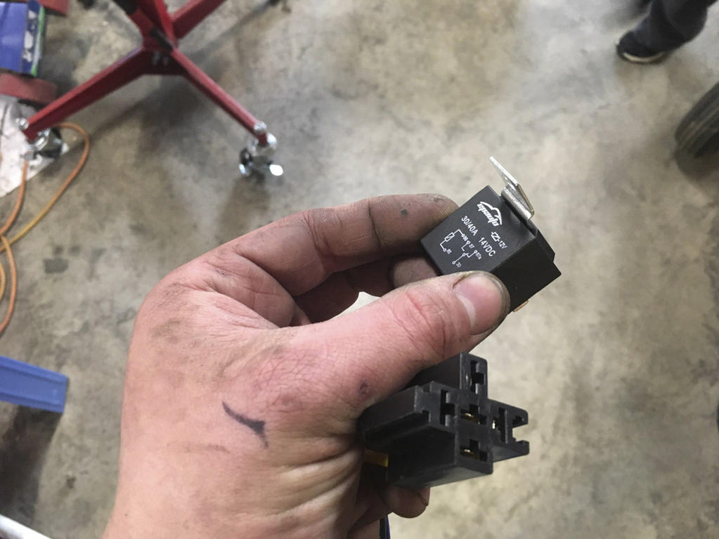

All my new circuits use a 30-40 amp rated Single Pole Double Throw (SPDT) relays. That means that two pins get accessory power when tripped. One at a time, though. One (pin 87) is normally open so only when tripped does it get power. The other (pin 87a, which I don't use) is normally closed, which means it has power all the time when the relay is not tripped. When you trip the relay 87a loses power. Most cars use a Single Pole Single Throw relay on just about every accessory circuit. Headlights, Brake Lights, Interior lights, Wipers, Fans, Fuel Pumps, etc. Anything that takes a load (measured in Amperes). The relay takes the load so the switch does not have to, preventing the switch from heating up (and potentially burning out or worse causing a FIRE!)
Here is a simple diagram of how an SPDT relay is wired up. For an SPST relay there is no
pin 87a. 4 pins instead of 5, so they are both easy to identify.

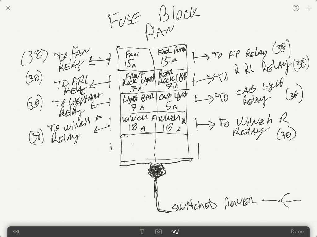

This is a diagram of two circuits running through a common fuse block. I will use 12 Gauge wire for the relay power and switched power due to amp draw and the switches only need 16 AWG wire. Well, 18 AWG. would work, but I prefer to go bigger than the math says when you are close to a threshold. Smaller the wire, the more resistance (Ohms) which means higher voltage drops. It also means the wire can become the fuse, which you don't want. That = Fire!
A detail drawing of the fuse block plan and the calculated amp fuse size for each block.
So how do you know what size fuse to use and how big wire you need for each circuit? Well, let's first look at the basic units of measure in Electricity.

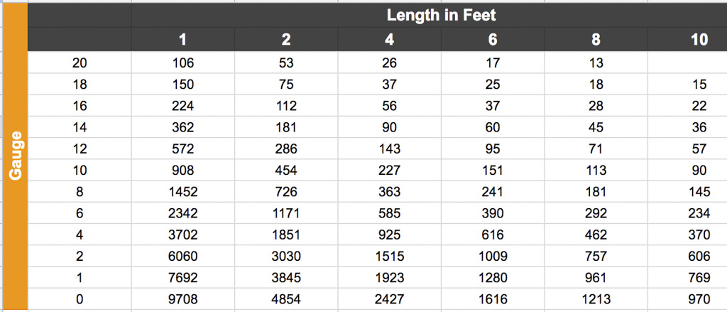

So what we are solving for is the current draw (amps) to determine which fuse size and wire size we need.
Most things like cooling fans, fuel pumps, wiper motors, etc. measure draw in amps, so it's easy to figure out. But lights are measured in watts meaning you need to do a little math. Let's take my Rock Lights as an example. They are 18 Watt lights each and since I am running 4 lights front (one circuit) and 4 out back (a separate circuit). 4 x 18 = 72 watts total power required on a single circuit. Now we solve for current using this formula. I = W/V or Current = Watts/Volts. In this case 72 Watts/12 Volts = 6 Amps. Thus I will use a 7 Amp fuse for that circuit. Can you use a 10 amp fuse? Sure, but remember, you want the fuse to be the weakest link in the circuit. Safe and easy to replace should you get a spike or short and blow one. With the bigger fuse you make the wire or device it's powering the fuse in the system and we've already said what that can lead to.... Yup FIRE!
What about wire size? Easy, the fastest rule of thumb is use 16AWG to 12 AWG wire for most things. But depending on the distance the power must travel over the wire it will have a voltage drop due to resistance. The larger the wire is the less resistance will be met. Here's a chart I got somewhere that gives you the Amps per Gauge and length of wire. So look at the chart with our data. I need a 14-18 foot run of wire to go to the lights out back. I'm drawing only 6 amps, so you can see that 10 feet 18 AWG will take 15 amps, but remember I'm going a lot farther so we get down to about 6 to 7 amps. So yes, I can run 18AWG but 16 AWG would be safer. Make sense?

First, love the thread! So far, I haven't had a reason to post, just lurk and enjoy.
Couple of comments:
- Running the same amount of current through a longer wire doesn't increase the chance of fire, it just wastes power (and may make it so enough power doesn't get to the load). The larger amount of power dissipated in the wire is spread over a longer wire, so each unit of length heats up the same whether it is 1 foot or 100 feet. Otherwise, good info on wire sizing.
- Running a fuse anywhere near its rated load will wear out the fuse with time. You are turning it into a very dim light bulb that will oxidize more quickly than a larger but still safely sized fuse. Set the fuse size to be less than what the rest of the components in the circuit can handle, but with a decent overhead above the normal operation of the circuit - 50%-100% higher, generally. A 10A fuse is probably the right choice for that 6A load. Fusing Guide | 12 Volt Planet
- You'll want to calculate all your (resistive) load currents at 14.5V to make sure you don't undersize any wiring component - also an issue with that 7A fuse on a '6A' load for 12V which then becomes a 7.25A load at 14.5V...

Whoops! Forgot about the 14.5v bit. Good catch Charlie, thanks! All my math is off now! The wire size is still good, but I need bigger fuses all around.

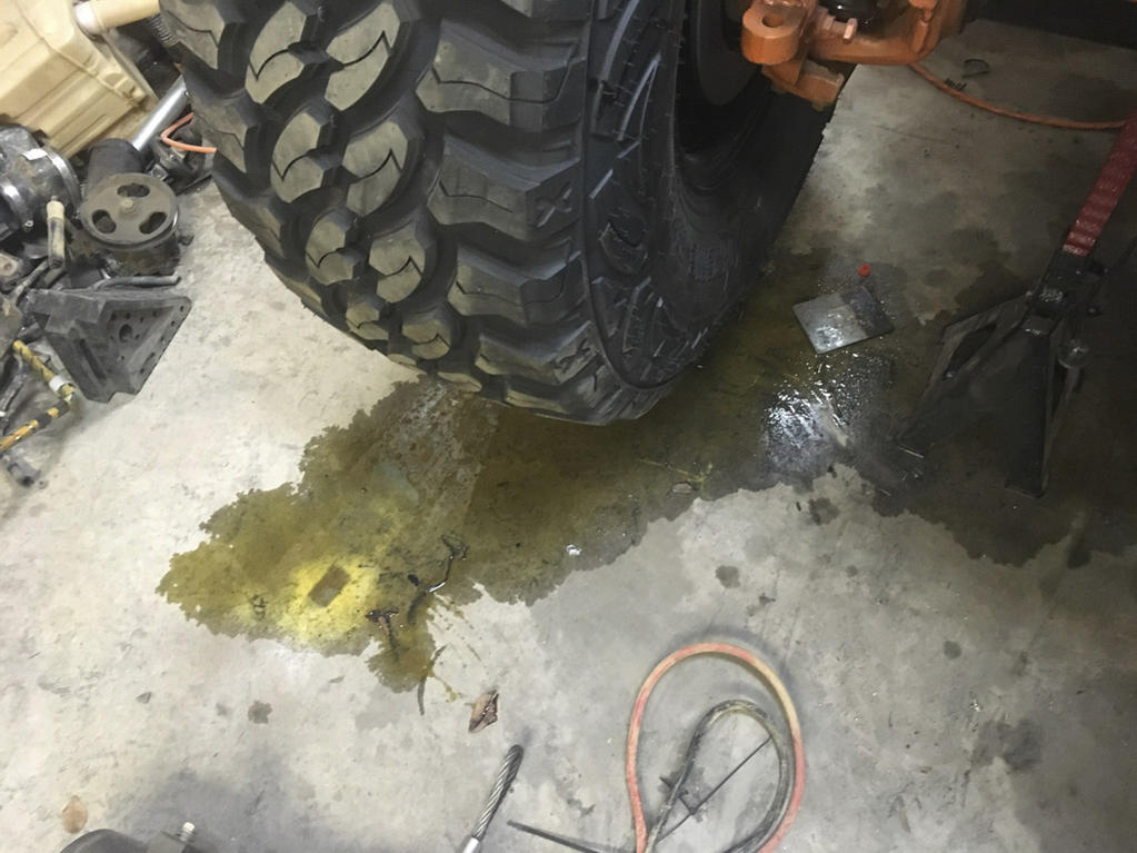

I guess putting gear oil in a not quite level (it's sitting on jack stands so I could test drivetrain) axle is one way to figure out that the inner axle tube seal is bad, very bad. If it's even in there, to begin with. :frusty: Maaaaaan, this SUCKS!

Oh no!!

That sucks! How far behind does this put you do you suppose?
