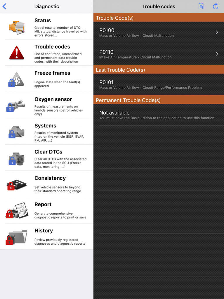

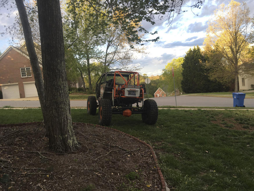

It left the shop this afternoon to do a dry run up my street to test brakes, engine performance, etc. First time in over six months! I actually got dirt on the tires (from my lawn, unfortunately, damn locked axles!) Felt great, until.... I noticed a very nasty issue with the engine. It would not rev above 3,000 RPM (Limp mode) and tranny would not shift. Grrrr. So I stuck my OBD II thingy on it and checked the codes. Duh, Brent! I forgot to put the MAF Sensor back on. So I cleared the codes, reset the ECU, and installed the MAF sensor. Bam! Runs like a top now. One more test run tomorrow to tweak brakes and test engine again, then into the shop for finish welding, seat installations, harness installations, maybe some paint and few more little things. Saturday, more tweaking and finish work, then SUNDAY (weather and time permitting), I hope to get it to the offroad park for a shakedown run and some fine tuning.
