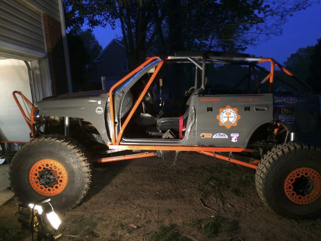

Rare image of [MENTION=103068]NotKewl[/MENTION] doing his test run

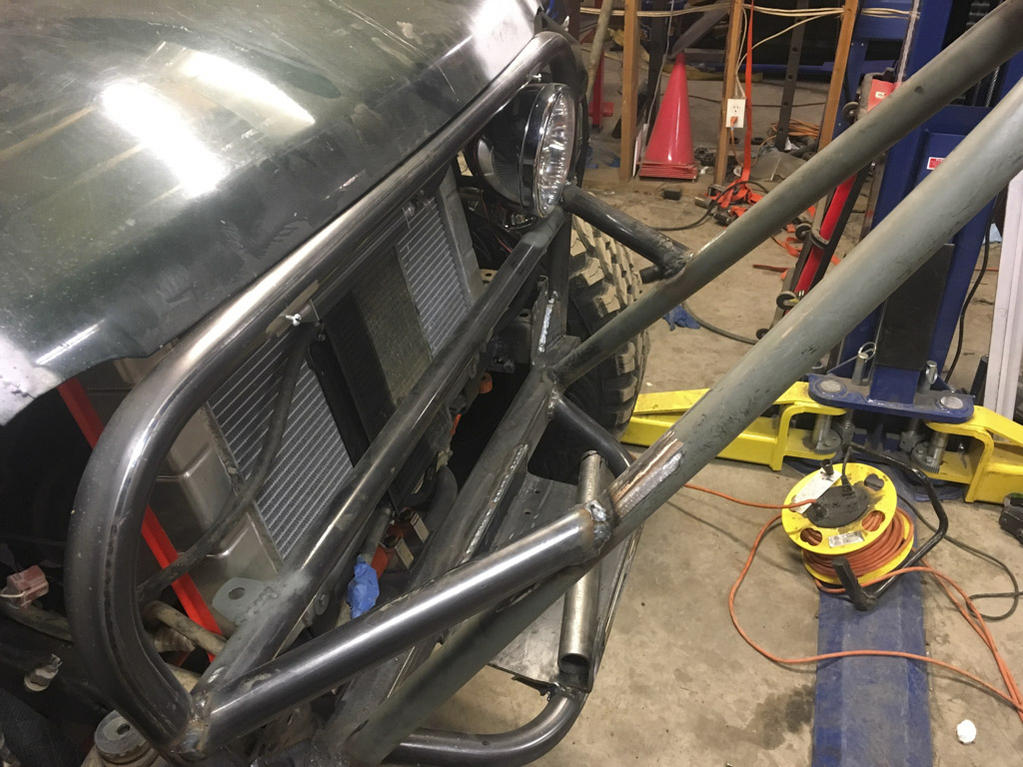

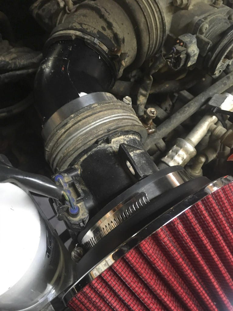

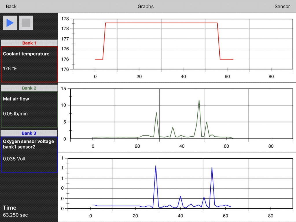

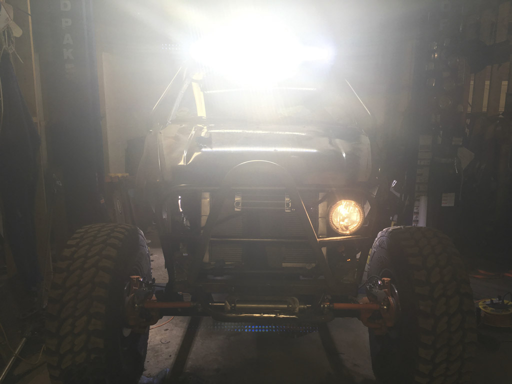

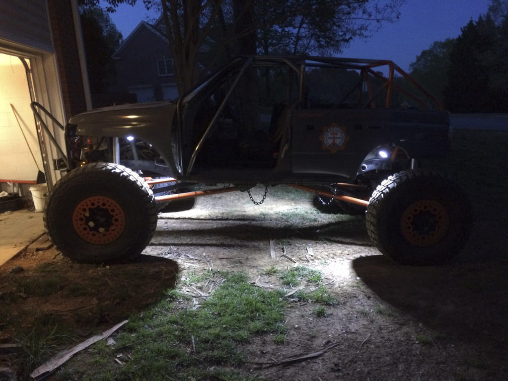

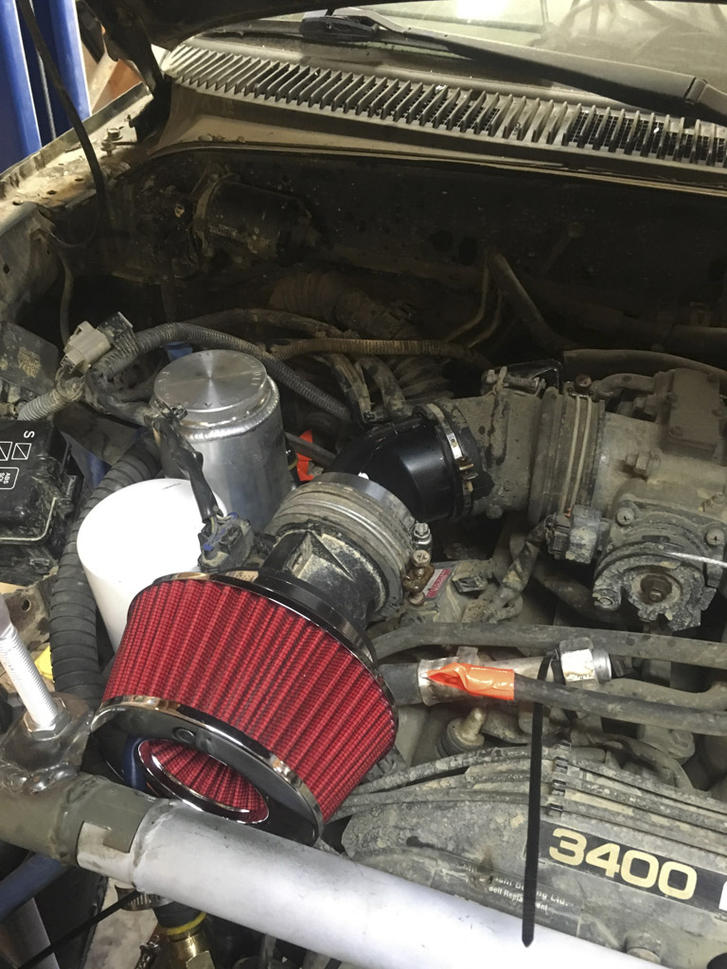

Finished ALL the finish welding today on what structure is in place. Built a custom made intake by cutting down the original rubber tubing, attaching it to some PVC pipe. I cut out the MAF sensor from the airbox and installed it inline with the intake. Works like a charm! Also managed to get the front rock lights installed and working! :rockon:
Ran the truck and tested all the sensors. Working great!

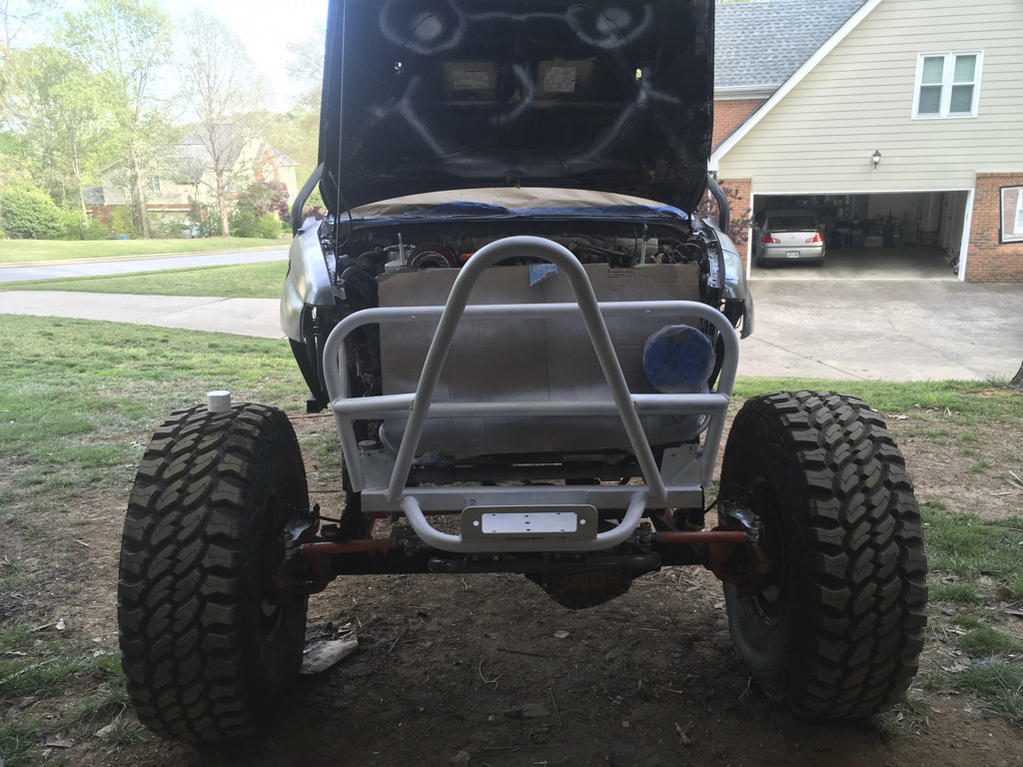

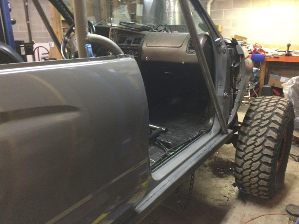

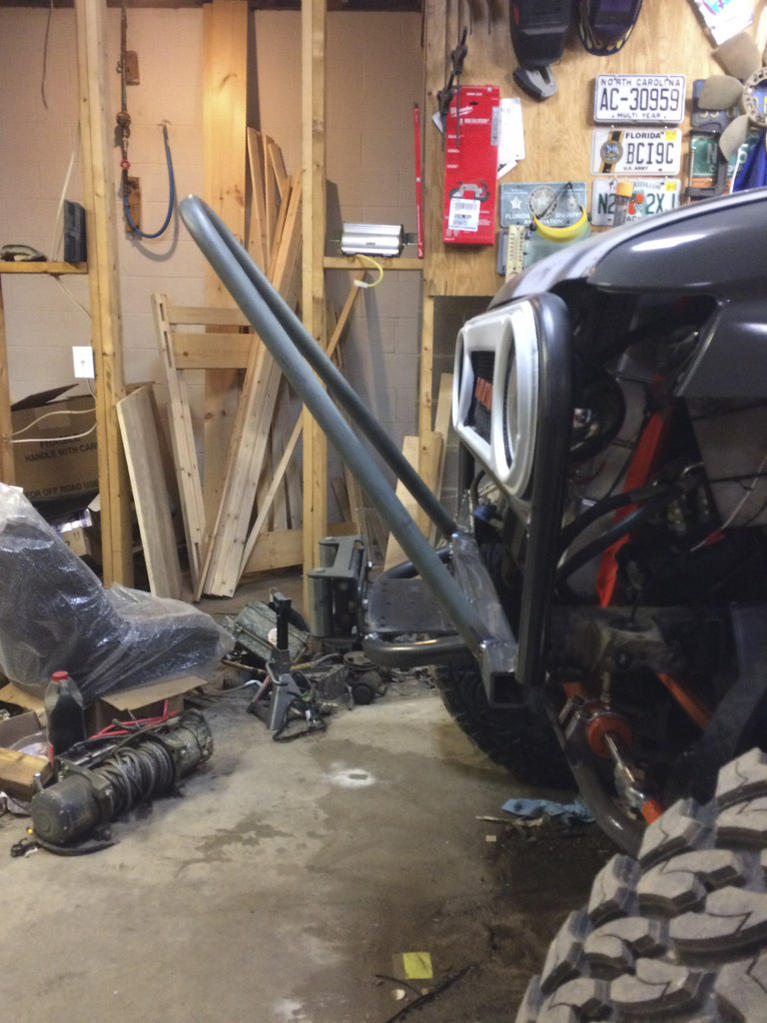

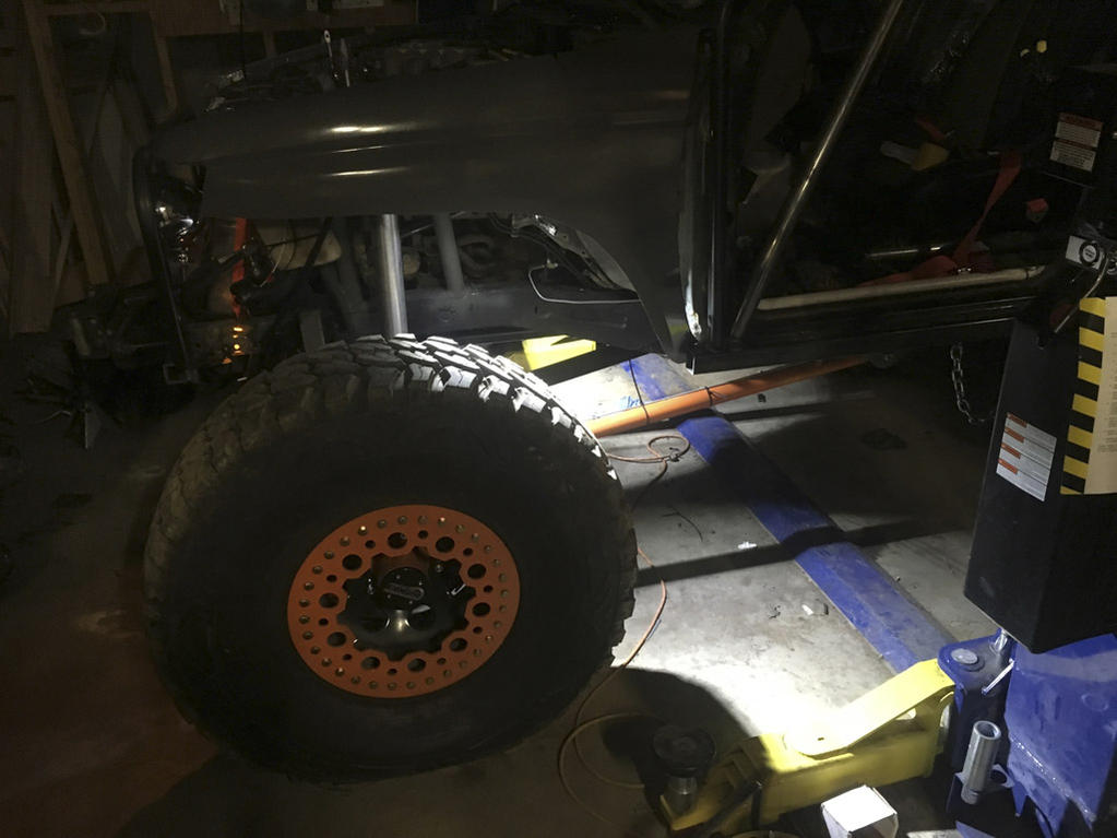

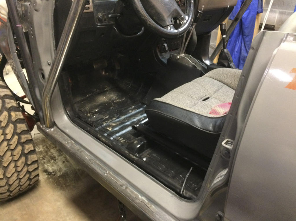

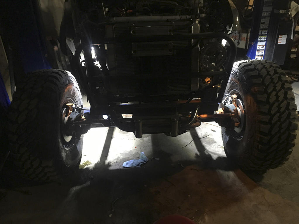

Started building stinger, cleaned out interior and sprayed in some bed liner for durability. Tested rock lights outside, and gave it a much-needed front-end alignment.

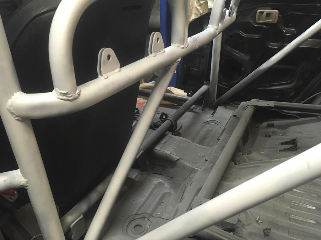

Didn't have a whole lot of time today, but I did get a few things done. Finished the stinger, added more to the cage including the light bar mount, wired the light bar up, and prepped for more paint.

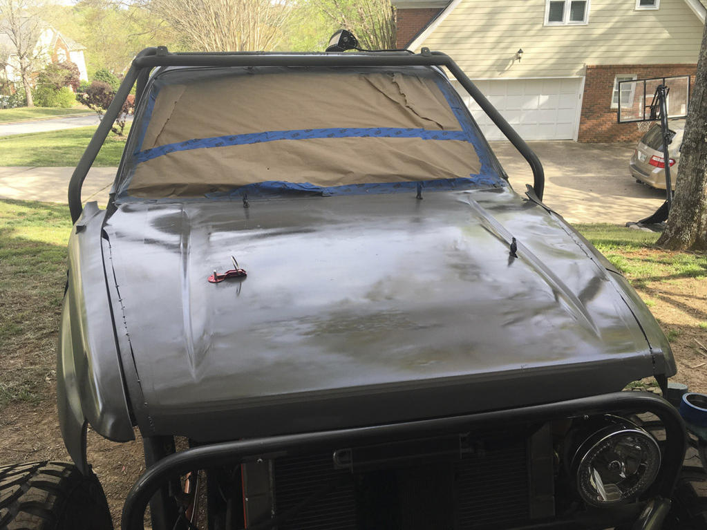

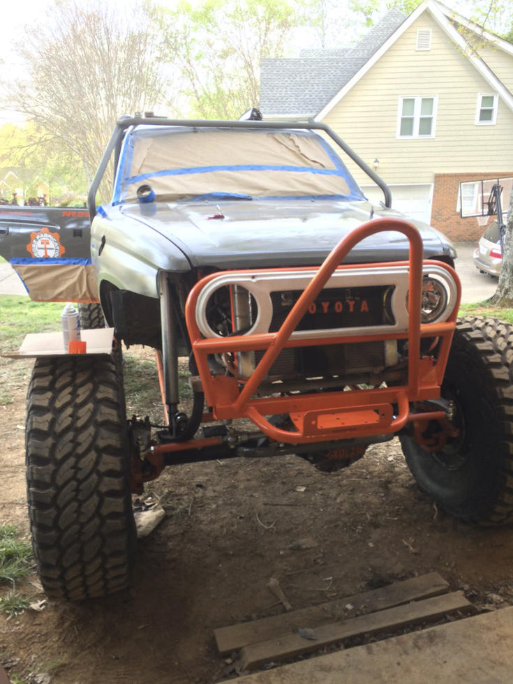

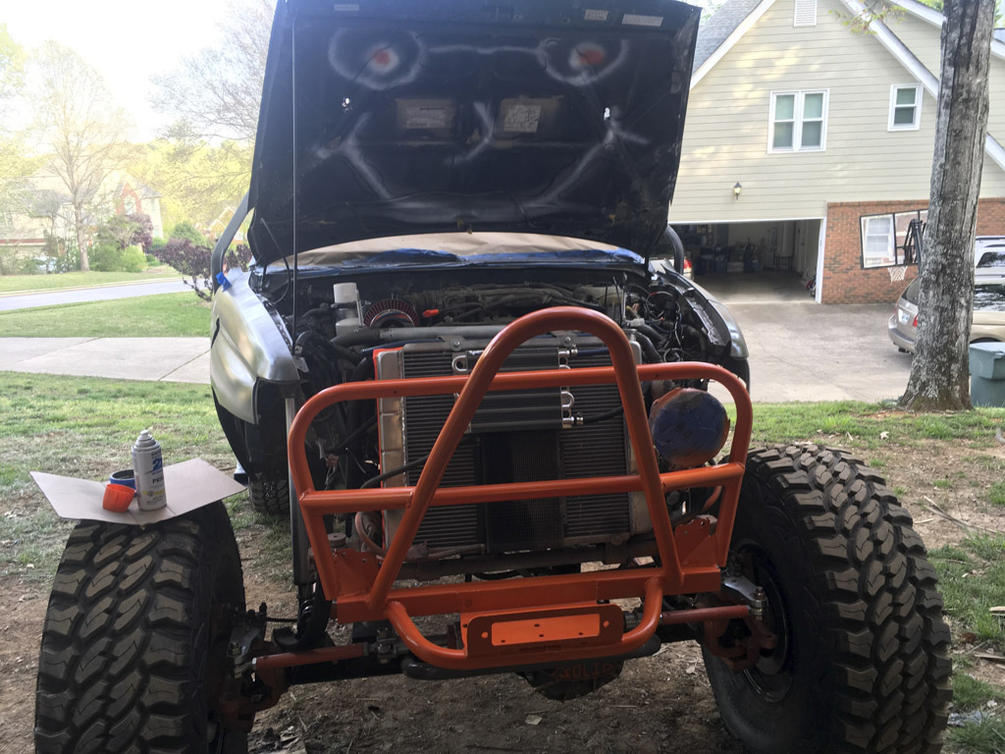

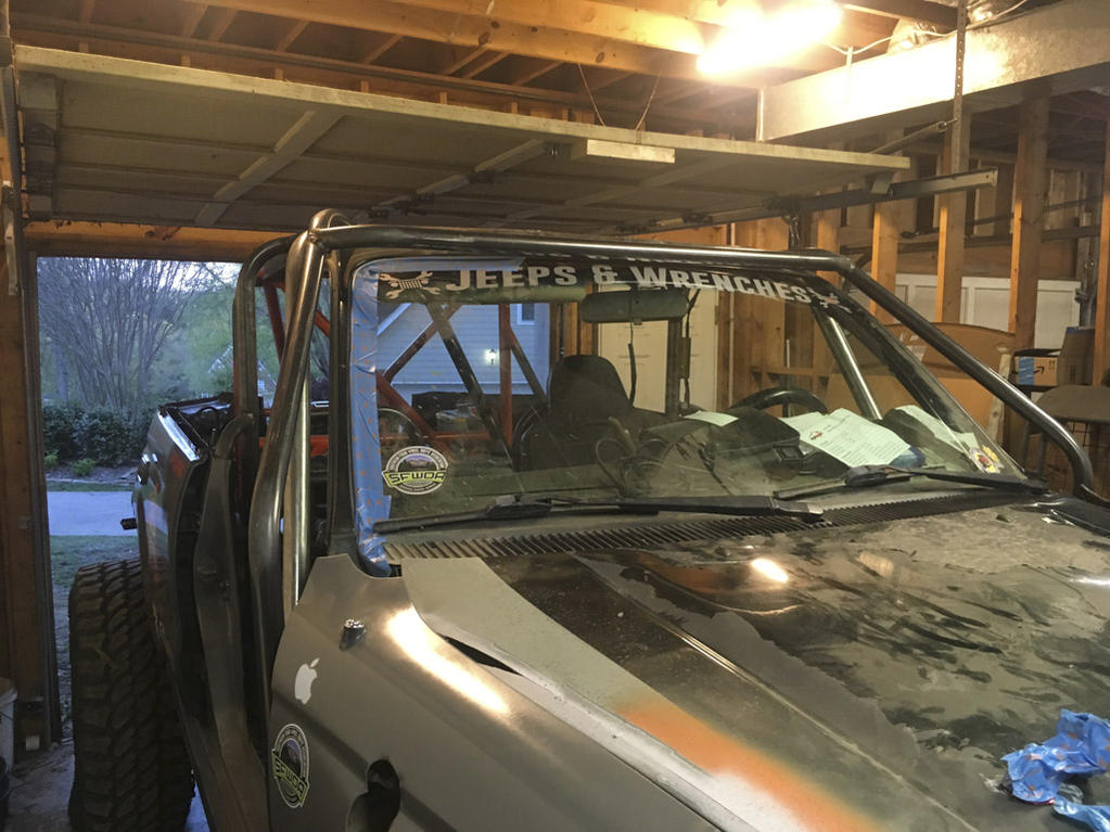

Since I'm basically ready for trail fest, minus the seats and harnesses (that's coming up this week) and ahead of schedule, I decided that after work today I was going to do nothing but PAINT! Yeah, yeah, I know, the hood looks like crap! well, that's because I'm not done with any of the body work. The fenders are screwed on with sheet metal screws, the sheet metal out back hasn't been finished either. And the hood still has holes and gaps in it. That will come after trail fest because I just don't have time to do it. I still painted everything because it looks a lot nicer and I'm anal about having consistency. I'll finish all the body work shaping and REAL paint after trail fest. For now, rattle cans will do nicely. It's a trailered trail rig, so perfection is not really an option seeing as it will eventually end up on its lid at some point. :naughty:
Hood all painted. Always etch the raw metal first!
White primer. Makes the Orange top coat show up better and without as many coats.
Then add paint!

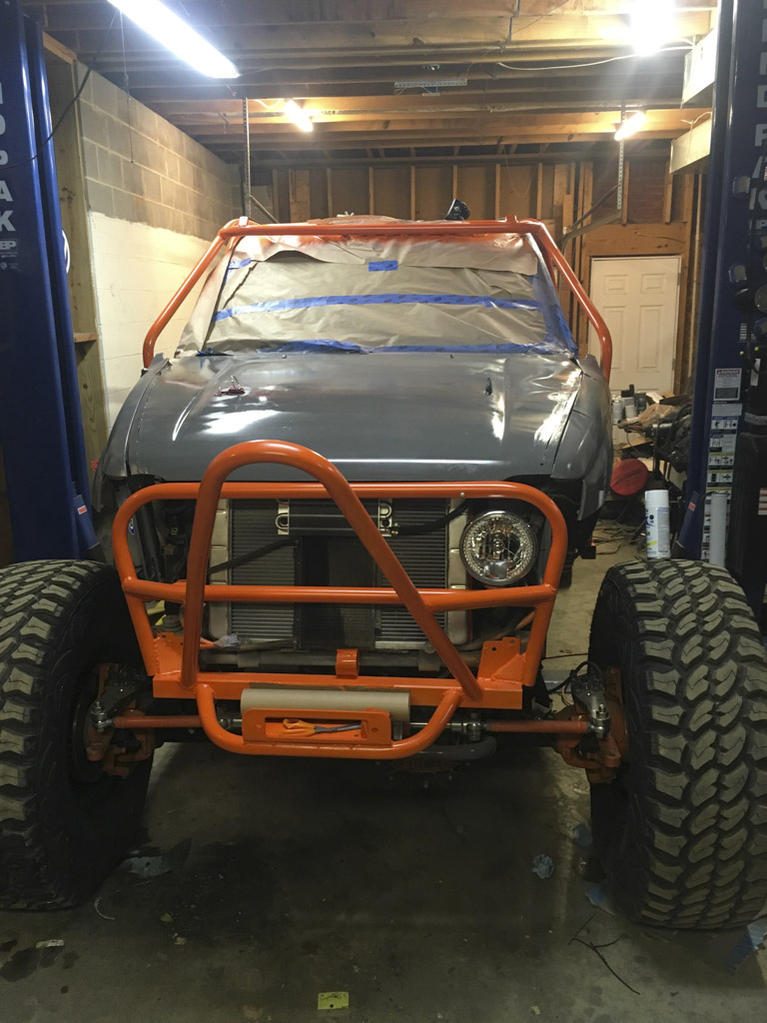

Lookin like One-Eyed Willy!!
latest
But seriously, good progress. It's really starting to come together.

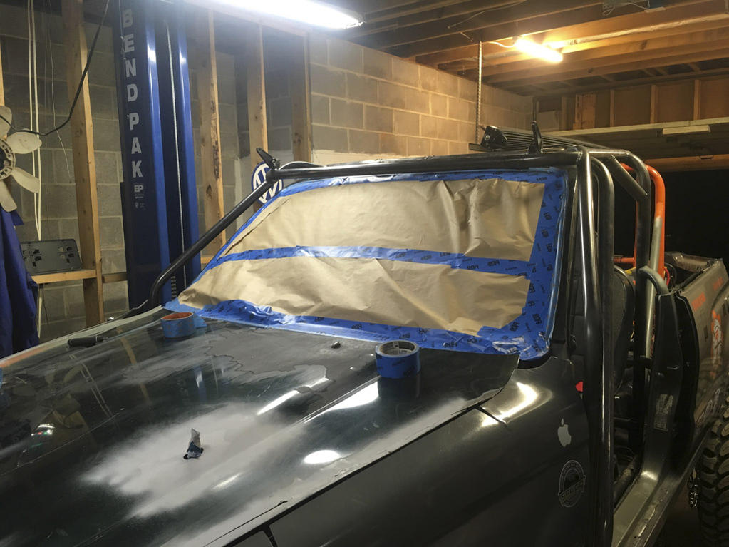

Yeah, here's why it was one eyed willy. (good movie BTW). I put the headlight on and wired it in before painting and before installing the steering. Which means to take it off I had to disconnect the steering orbital which gets fluid everywhere and means I'd have to bleed the system again. Sooooo, Masking tape!!!! :lmao:

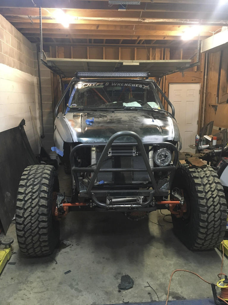

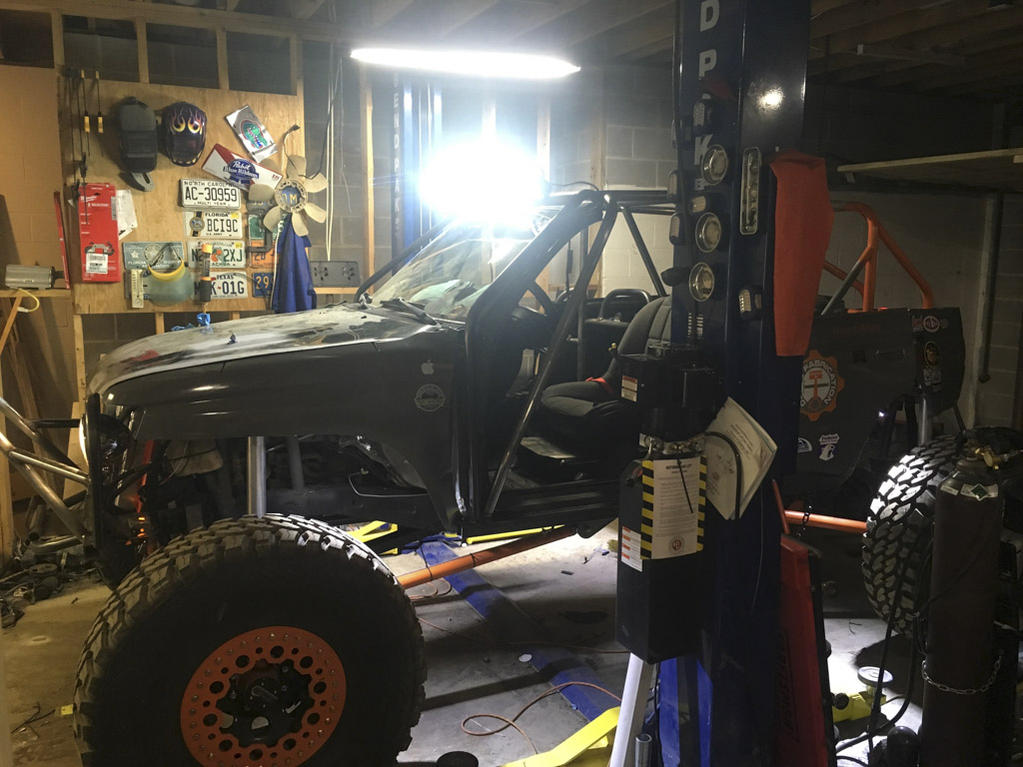

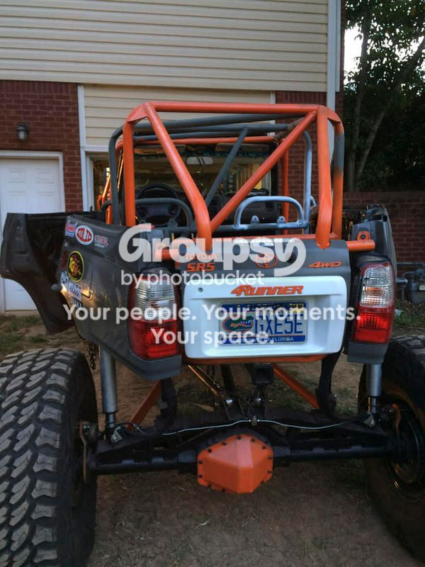

More welding and painting this afternoon. That's about it. Only had about four hours after work to do stuff.

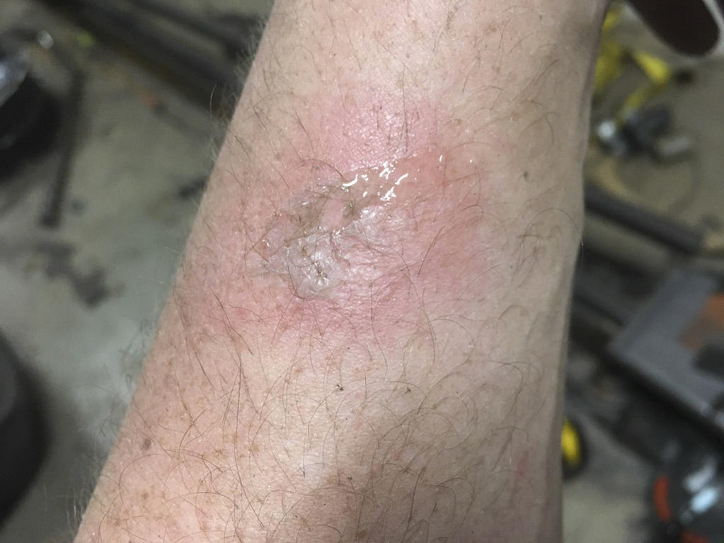

Managed to touch the spot I previously welded (like a dumb ass) and gave myself a nasty 3rd-degree burn. No worries, beer will fix it! :bravo:

Rub lavender oil on your burn. I first thought it was nonsense then I singed myself on the wood stove and put some on. There was no pain whatsoever and it healed up cleanly, I was amazed. Use it anytime I burn myself now.
Thanks. I'll try some.

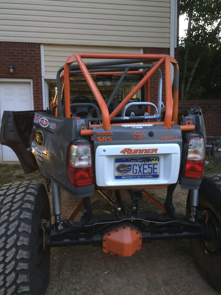

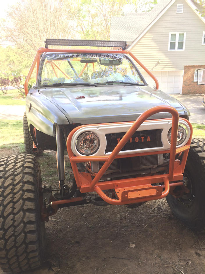

I'm not sure this qualifies as an SR5 anymore.
Lol yup! That's why it's funny to be on there. To bad I put the Toyota script and SR5 in the opposite places where they come from the factory. Whoops! Oh well, it is custom after all. :biggrin2:
