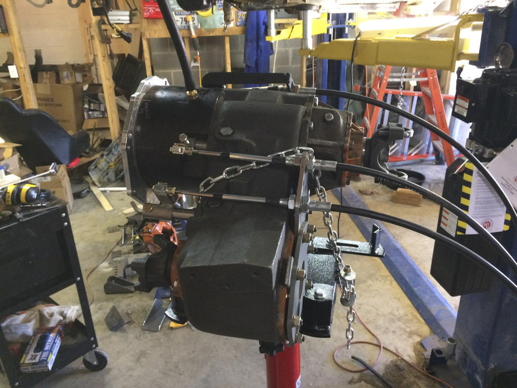

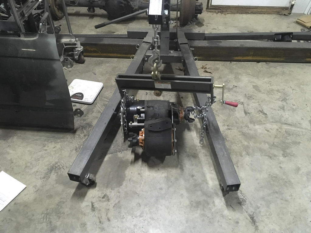

I didn't get much done today, unfortunately. I had some housework to do for the wife (because you need a happy wife to keep wrenching like this) and helped the kids with some projects for school. However, I did manage to get to Northwest Tool to pick up a high-rise transmission jack. I decided that yesterday was a PITA and having the right tool for the job is too important. Now I don't need two buddies and a crane with holes cut in the tunnel to reinstall the transfer case.

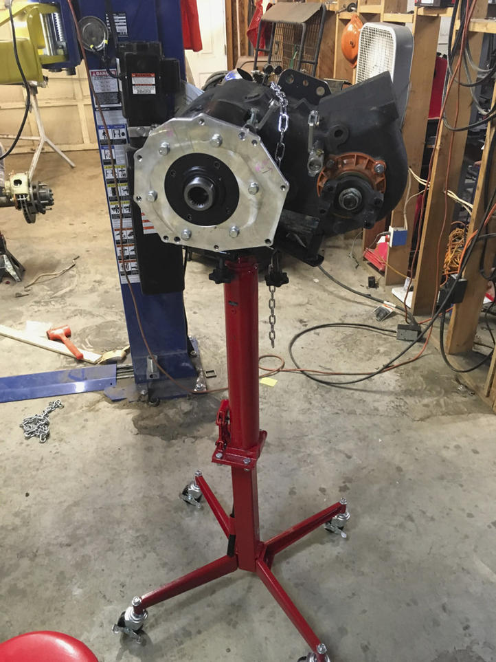

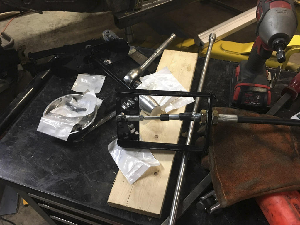

I need to fab up something to fix the shift mount for the Blackbox. Not sure why Northwest fab sent me one that doesn't fit my NP205 setup. Maybe this is an oddball 205? Dunno. Either way, I'll need to make or modify the bracket to get it to work properly. The shifter linkages and cables all need to be installed before the transfer case goes in for good. There simply is no room in the tunnel to do it once the case is installed.

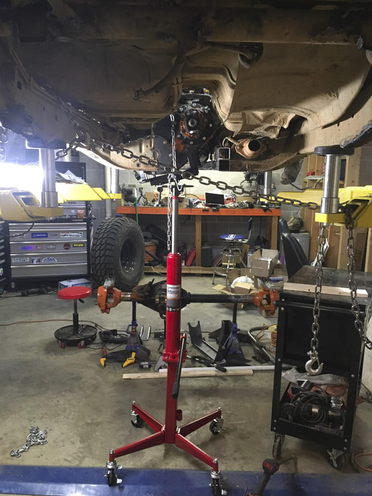

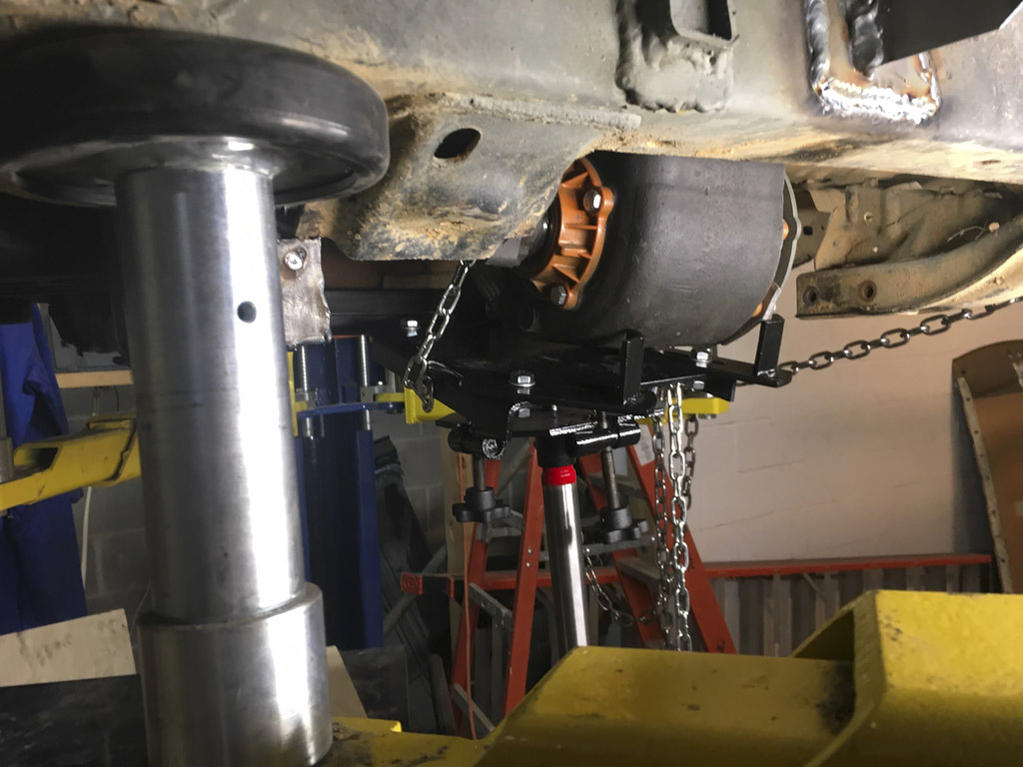

Even getting the transfer case on and off this high jack is a feat in and of itself.

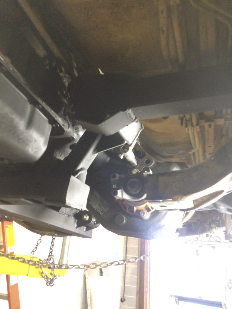

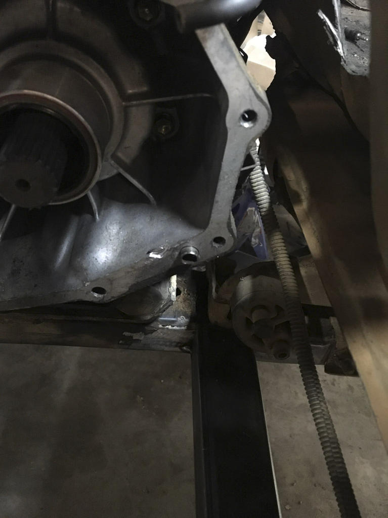

This bracket is supposed to mount to the Blackbox, but the 205 is kinda in the way where the bracket doesn't line up. Northwest Fab's instructions are crap, disjointed information, and incomplete. So screw it, I'll make something myself.

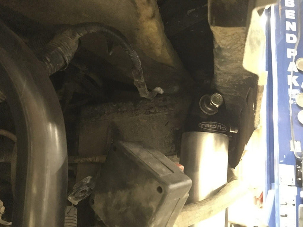

Look close and you can see where the bolt on the adapter was interfering with the transmission bell housing. I will need to clearance the housing to make room for the bolt.

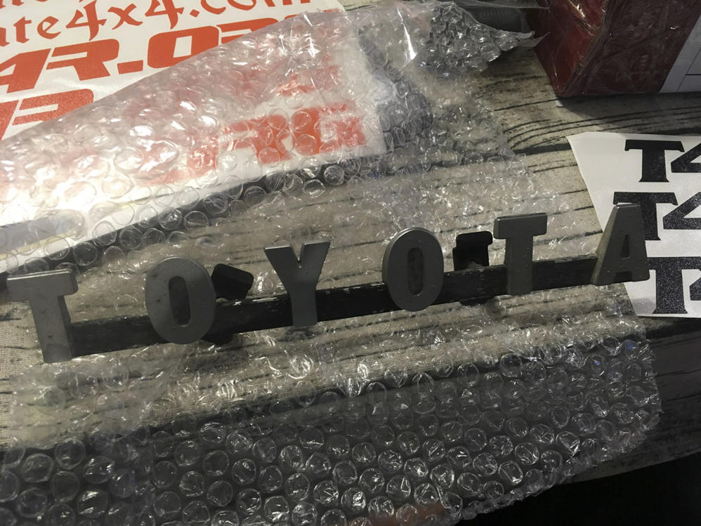

Tis the season for sickness I guess. Been home with a sick kid so haven't gotten any more work done. I did get some goodies, though. I ordered an authentic TOYOTA grille script emblem off eBay for an old FJ40 to go with my FJ40 grille. I'll need to do a little restoration work on the grille and script.

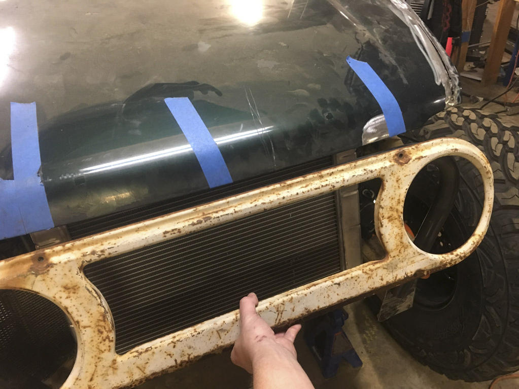

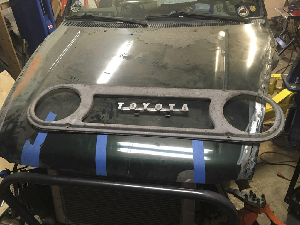

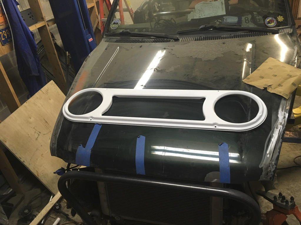

Grille gets a shot... of paint that is!
The FJ40 grille I got off eBay is off of a late 70's (76 I think) model so it was a bit rusty and dented. I stuck it in the blast cabinet to strip the old paint and hopefully remove most of the rust but alas, some parts were too pitted. To restore it completely (had it been a restoration or show car) I would have filled the pits, holes, and such with the welder, hammered out all the dents, then applied a special filler compound to smooth everything out. However, since this isn't a resto of an FJ but rather a usable hardcore crawler, I don't really care about the "Patina." In fact, I think the dents and pits give is a rustic character. One that fits the persona of this project.
Sandblasted first with a little remedial hand sanding.
A shot of self-etching primer from Rust-oleum.
A few coats of semi-gloss white for the perfect look. The Toyota script will match the bodywork in either Gray, or most likely Orange!

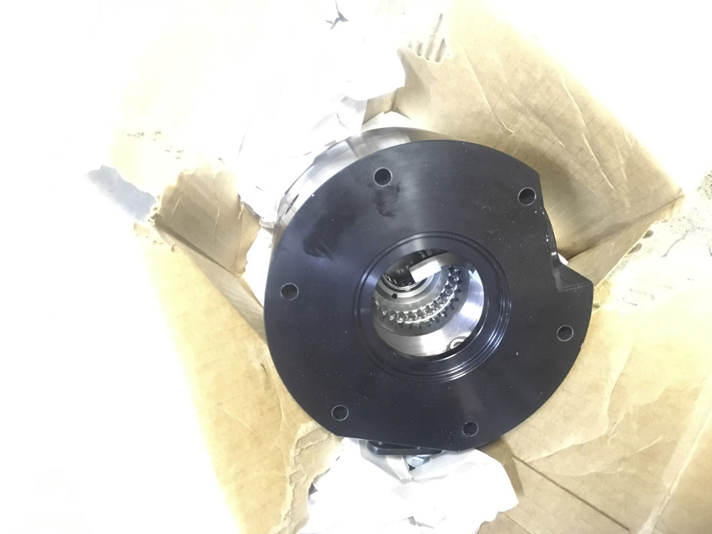

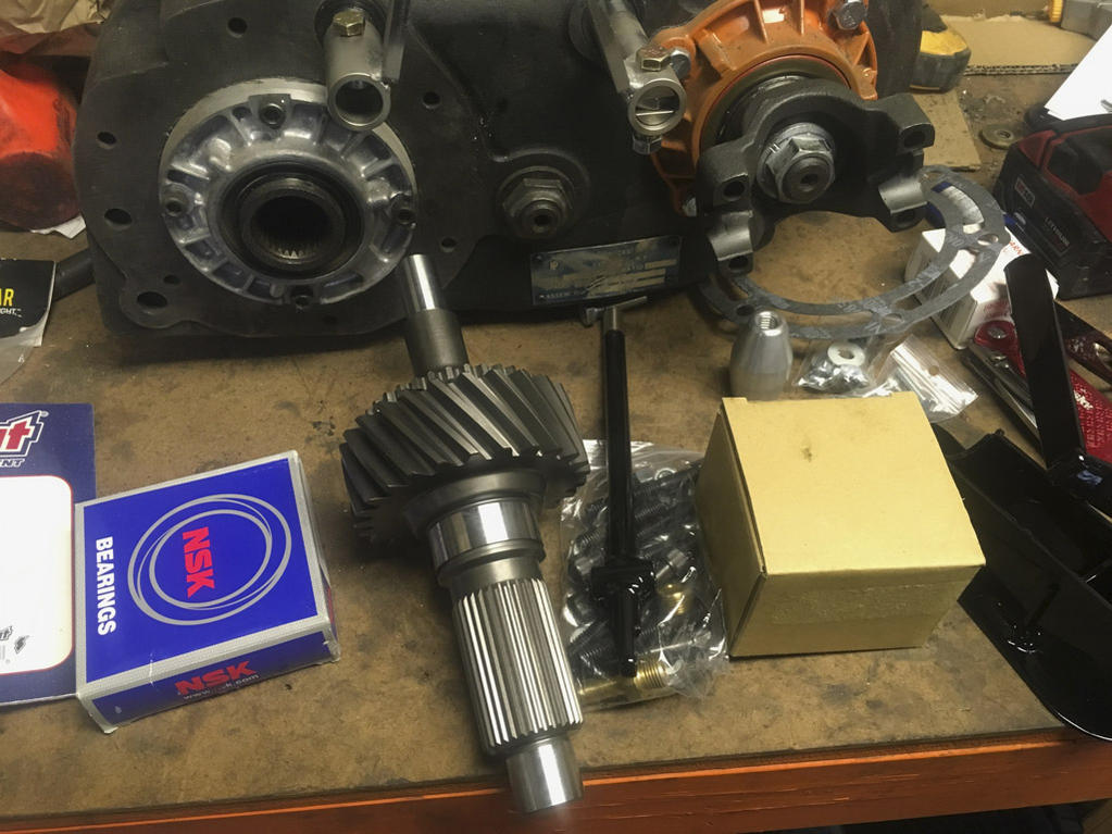

My Blackbox Titan showed up today! Along with a crap ton of other things I've ordered in the last few days. Northwest Fab take forever and a day to ship anything, but it finally arrived! The Black Box was ordered way before Christmas and it just now shows up. The rest of the stuff was ordered two days ago from Summit, Rockauto.com, and Ebay and BAM! at my door two days later! NWF could learn a thing or two from Summit et al. I love it when I get home from work and there are a bunch of boxes waiting for me!
My new Blackbox underdrive from Northwest Fab in :canada:
The rest of the kit that came with the BB. Need to install the new beefy input shaft into the NP205 tomorrow to install the BB.

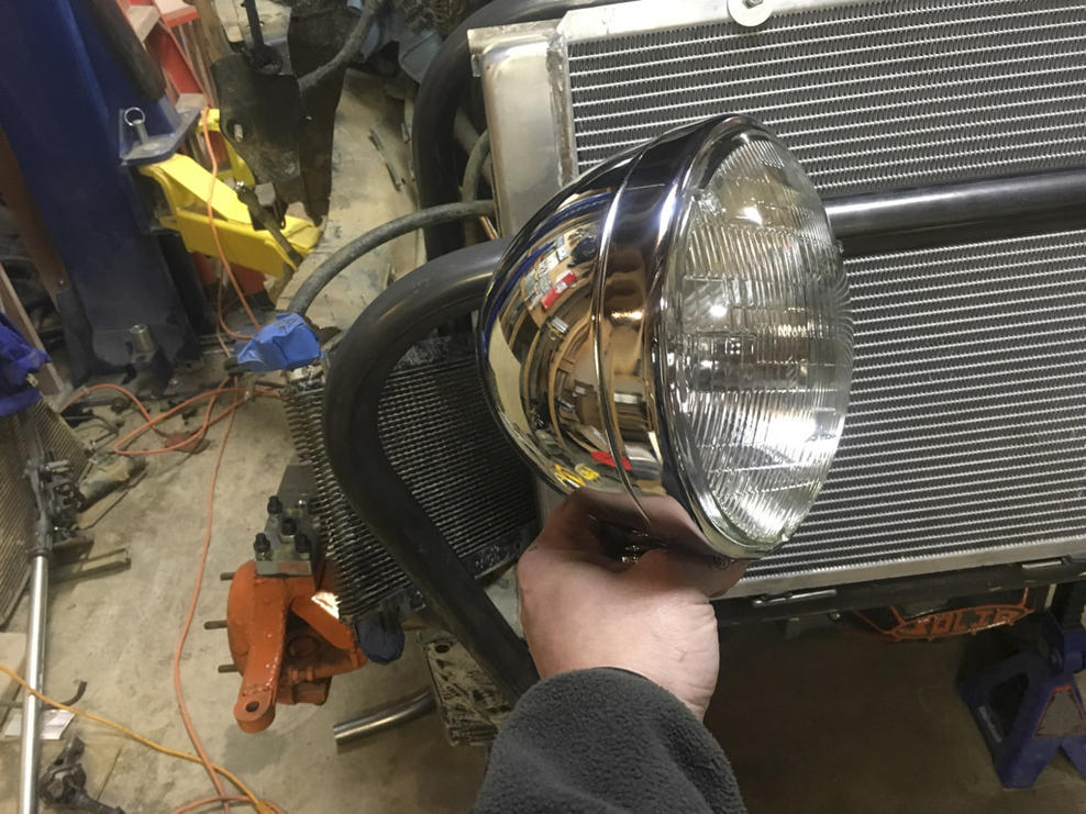

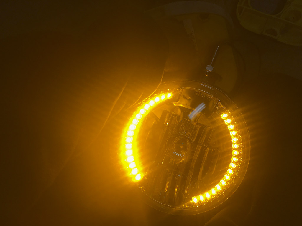

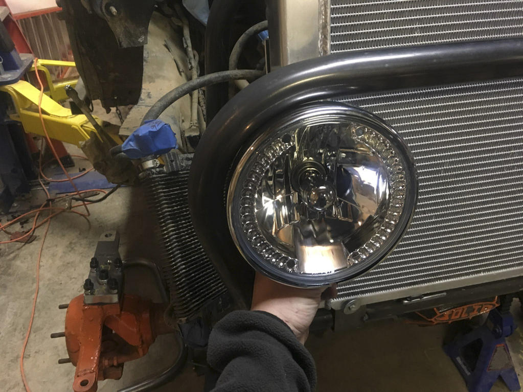

Hotrod 1932 Ford coupe headlight assemblies that came with stock sealed beam halogens.
Retrofitted new headlights with integrated LED strips for halo effect, or use as a parking light / turn signal.
I'm following all this closely! Very unique build! Those light strips look fantastic, what brand are they, and where did you get them?

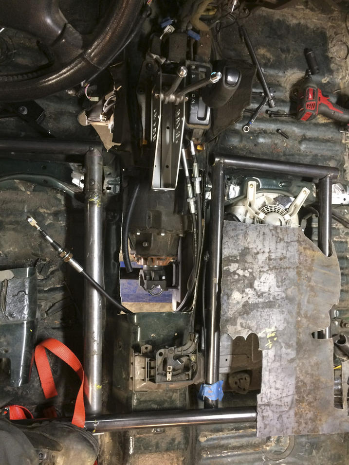

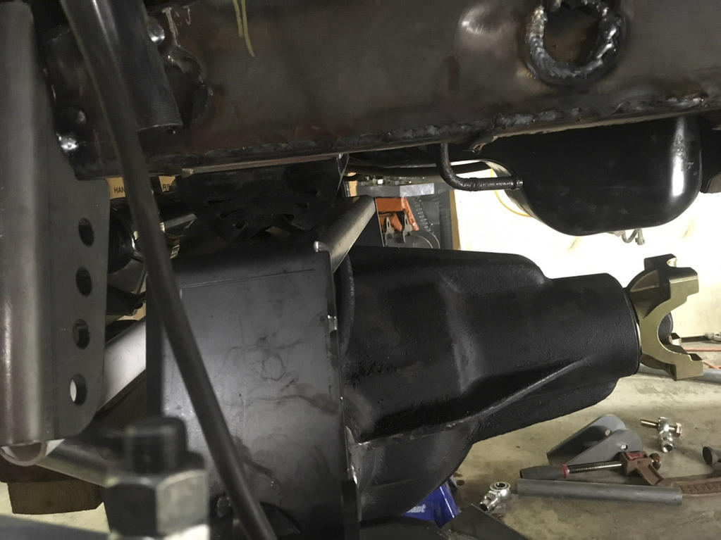

Transfer case is in for good!

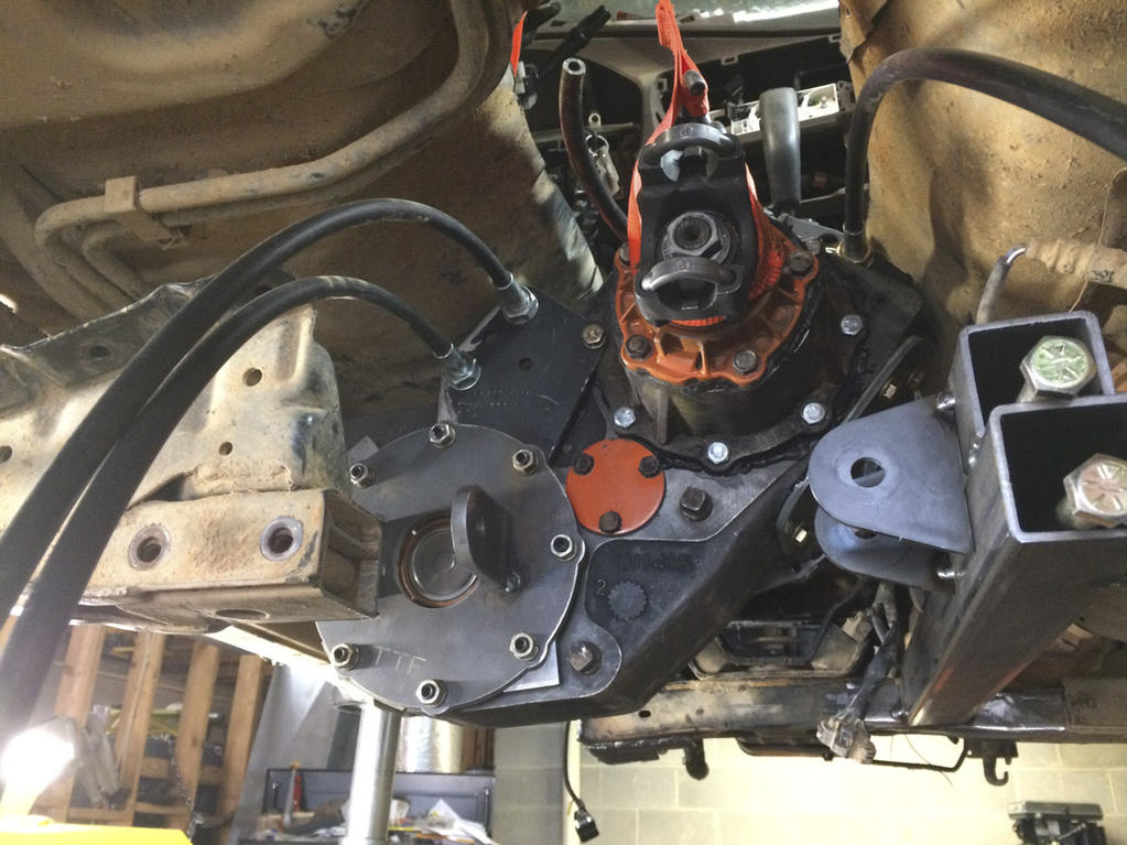

Finally installed the transfer case and fabbed up the cross-member.

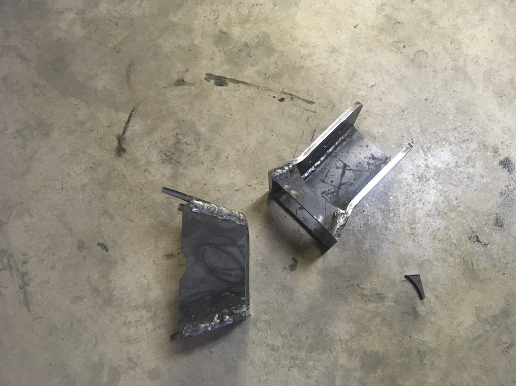

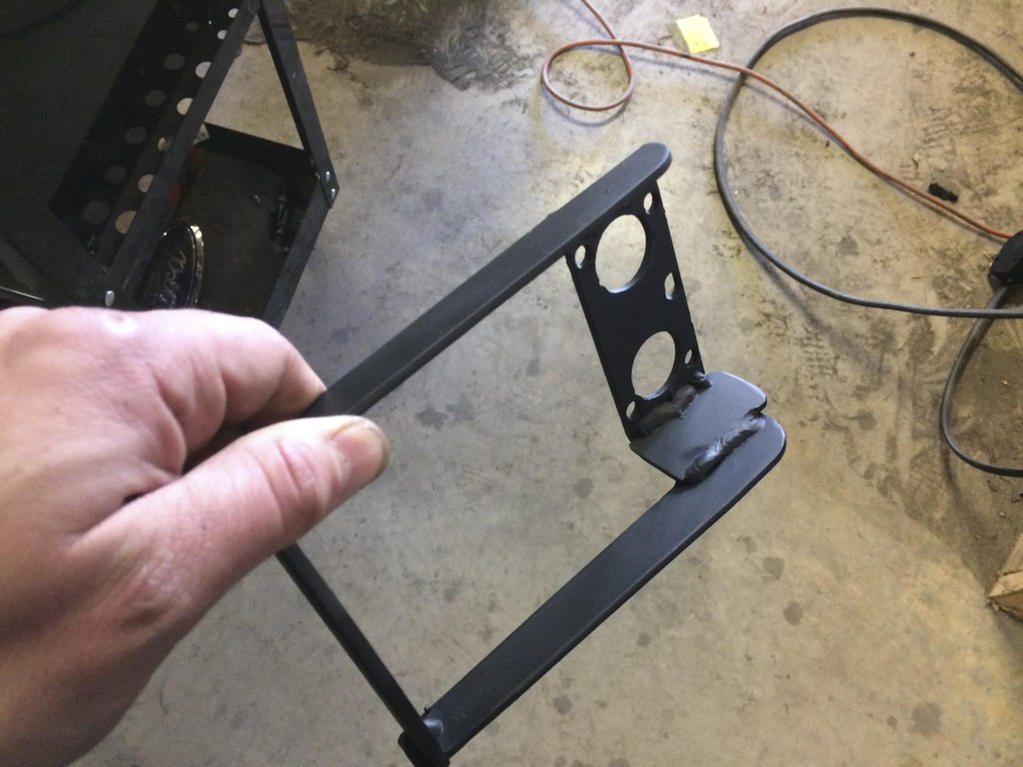

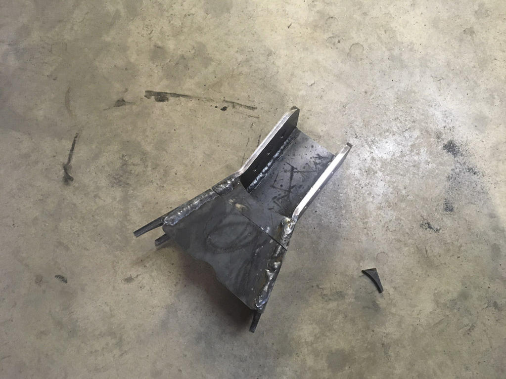

The Northwest Fab shift cable bracket didn't fit at all!!!, so I had to cut it and weld in a new piece to offset it enough to fit properly. Worked like a charm! :reddance:

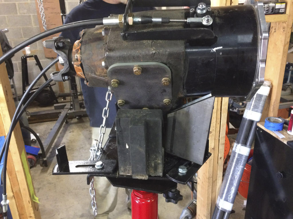

Installed the shift cables before installing the transfer case. There isn't any room to install them after the transfer case goes in.
The transfer case is clocked to allow the case to be above the frame but also allow the front driveshaft to not be at a steep angle. Thus I had to make a mount to put it on the tranny jack in the correct orientation. Just used a Harbor Freight Wheel chock by drilling a hole in the tranny jack plate and screwing the chock in place to keep it from flopping over.
Installed.
Complete with cross-member and attachment points all welded up and painted.
The view from the cab looking down.

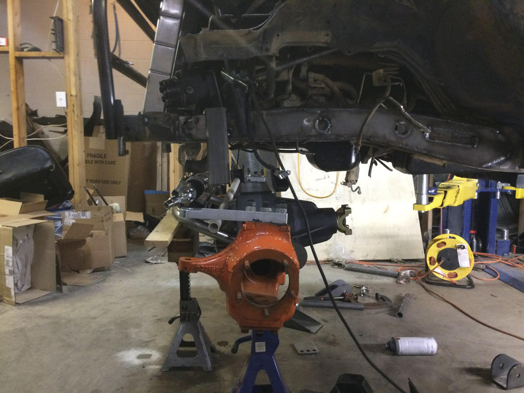

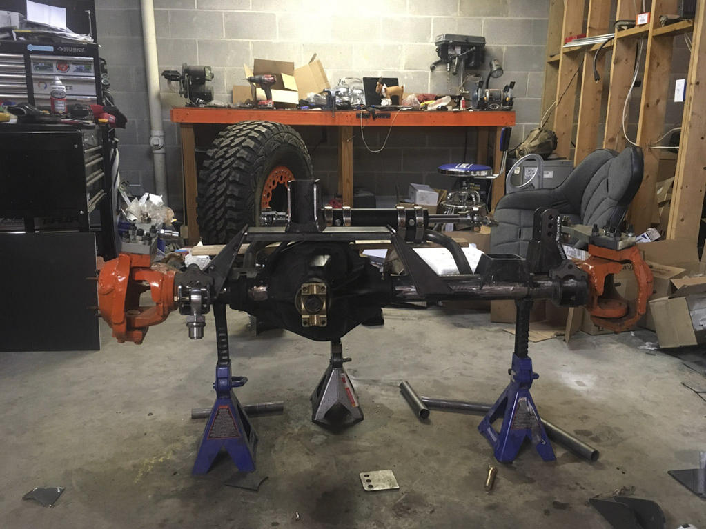

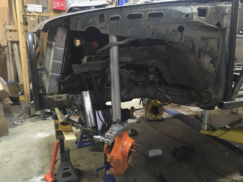

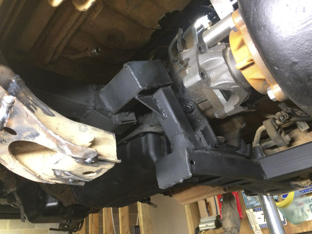

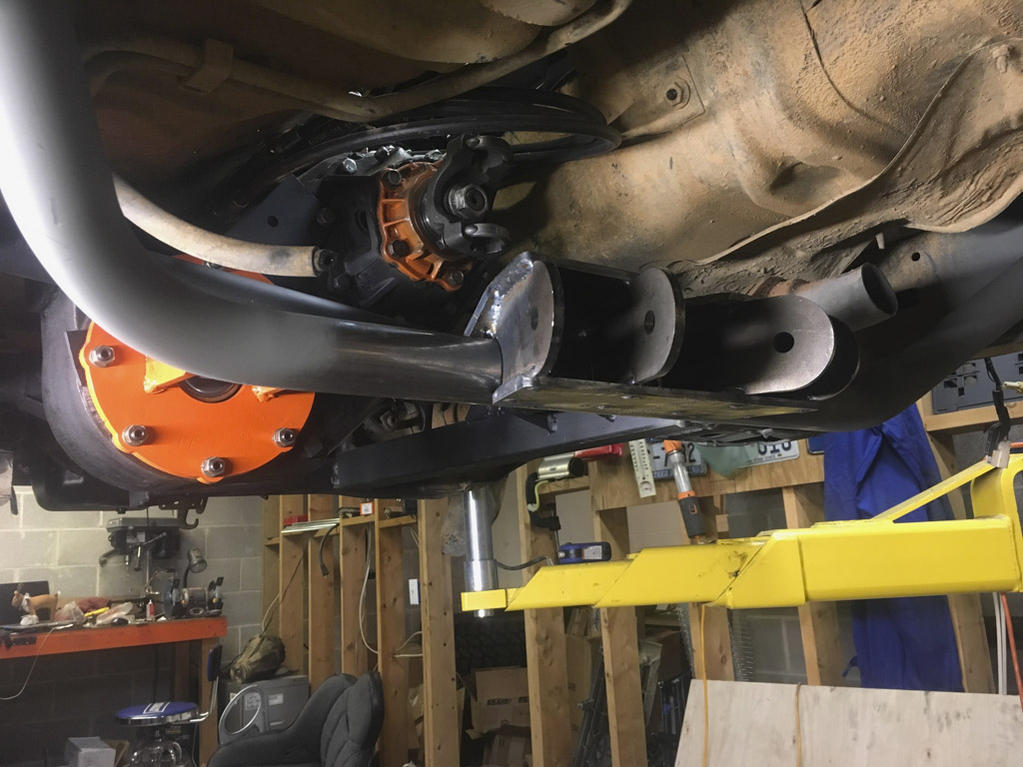

Got the tranny cross-member cut and notched to allow the front drive shaft to articulate. Then started to tack on all the front suspension components to the front axle. Had to move it forward two inches to clear the oil pan. I'll suck up the extra wheelbase (total of 119" now) to keep the hydraulic cylinder in the back and off the rocks. I'll see if I can pull the rear axle in an inch or two and chop more of the rear off to shorten the wheelbase back to 117"

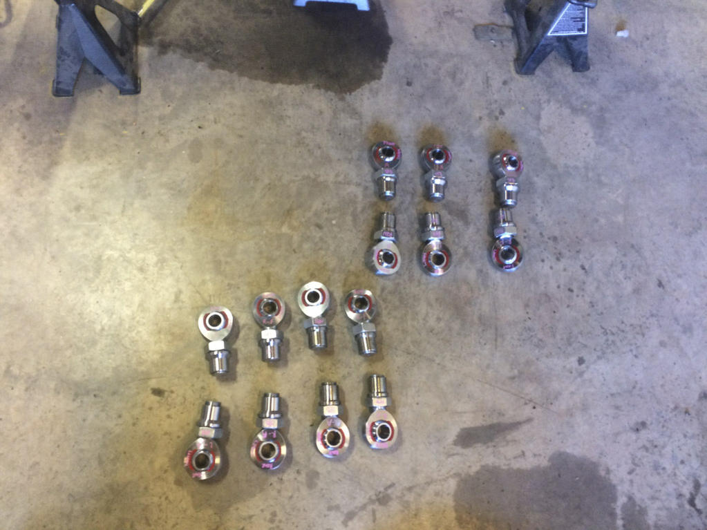

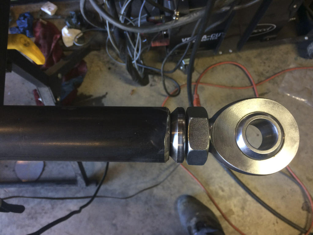

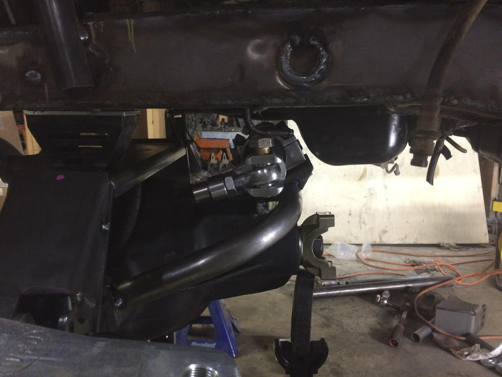

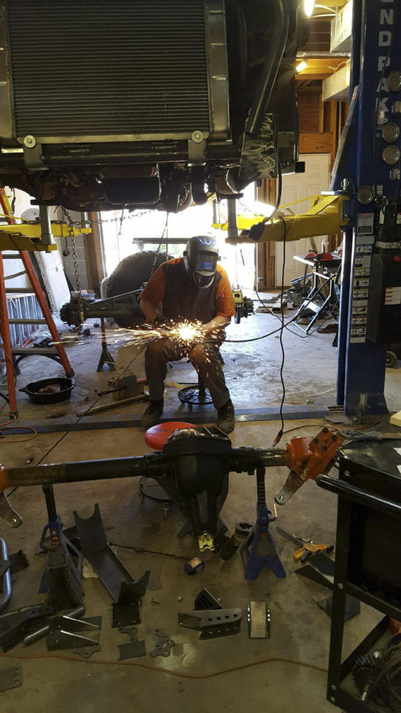

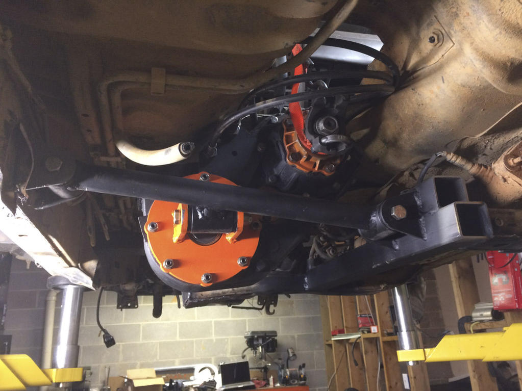

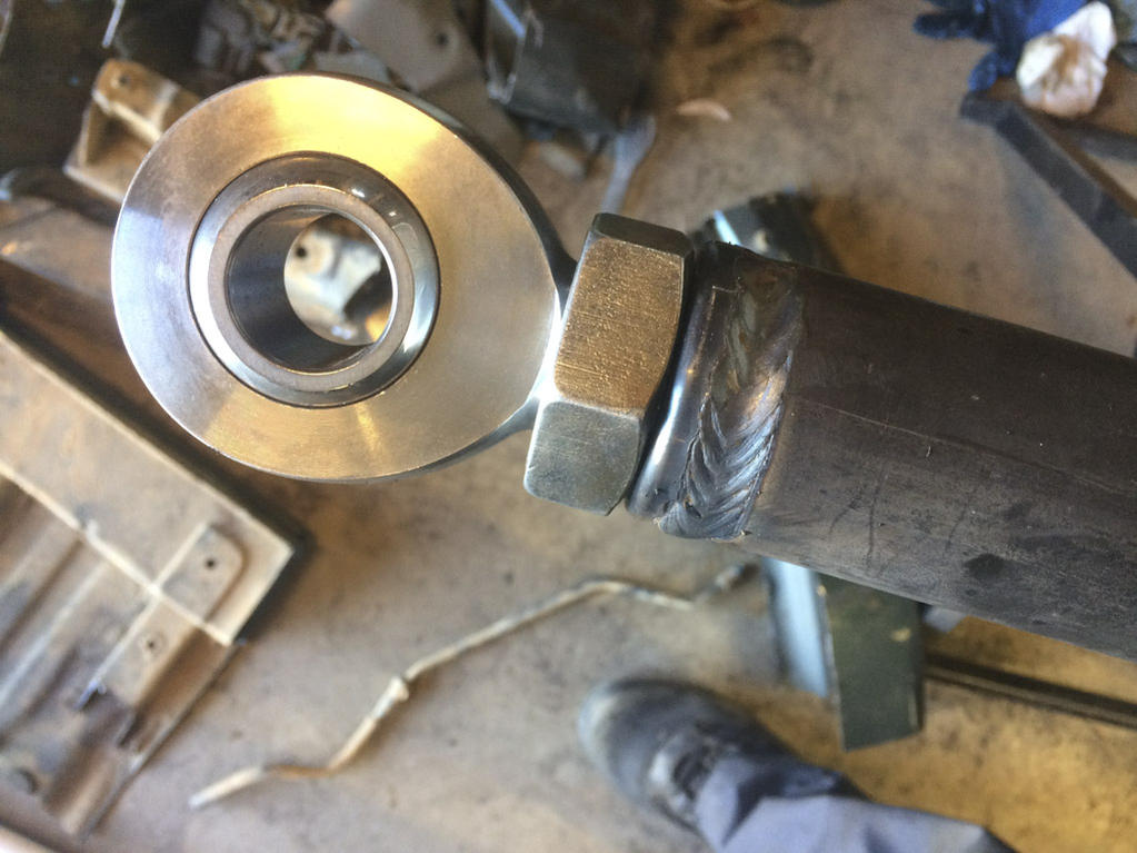

Only had a few hours to work today, so I started organizing and welding up the suspension links. Lower links front and rear are four feet long 2" diameter .5" wall DOM. Super strong! The uppers are a little thinner. 1.75" diameter .25" wall DOM.

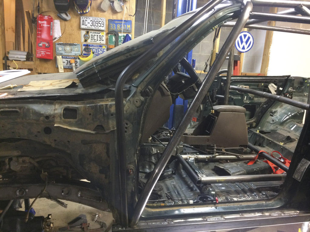

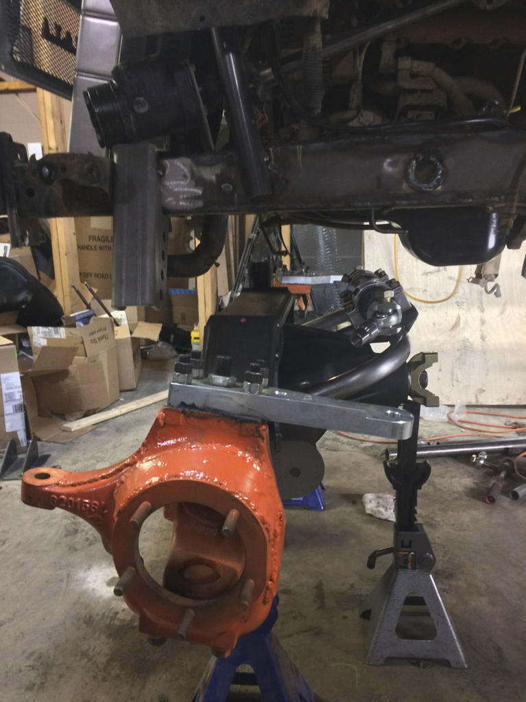

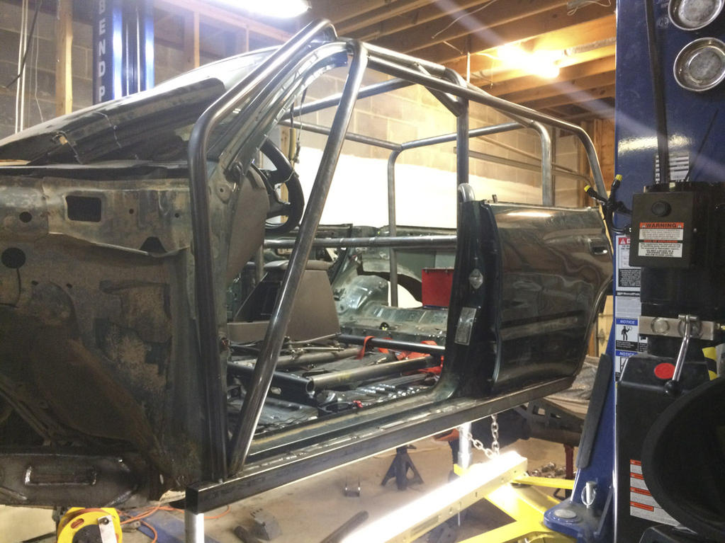

Had to move the steering ram to the front, which I didn't want to do, but It gave me the clearance I needed to lower this rig and shorten up the wheelbase back to a manageable 117". Also trial fit some of the exo-cage. Not sure I'm happy with the rear design yet, so I might start over there.

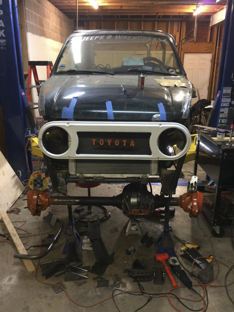

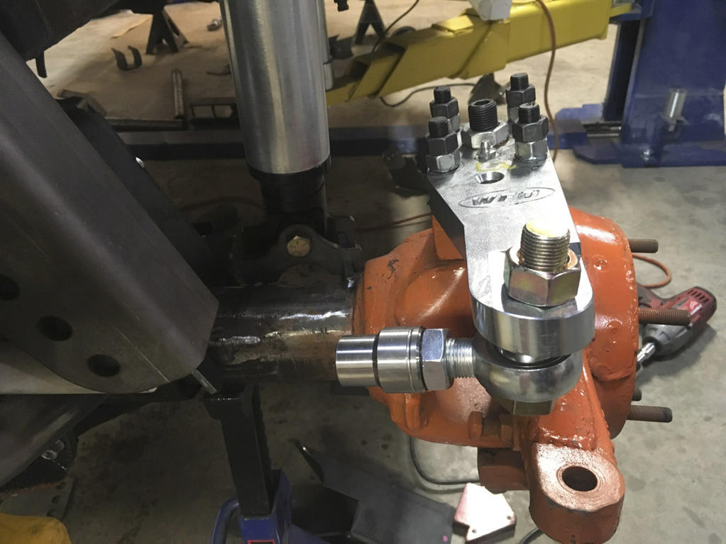

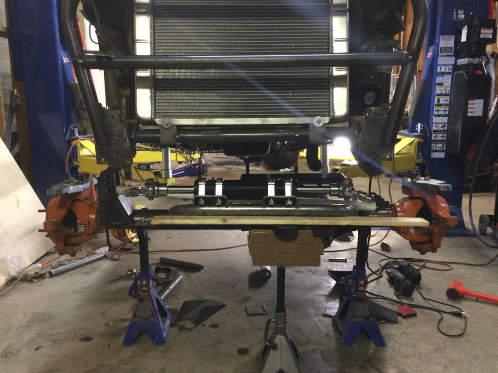

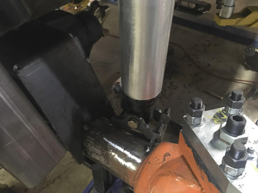

Got my steering ram configured and measured tonight. New grade-8 bolts came in today too. I had to order them specifically for the thread count on the WFO Dana 60 high steer arms I have. I also put the front end at full bump (notice the crushed bump-stop) to measure the shock hoop height. It's always best to build your suspension at full bump with a completely compressed shock/strut/Coilover (without the coil), etc. It ensures you will have adequate clearance when the suspension cycles up to a full stop, a hard hit and so on. Do this with the tires in place too and the axle center at the radius of the tire size. e.g. 40" tire, the axle center (notice I said center) should be set on stands at 20" high max. All looks good and I'm off of work the next two days so I will be in the shop doing as much as I can to get this beast finished up. I'm just over 6 weeks away from my deadline to finish...well get it working. By Trail Fest 2017 it will be running and driving safely, but cosmetically it will still probably look like a great big pile of :toilet:... yeah that!

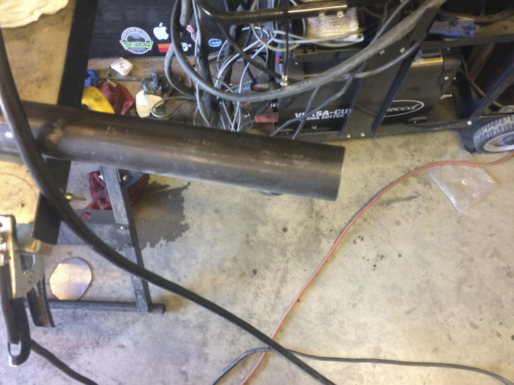

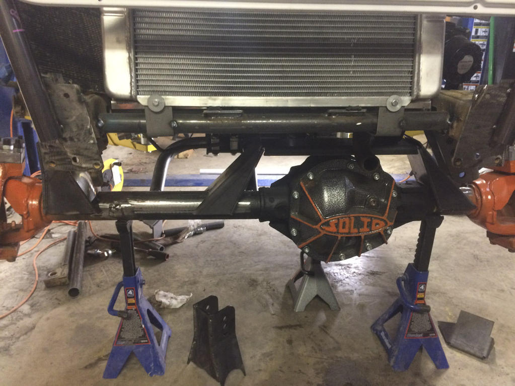

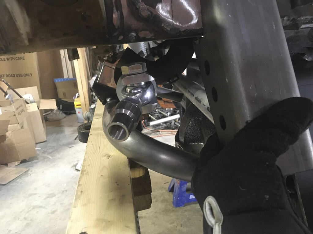

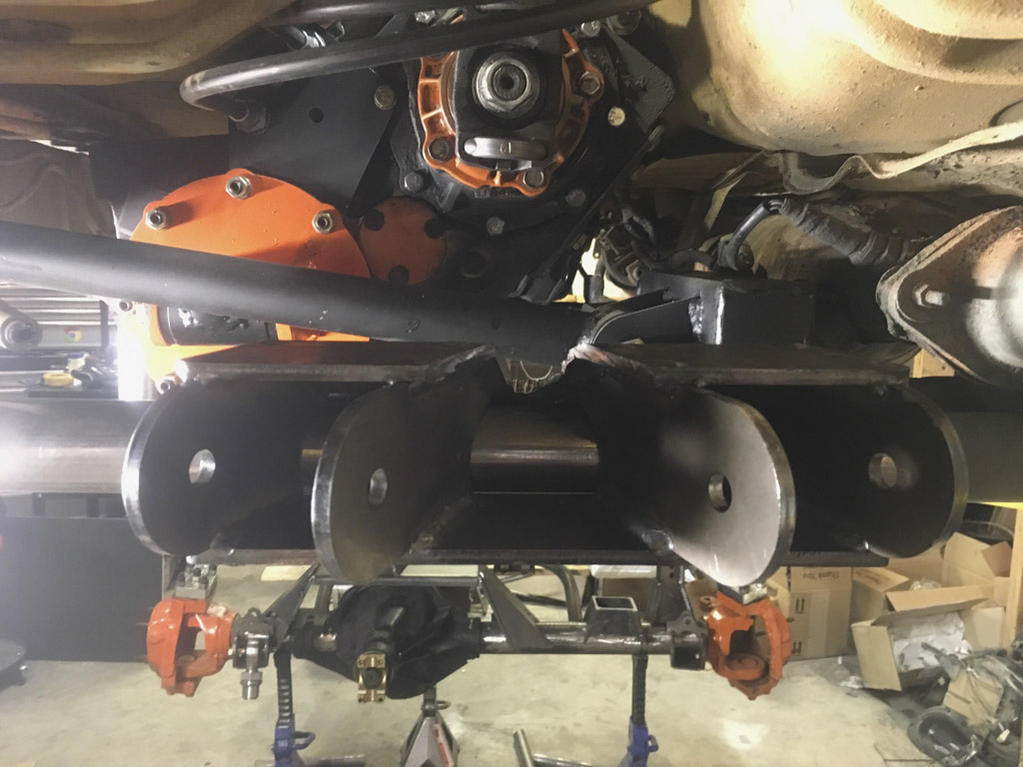

Started on the rear link mounts today. Getting the lower mount cross-member was a bit of a pain but it turned out great. Used 1.75" .25" wall DOM for the cross-member.
Also hacked the front upper link tower in half to move the link location to the driver side. The lower half will become a bump stop mount for the right side.
