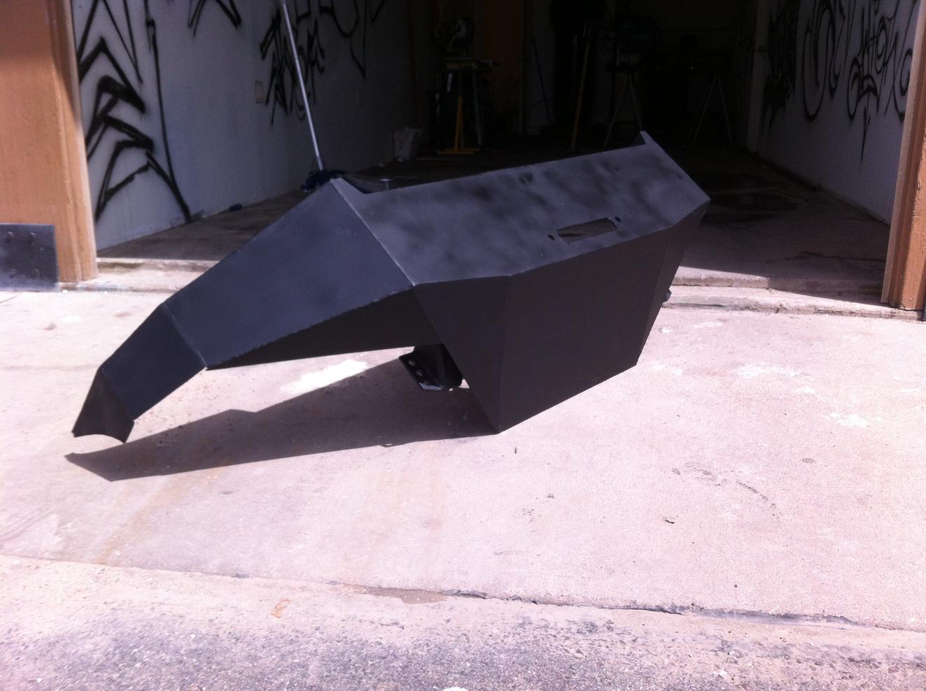

Little update from my corner of the world. Got everything welded up today and cut my winch control access ports. Just waiting on my Hanma 7.5s to spec my cutouts. Once that's done I'm doing a roll on bedliner. Comments/concerns/questions are appreciated.

I think you will like it more. We did a high tuck wing that contours the fender flare to continue the line. We also made it to follow a lot of the sexy lines our trucks have. I've always loved the lines and curves, why get rid of em? I took some aesthetic aspects from a few bumpers but I tweaked them all to get the most sturdy, functional, and best looking bumper we could design. Plus I also chose a form to reduce weight. The method of reinforcement is almost space age and hopefully weight saving lol. I don't want to take the credit for the design though because my buddy Cam did most of the design work. I just gave him ideas and tweaked with his designs he made to my requests to get it exactly how I envisioned it!

That sounds really interesting, I'm curious how you dealt with covering components like the washer bottle. Will your bumpers have cut-outs for lights like most competitive offerings?

I think the bottle will be hidden by the wing of the bumper, so very little to no modification necessary at all.
I need to decide what I'm going to do for lights. I was thinking about incorporating Trek Lights LED offroad lighting into the bumpers so the buyers just have to wire and go drive. I contract for Trek, so it would be cool to meld two of my businesses into one co-op
If that doesn't work, the obligatory PIAA holes will be cut, but that's a last resort. I have much better ideas floating around in my cavernous cranium that I'm not going to share at this point in time to keep me from getting killed by my business partner lolol

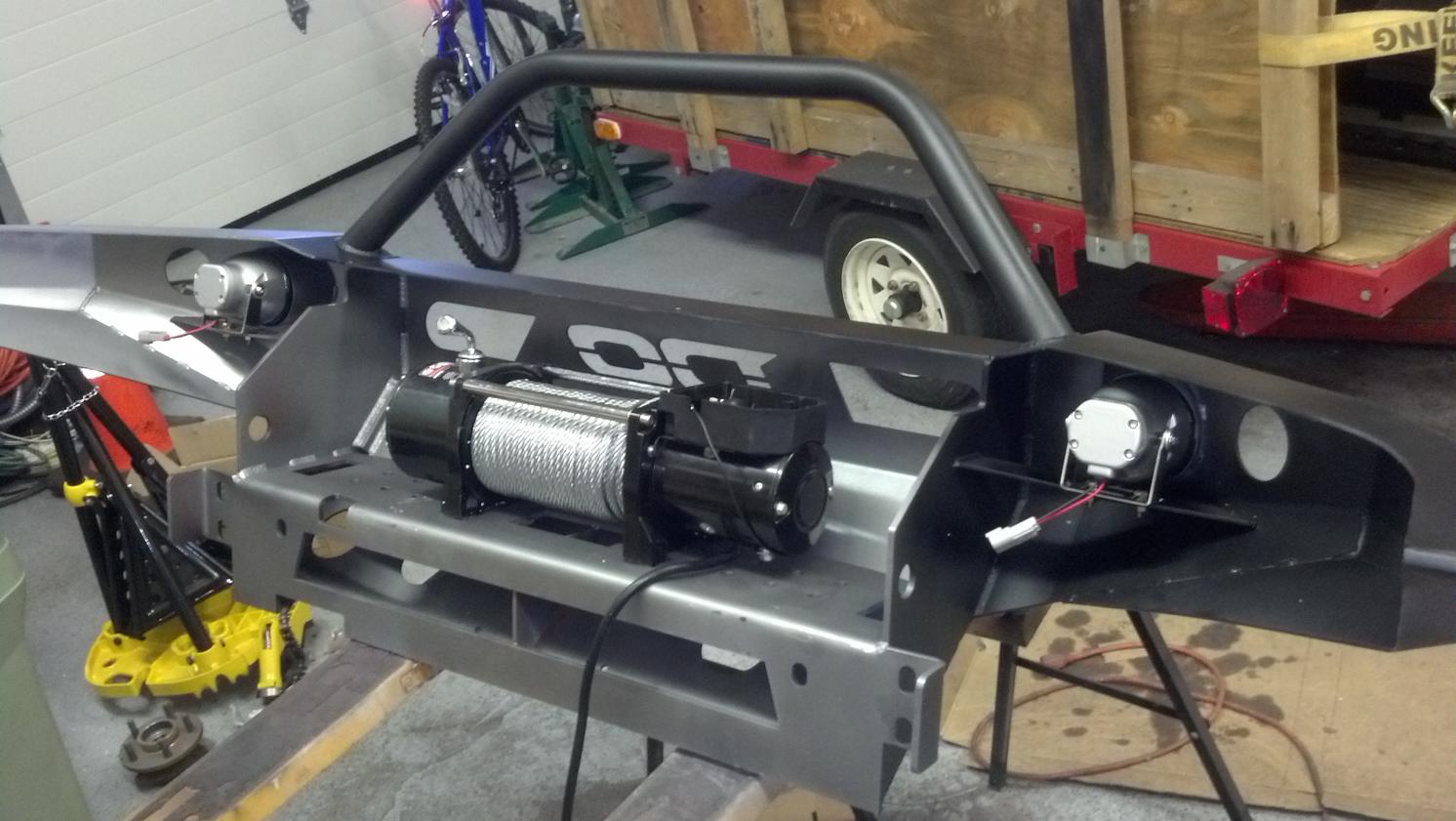

What kind of bumper did you order? I've been looking for used winches myself
I ordered a CBI. I ordered it bare steel no hoops. I've seen Superman3043's bumper in person and have some ideas to make it a little better. CBI will take the heavy work off my hands with the bumper itself and I can add some plating and hoops where I feel I want or need the extra protection. Then just prime an paint.

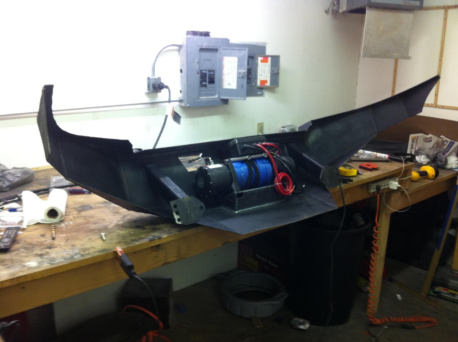

A little action from the back side
Looking good! How do you bolt the front of the winch down? Be careful with the leverage the you induced by having the frame mount come off that square tube. I'd consider adding a fill-plate between the square tube and bumper on the back side, just to solidify the area. Good work man!
