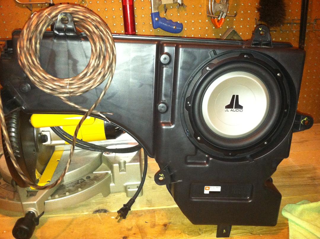

Patience is indeed a virtue. Finally got the enclosure from a fellow forum member. Did the mods to the enclosure per instructions from previous threads on this forum. Installed this JL Audio 8W1v2-4 subwoofer, and played around with some poly fill. I also removed the factory wiring harness and ran some quality speaker wire from the sub and out thru the grommet, siliconed up the factory mounting holes. It's sealed up pretty well. Gave a quick test in the trunk of my beater work Accord with the same JL amp as I am installing in the T4R. Exceeded my expectations, hoping to get similar sound from the factory location. Thanks to all who responded and to all the great contibutors on this forum. Quick questions, are their already bolts behind the cargo panel to attach the enclosure, or do I have to buy something. If so any body have a recommended size and type of screw/bolt.

If I remember correctly, the storage bin that you will remove and replace with the sub enclosure is held in place with two bolts. You'll need a few more of the same size, as the sub enclosure bolts on in 6 spots. Can't remember what size, though...probably 10 or 12mm.
