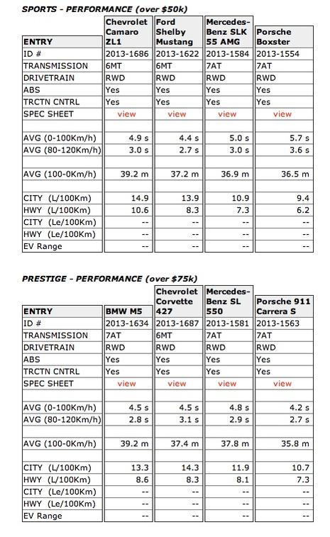

No matter how many times he does the test, even using the latest equipment, it's unlikely to yield proof positive. Our experience is that braking tests, like mileage claims, are often incorrect.
And Greg, where did those braking numbers come from? They look better than what I recall for the 4R, which I thought required 140 or so feet from 60 mph, which was still better than all the competition. I think C/D required 200 feet from 70 mph.
Heck, we barely got the Corvette 427 to stop at 122 feet from 62 mph. Only the new 911 did better.

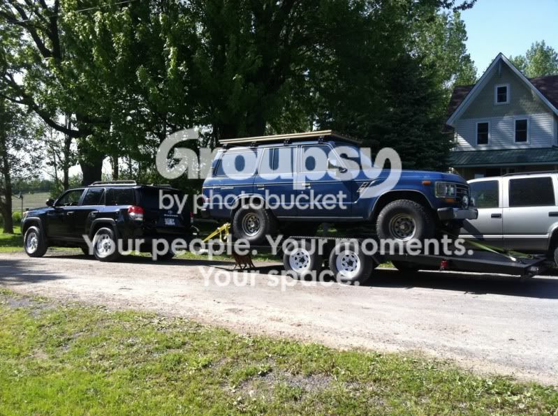

I've completely shredded brakes in a weekend of driving on the Nurburgring in Germany on my old GTO. This is what I've towed in my 4Runner:
Oklahoma City to San Antonio
46EEE651-C121-4C81-9914-B96817C3C9C7-3918-000002D7C3811805_zpsccb59e2d.jpg~original
Upstate NY through Upper Michigan to KC
1f4073c0.jpg~original
I've towed more than anyone that I've seen on this board. Brakes have never been an issue.
