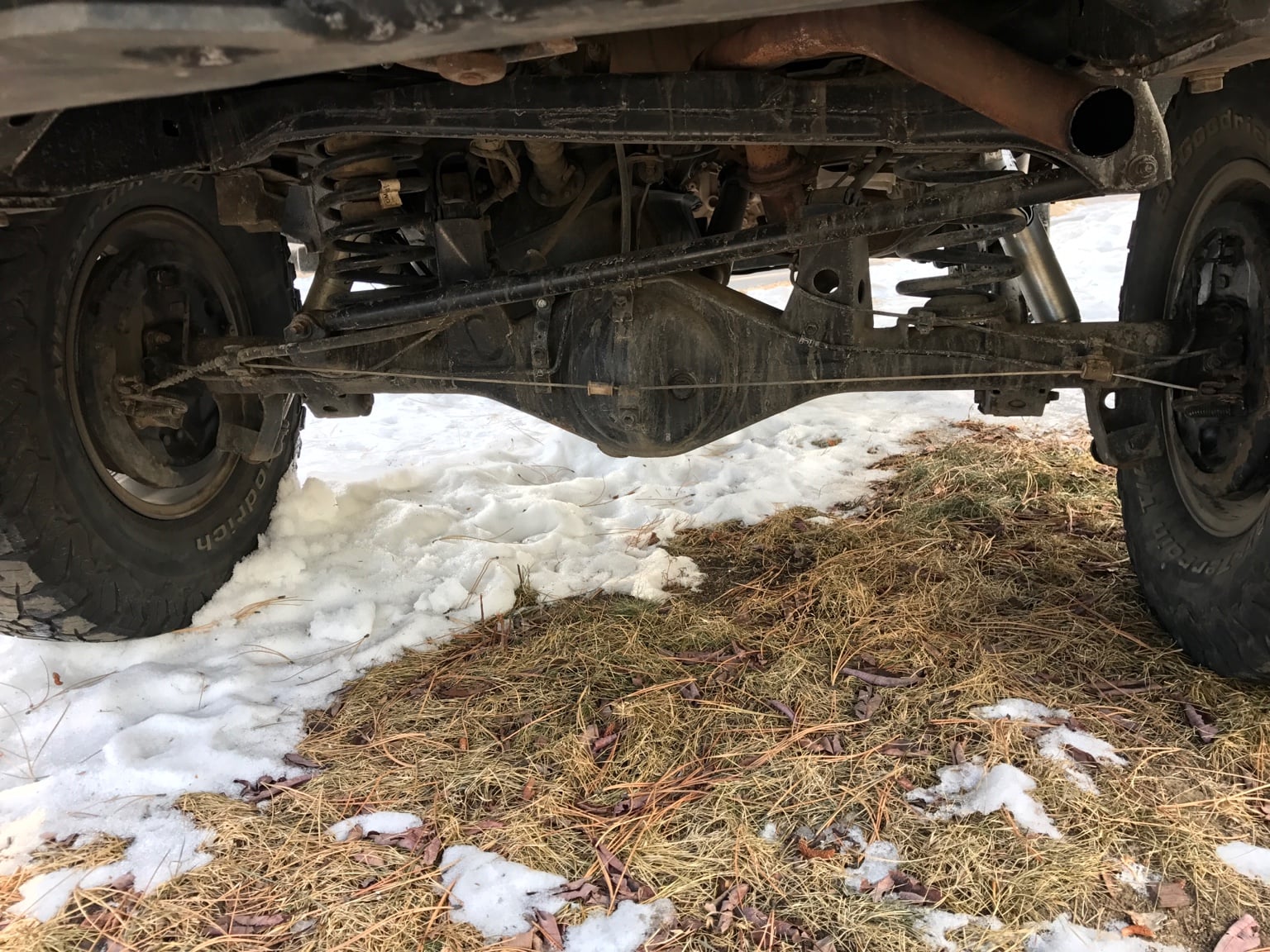

The fox is finally back in! Also the axle seal isn't leaking yay!
And before anyone says anything about my aweful Panhard angle! I have a set from [MENTION=28464]eimkeith[/MENTION] getting installed on Thursday! (Today is Tuesday). So yea

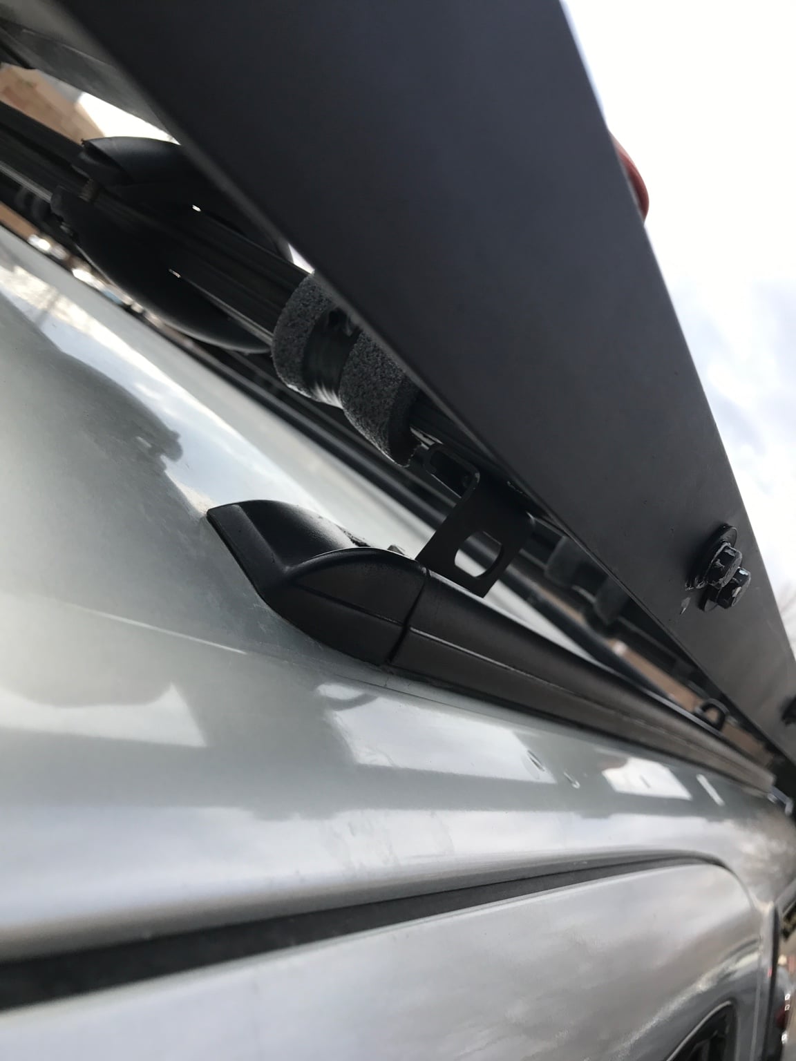

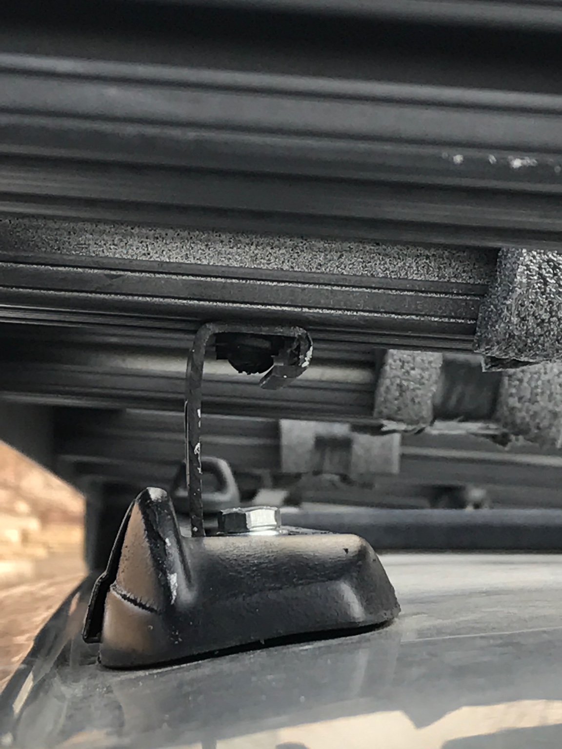

Can you post a close up picture of your roof rack mounts? What did you use? It looks like some sort of cold rolled channel.
So it's just the Unistrut you find in the electrical section of Home Depot. I'm going to go to a thicker gauge before I put the tent back on because these have been breaking and I keep replacing them with the leftover I had when I built it. Super simple just 4 holes, 2 on each side and the rest is self explanatory! I hope this helps.

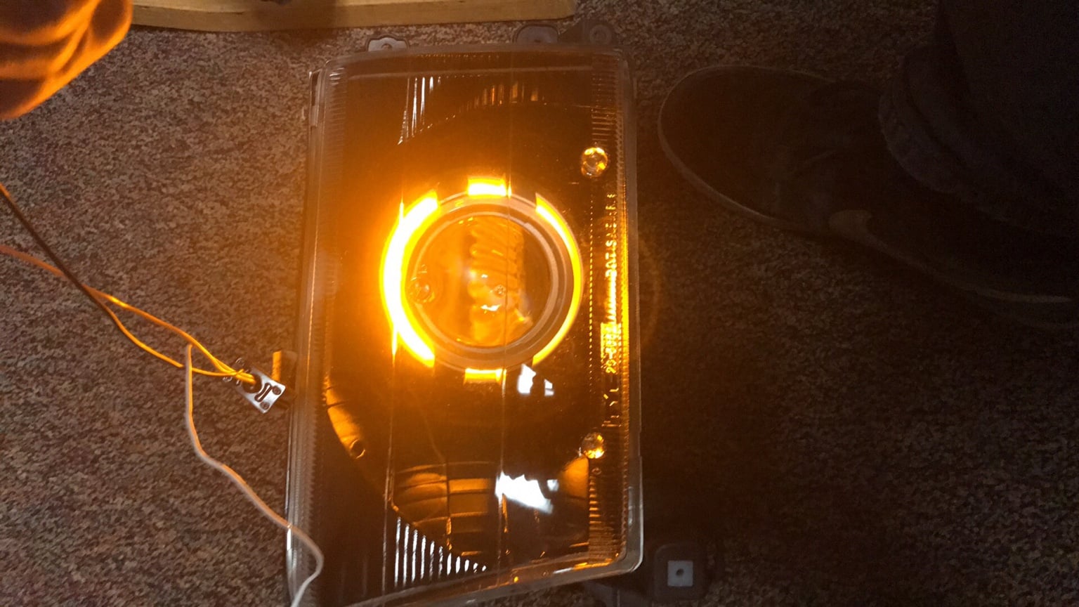

Installed the SRQ Retrofits today with [MENTION=107971]derpiful[/MENTION]. Install was a little weird.
Here are photos tearing the old ones out!
[/url]IMG_9401 by alex fleming, on Flickr[/IMG]
[/url]IMG_9403 by alex fleming, on Flickr[/IMG]
This was easy, disconnect/cut and it came out easy.
Now these to go in!
[/url]IMG_9404 by alex fleming, on Flickr[/IMG]

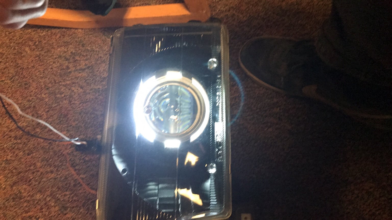

This is where it got weird. Plugged everything in and wired everything properly. Flicked the lights on and all we got was a quick flash then nothing..??? Now we start trouble shooting. We started with the grounds and they seemed good. Then onto switching bulbs, ignitors, and computers. We started making progress... sorta. Then we switched the power wire placement on the battery. Boom! we got ONE light to stay on. Repeated switching Ignitors and computers around to see where are other problem is. Turns out I recieved a old style ignitor not compatible with the computer I recieved. Talked to SRQ and they are over nighting the proper ignitor and all should be well. Here are pictures with just Halos, will update with light output and cutoff etc. shortly!
