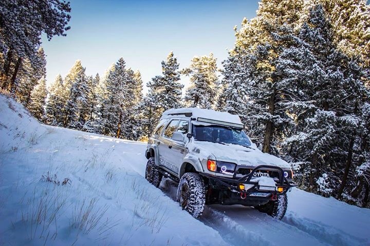

The Control arms are starting to settle and feel much nicer, the poly bushings are definitely stiffer and make for a bumpier ride but feel firm and definitely improved the handling in the highway, much more steady! I still have a gnarly clunk which I'm assuming is my rear right wheel bearing/axle bearing. It's an odd sound and hard to pinpoint but I'm going to go to a Toyota dealership to diagnose and hopefully replace over thanks giving! Also some glamour shots of the pretty nightmare!

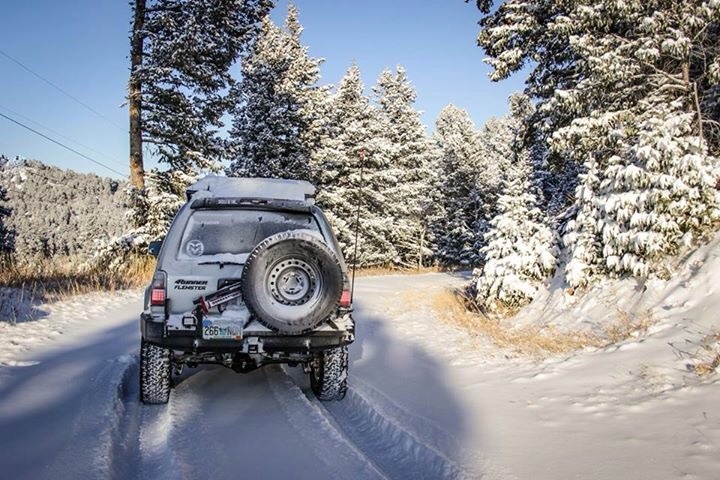

Well here it all is! Self made Alluminum roof rack based off of Prinsu Designs and my new Odin Designs Type S 3 Man RTT!

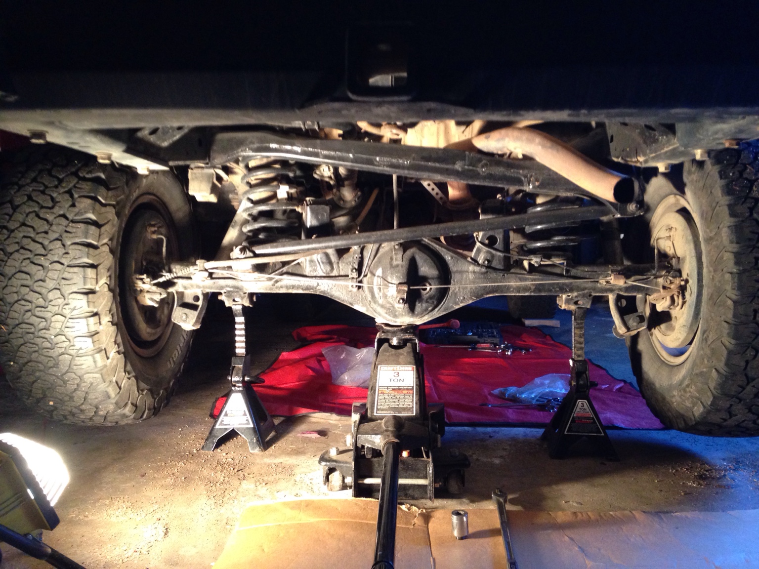

Lifted up the truck to track down my wobbly passenger rear wheel. I believe it's a bent axle shaft but it's not leaking nor does the bearing make noise which I find odd.

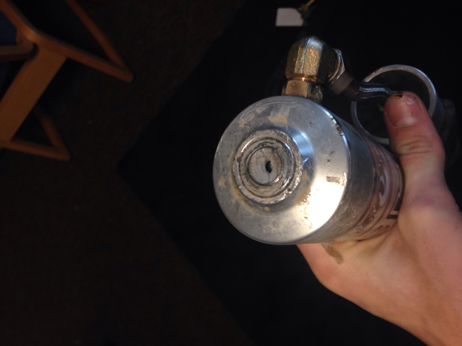

This happened again.....
That sucks about the shock. Isn't that the second time that has happened to your Fox shocks? If I were you, I would just pick up a pair of LC Tokico black shocks and call her done. They are cheap enough to try out, and if you don't like them, you can try something else and sell them for little if any loss. Or, it might be useful to have as a back up option for how often the Foxes are breaking. Still digging your build though.

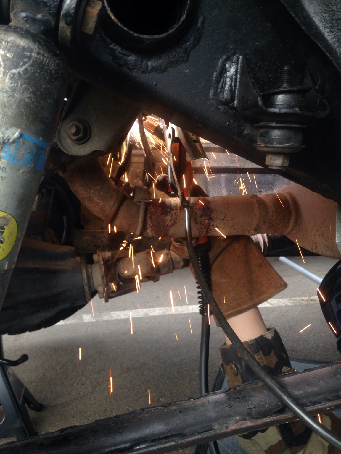

Hayden welded up my exhaust a little to get it off the frame. Round 2

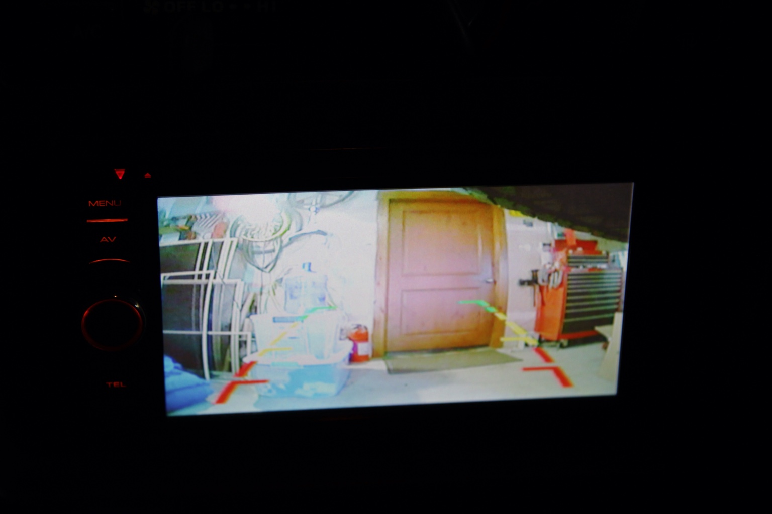

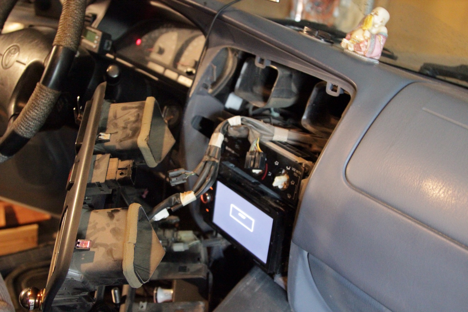

Then today I wired in a backup Camera that my sister bought me.
Had to pull out the stereo deck which always is just annoying
Then the yellow AV cable went to RCAM IN on the back and I also had to wire the reverse trigger which I just ran all the way to the reverse light and just followed the AV cable all the way to the rear which is also where my CB coaxle Runs.

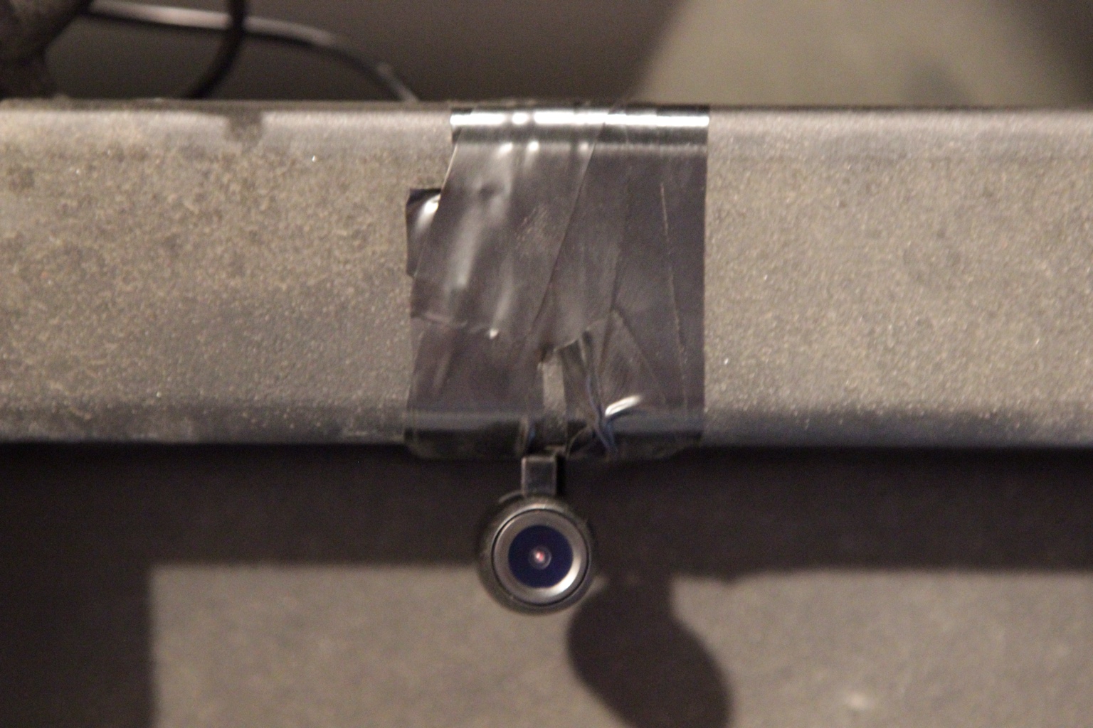

Mounted it on my swing out, it came with an adhesive pad but didn't stick to the textured powder coat so. As shitt as it looks. I taped it. It holds and works perfect
And after all the wiring the moment of truth.......
It worked!

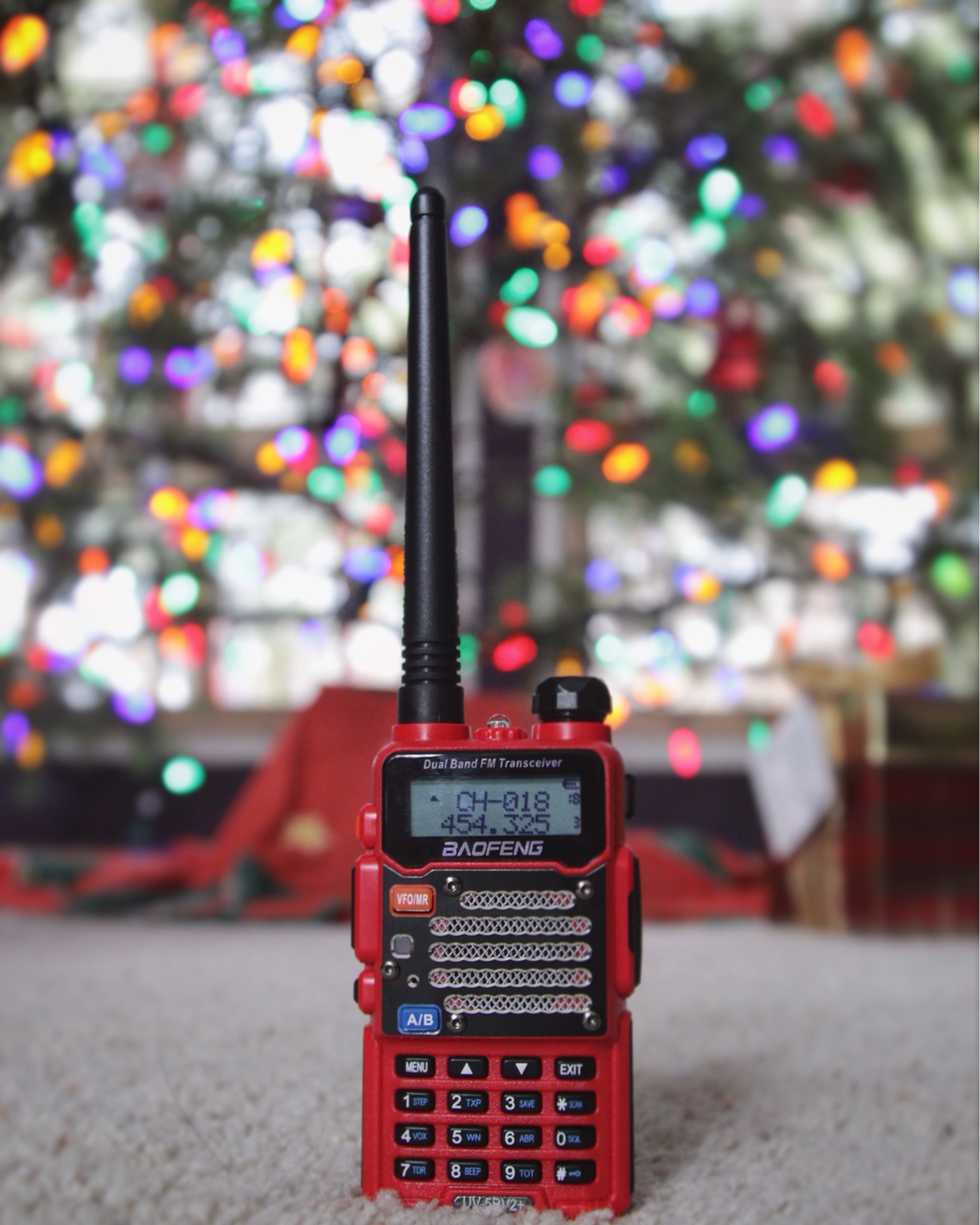

Also got a Baofeng UV-5RV2+
Nice handheld. How do you like it and what is the effective range? Also, how are you liking your KO2s in the snow so far?
Manuel says 10-12km which I think is a best case scenario, in the mountains Im assuming 2-3 miles max. Have yet to use it as a radio, only as a Scanner till I can take time to get my HAM License.
I like the idea of a portable option. I wonder what a vehicle mounted radio range with mounted antenna is. I think that you are right about the limitations land features that mountains and valleys pose. I think it would be cool to have a vehicle booster, and mounted antenna when you are in your vehicle, but the ability to use the mobile handset when desired.

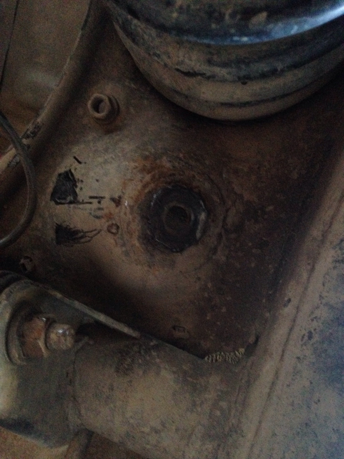

You have to remove the pin for the ebrake cable, I used pliers for the Cotter Pin and used a hammer and a Allen key to hammer out the pin after soaking it with PB Blaster. Then unthread all the nuts on the back as well as remove the hard brake line from the drum and use something to stop the flow or let it leak all over your shop floor/driveway!
[/url]IMG_9350 by alex fleming, on Flickr[/IMG]
Here it is with the axle pulled slightly out, notice the 4 holes, only three visible. This is where the 14mm bolts go that you have to remove the nuts off of to remove the shaft and assembly. Also the bag and rubber band keeping the brake fluid from leaking. Also the Ebrake cable is barely noticeable on the left of the axle hanging down below the top left hole.
[/url]IMG_9353 by alex fleming, on Flickr[/IMG]
Here is the axle seal and the 4 holes mentioned above. Also on the outside of the ring there is a large oring that goes all the way around it not pictured. I spend time cleaning this by hand with paper towel and I also used a shop rag to clean the axle seal then re applied a thin layer for gear oil to each before re installing.
