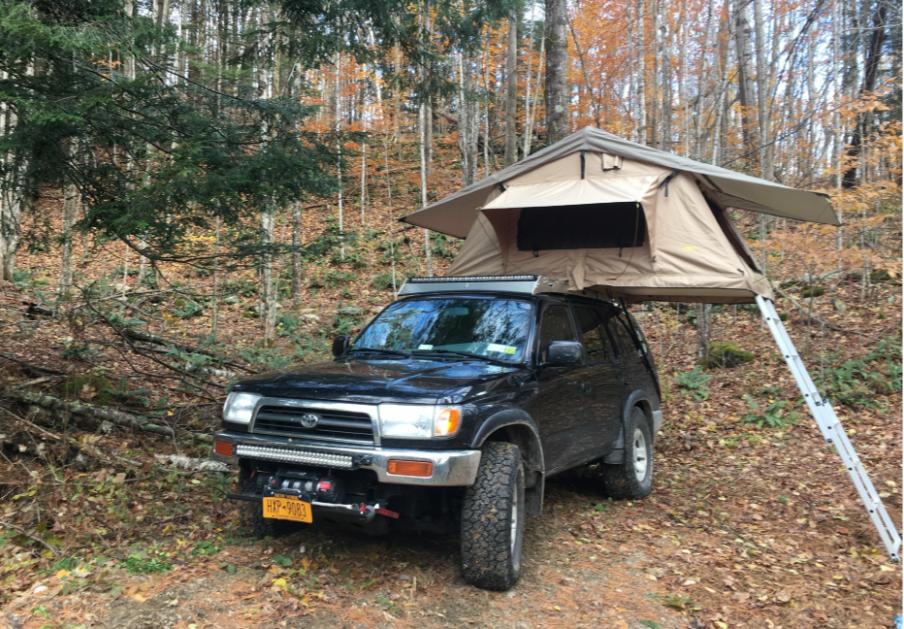

Hey all, I know that there's info all over about fluid film, but I'm worried about getting the 4R fluid filmed and then going offroading and doing river crossings. I got mine done in September, but then I did a few water crossings and went fast through some big puddles. I got really worried that I had compromised the coating and didn't want to spend $300 for another coating so I've just been running it through the car wash every other day.
What are your opinions on this? Would those water crossings and deep puddles have compromised the coating? Are constant car washes just as effective?
