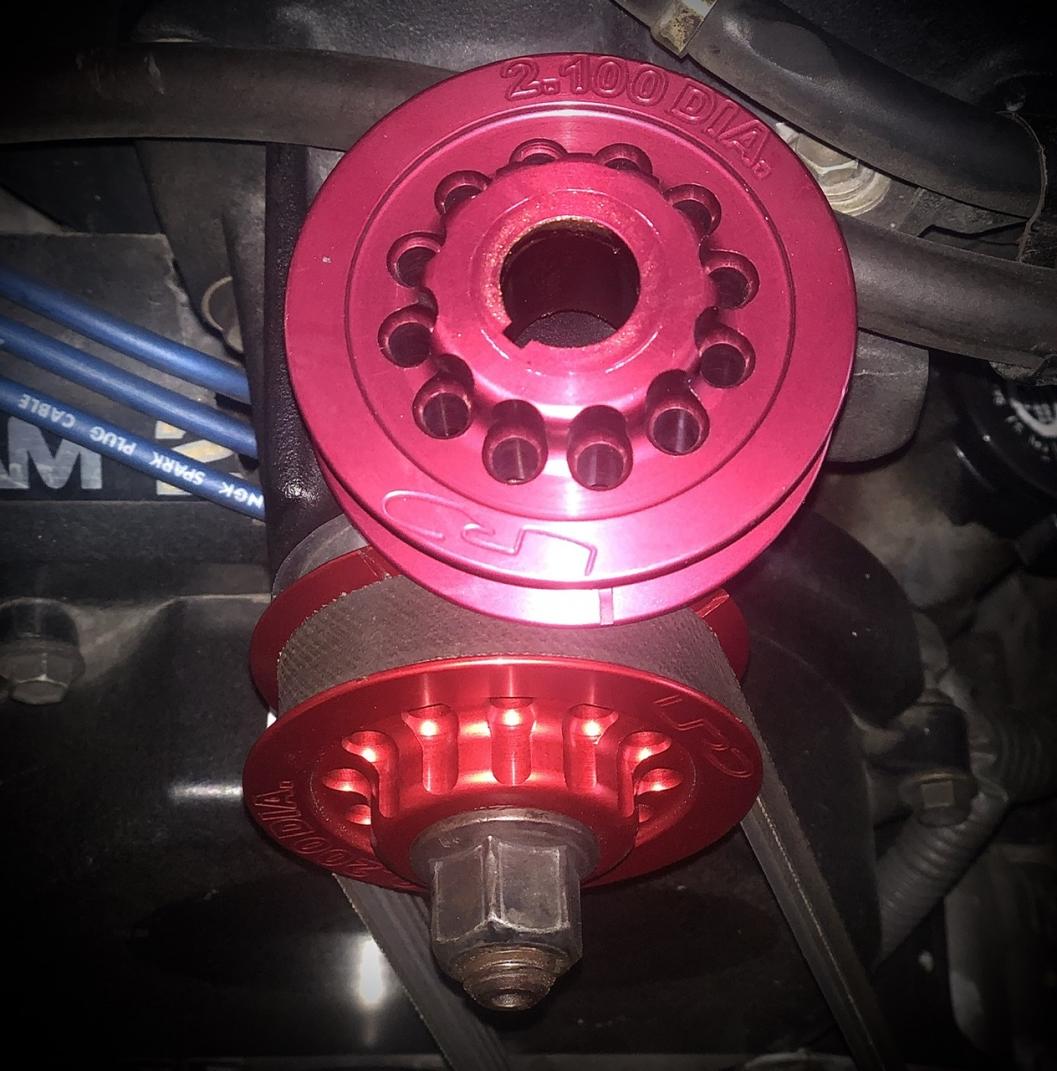

Got the URD AIC running properly today. Up until now it was not seeing boost and only adjusting timing. After a bunch of swear words and blowing into the line to test it’s integrity I finally found the culprit. It was a defective T connector that was blocked on one end... Anyway, drilled out the blocked T connector, reconnected the boost line and started tuning. Got rid of the high gear low rpm ping and the ping at 4500 rpm with pulling timing earlier, (or “adding retard” the politically incorrect way to say it). Added some fuel and upgraded to 2.1” pulley today.
Pulls great. No ping whatsoever. Drivability is awesome. Gadget at URD did a great job on the AIC. Very happy with this mod. Now I need a wide band O2 sensor to dial in the fuel.

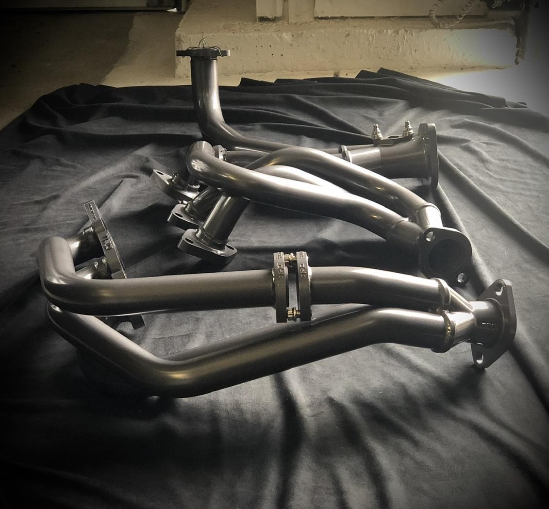

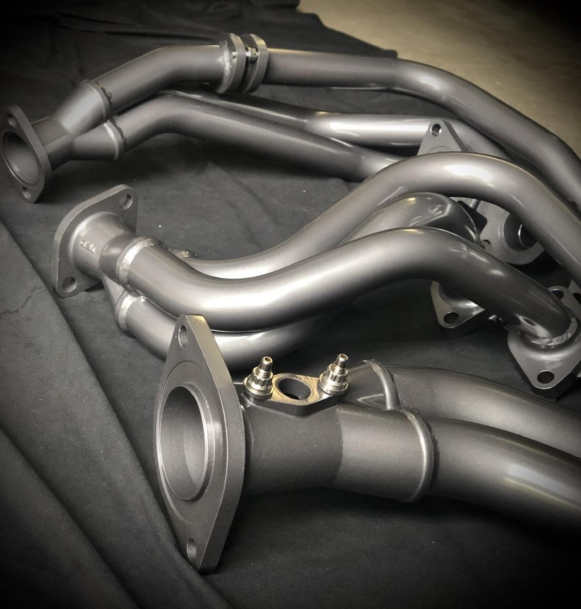

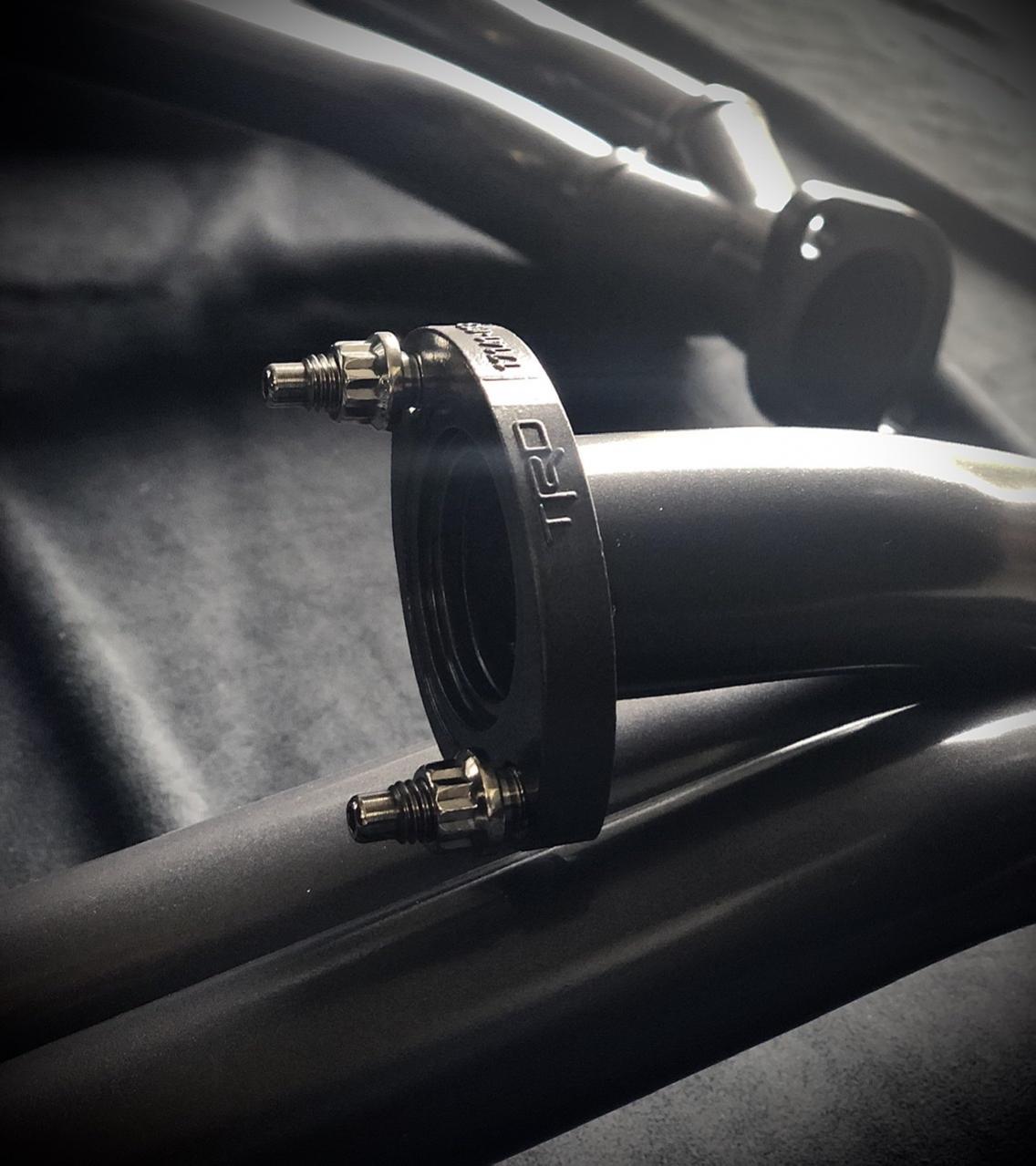

Eye candy. Can’t wait to get these installed. Three years since I first purchased these along with stainless ARP studs, had them ceramic coated 2000 degree satin grey ice at performance coatings in Auburn Washington.
Gorgeous headers- like jewelry!
You may want to Saran-wrap them, and then place a layer of blue masking tape over the saran wrap during install.
Install is a bear
... Would hate to see them all scratched up from install.
Indeed. I won’t be personally attempting this installation.
I'm glad you said that! I also did not install my DT headers. Even though they are "easier" than TRD headers it was more than I wanted to take on. Also required welding which I don't have the equipment for.
You'll like the end result but they sure are pricey. I see you found my header post already. You'll find yourself staying out of boost more often since you'll have more low-end power under vacuum than before. It's just so dang pricey.

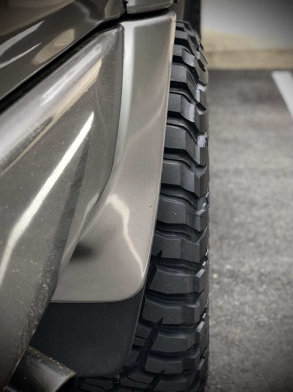

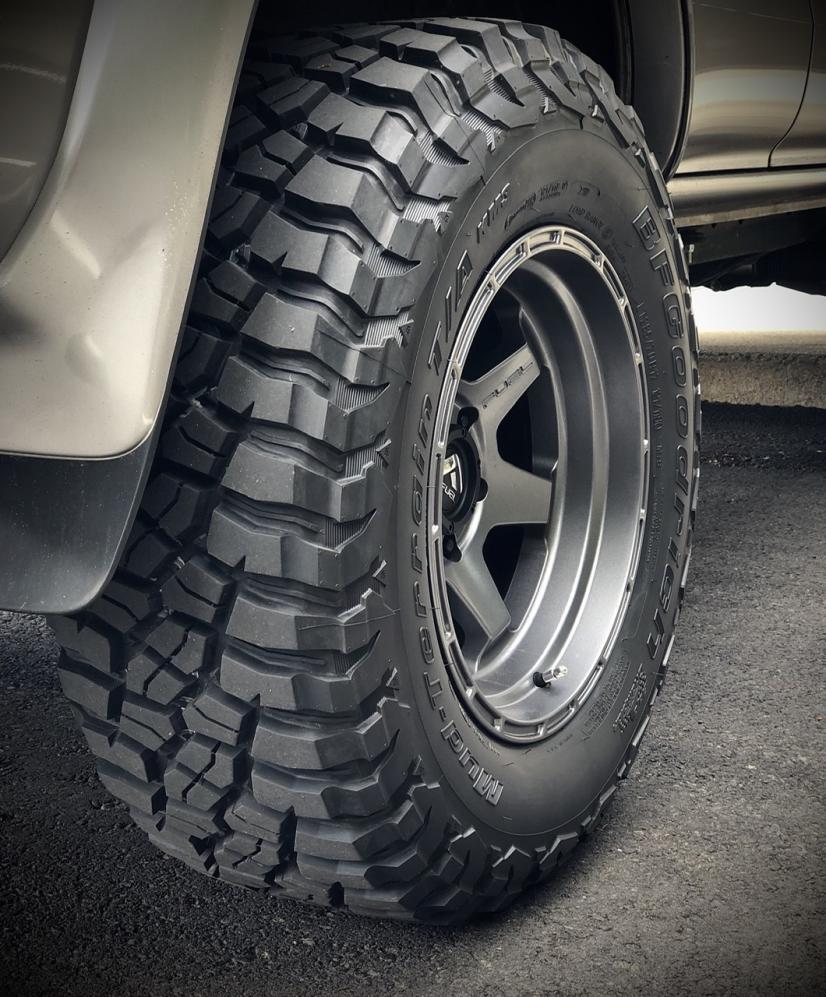

For members curious about the wheel and tire setup. The offset is aggressive. Body lift highly recommended in addition to suspension lift if you go with this setup. I have no rub on the front mud guard or body mount at caster set at zero. Mild rub on edge of front bumper fender flares within the fender at full clock reverse. This was resolved with 1cm trimming of the fender flare.
17x10 offset -18 Fuel Shok Anthracite
285/70/17 BFG KM3

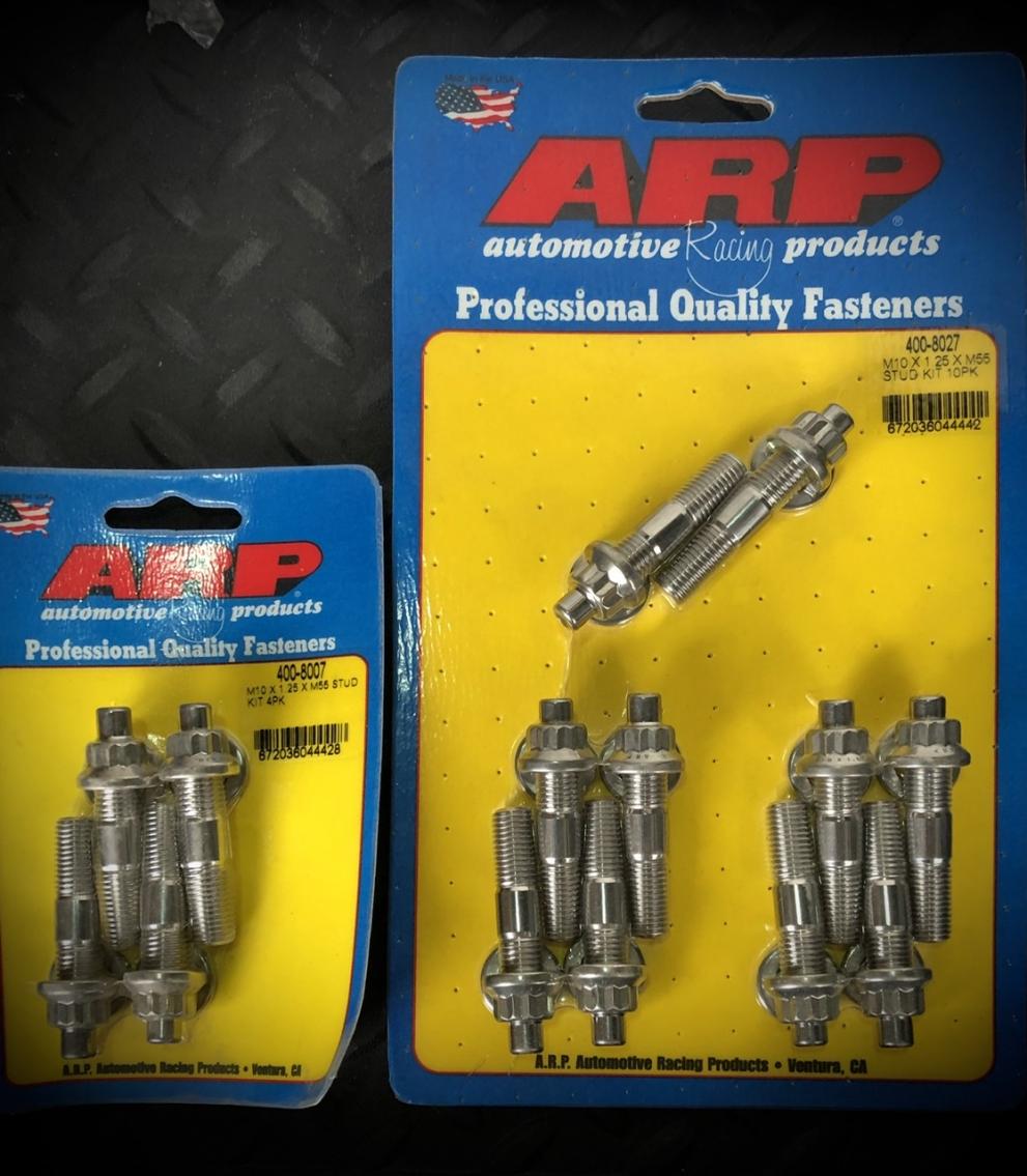

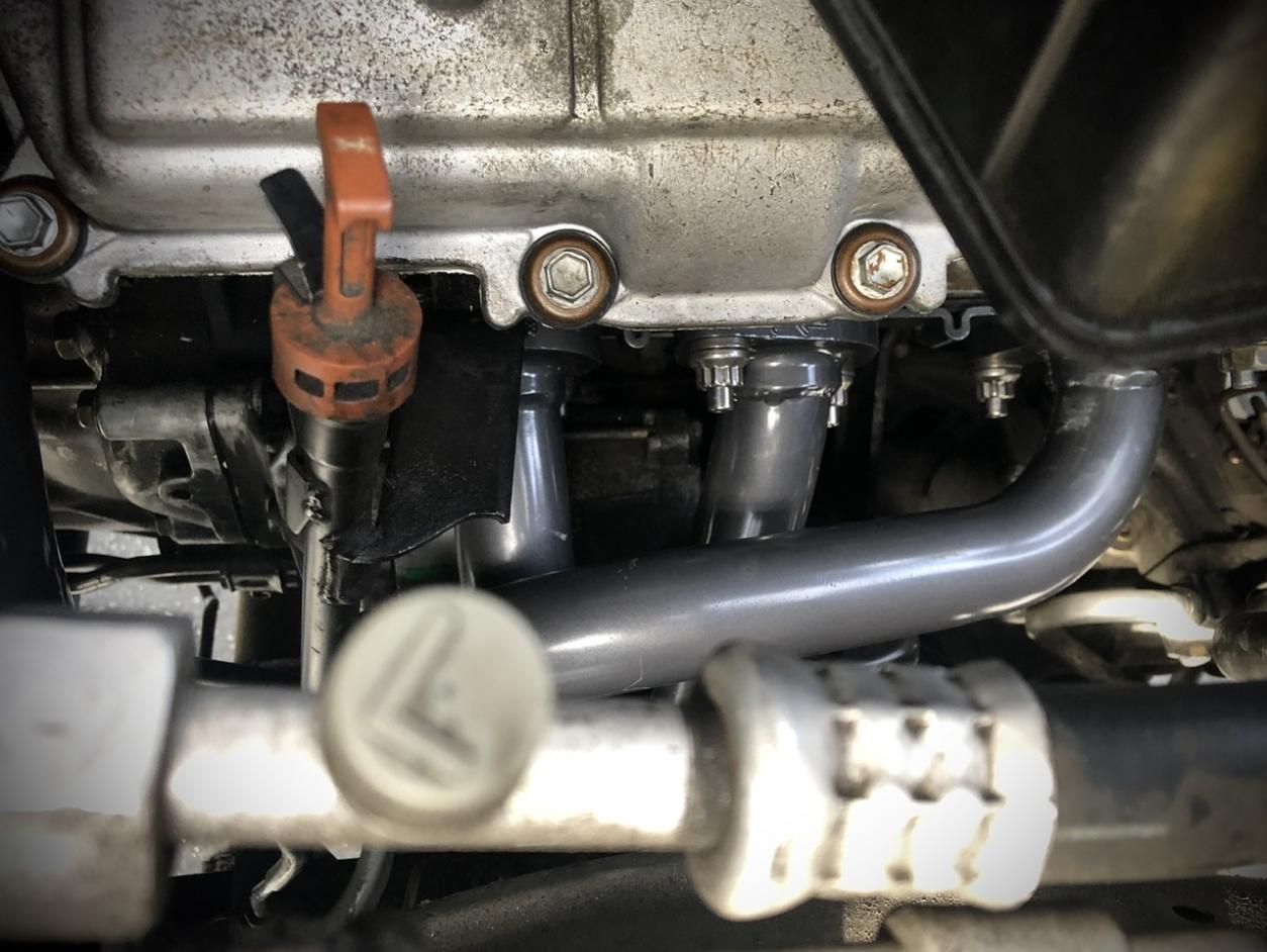

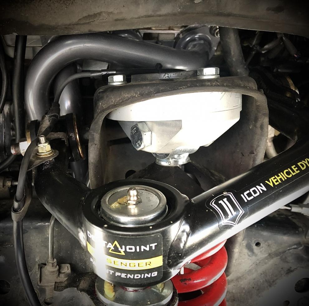

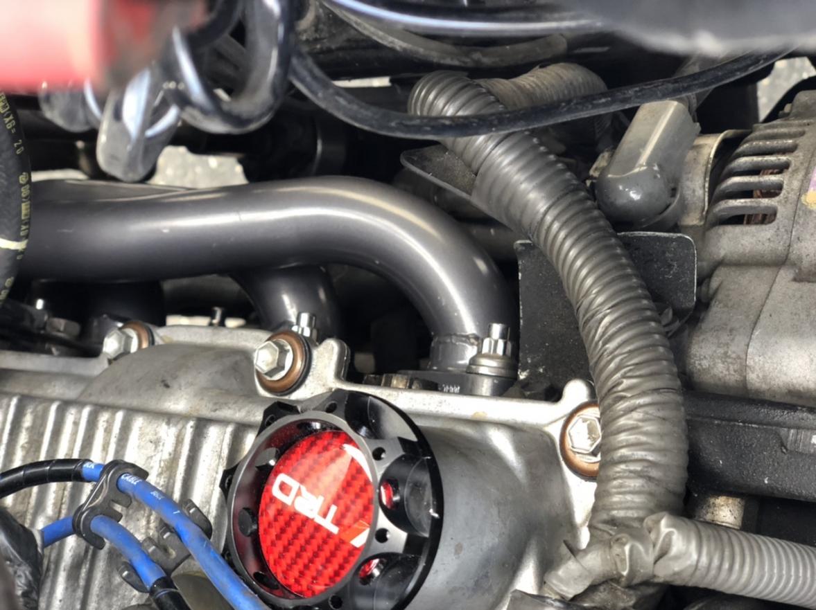

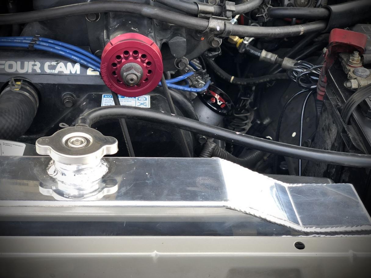

I had Torfab in Everett Washington install and address the following. Will update with pics soon.
-TRD headers
-ARP stainless studs. I was worried the broach would be too long for these TRD headers. They worked out according to Torfab.
-URD crank pulley
-Champion radiator
-Icon delta joint UCA’s

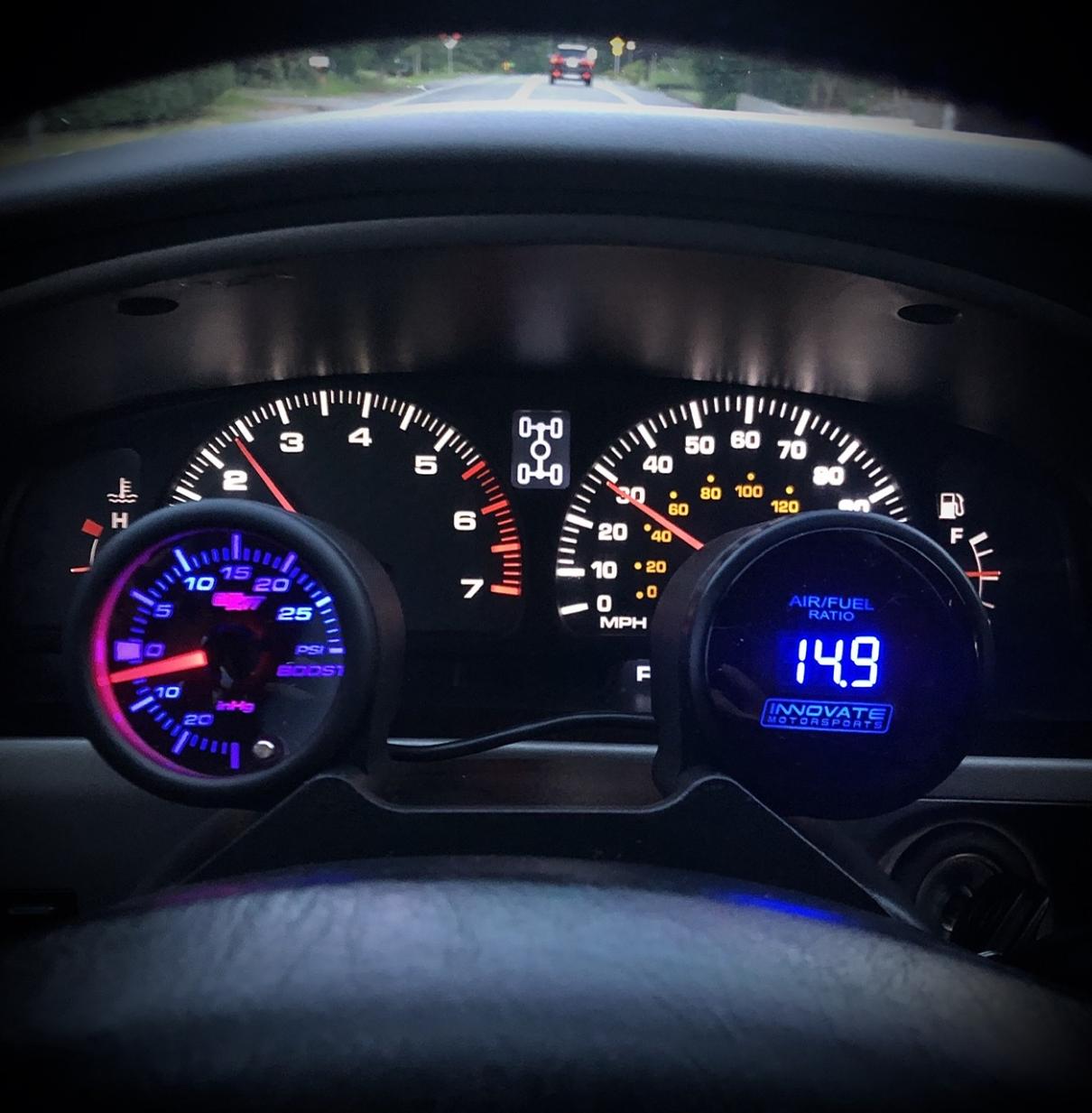

-Innovate wideband O2 sensor and gauge
-Glow shift boost gauge
-Flexpod steering column 52mm gauge holders
-Reseal valve cover

Picked up from Torfab today. Professional. Clean work. Reasonable labor. Highly recommended.
