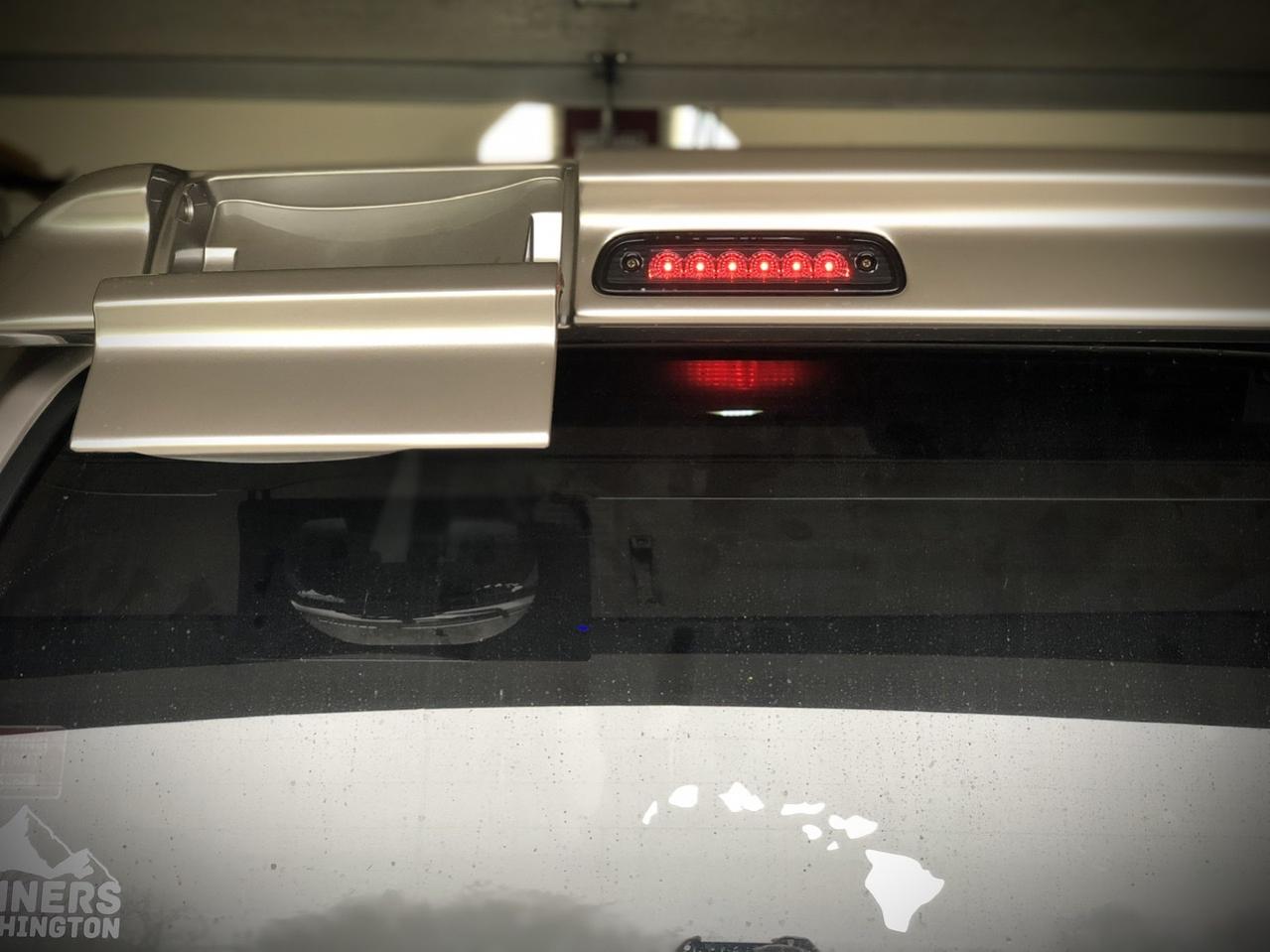

Unicorn installed.
Hilux surf 185 power rear mirror spoiler color matched and mounted. Also mounted smoke led third brake light on the spoiler and a red lens led third brake light on the hatch.

Unicorn acquired. Hilux surf hatch with power rear mirror spoiler.
Haha...I have the same hatch sitting in my parents garage. Never finished installing it before I sold my runner. It came from your neck of the woods too. I paid a grip just to get it shipped over here too. Nice acquisition though. I like the direction you're taking this build.

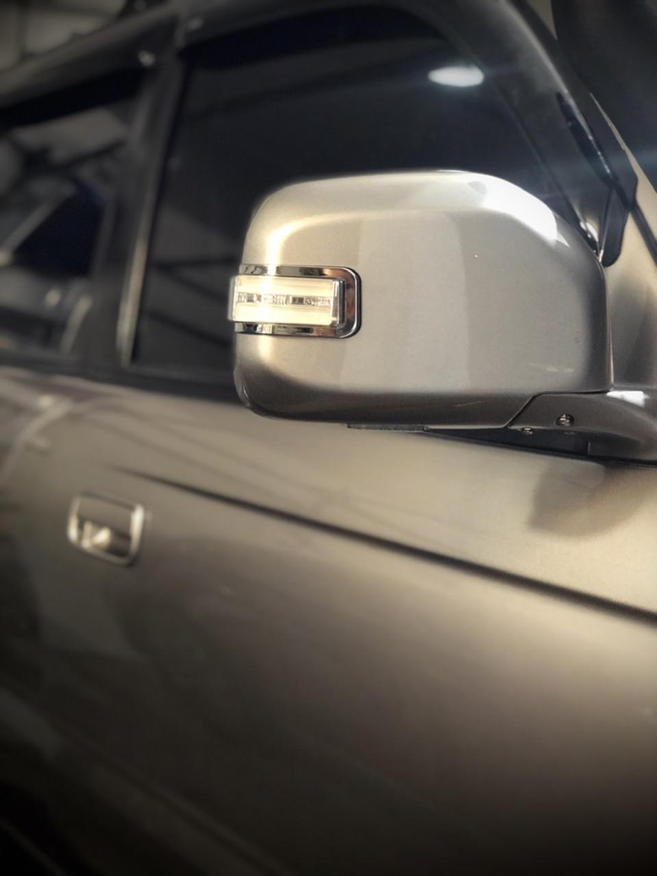

Attempted to install these LED mirrors today... 3h and a bunch of cuss words later the passenger side is on, albeit not yet wired up. The screws holding the internals in are super soft and held in with dabs of lock tight from Toyota. In addition, need to cut OEM harness to get the wires through the grommet and solder back together. Will tint the lenses smoke xpel ultimate when everything is done.

Looks solid. Wouldn’t mind doing that but I don’t know if I want to dedicate 6 hrs to the install. Did the drivers side go faster since you had it figured out? How much time did you spend on the loctite nail removal?
Driver side went faster after learning the ropes on the passenger side. I had to use a drill and screw extractor to get one of the three screws out under the mirror on each side. Also a major time suck was figuring out how to get the wiring through. Eventually fed through the OEM swivel grommet. Not much space and need to be careful with the 20 year old OEM wiring/harness.
Install time is significant but I guess it depends on what you are looking for. Overall the quality is OEM as you would expect to see from a part made in Japan. No time wasted there. Direct fit for the OEM mirror internals once transferred over. Even comes color matched and cleared from factory, (albeit only a handful of colors). The set just adds the LED DRL, turn signals, and puddle lamps. Surprisingly lots of compliments even though only on the truck for a few days. Unique mod instantly recognizable as custom/JDM by 4runner/Tacoma owners. Given the age of the 3rd gen, this part is discontinued. I’m working on bringing a few sets stateside. If interested send me a PM. Obviously once these are gone... gone for good.

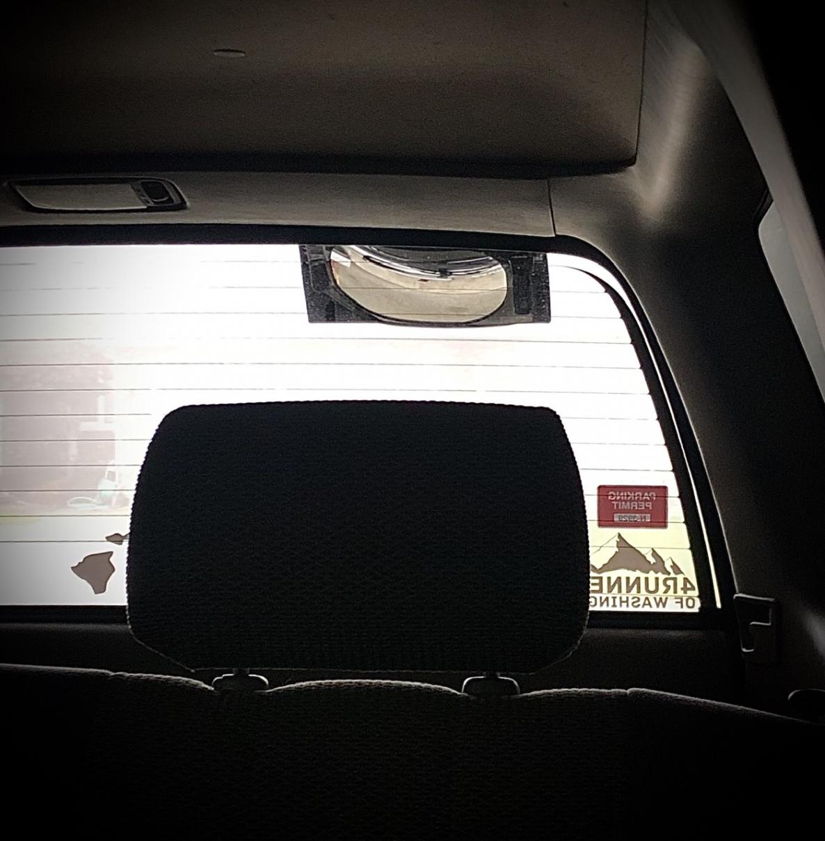

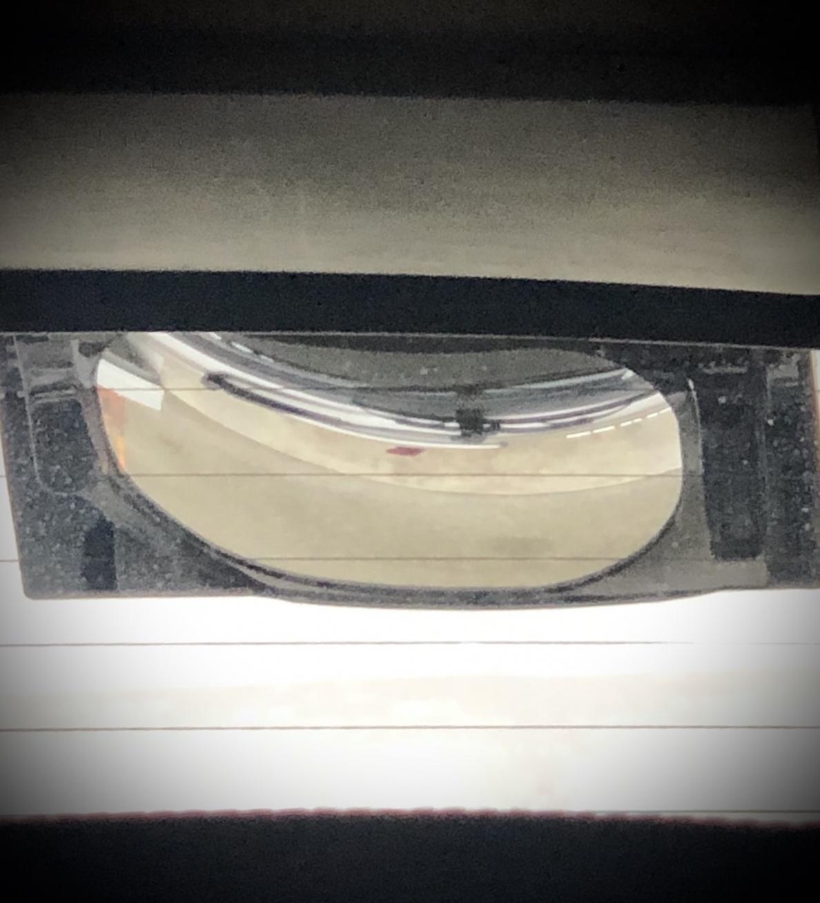

More pics per request.
