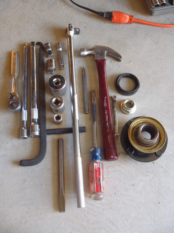

FOUND: Missing nut; where does it go?

Do these look like the nut; see the two horizontal 'through' bolts holding the steering knuckle. Also, consider the shape...
Here's the same strut removed. Check the size of that socket, gotta be at least 21mm.
And a look of the shaft (below), it's huge!

If I recall correctly ...... The nut one replaces after changing out the transfer case seal is pretty big. Its recommended that you replace the nut instead of reusing it. Could have been placed there during the service and forgotten. Assuming the OP 4Runner is 4wd.
Hope this helps ........... 8sm
EDITED.......... Correction
The nut i had in mind is like the one in this photo....however it's 30mm
Photo compliments of bigfishallday
If you go through all the pages of my build thread and look at all of the interior and exterior things I've replaced (a lot of them) I've not encountered a single 21mm nut or bolt (wrench size).
I've found 22mm on the main steering rack bolt, and on the lower control arms I think, 24mm on the upper light racing nut, and even 36mm on my 97 4runner original axles but most everything else has been either 19mm, 17mm, 14mm, 12mm or 10mm.
