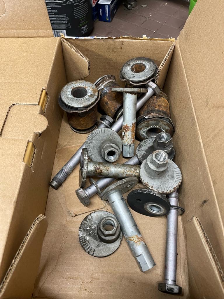

Next up is all of the lower control arm bushes. These weren’t that hard, had the 20 ton press to assist. Lots of banging as the bushings released from their housings. I did heat them up a bit, but ended up not really needing to… 20 tons of pressure is plenty to get them to come loose. Here’s the box of parts that I ended up pulling, all 4 bushings, cams, and bolts.

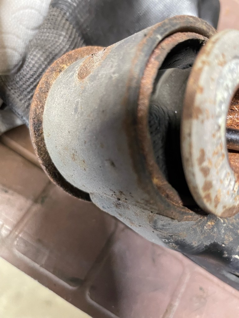

Here’s the rear driver control bushing - I’m not putting a lot of pressure on this, and you can see the cracks in the rubber. This was repeated on the passenger side.
