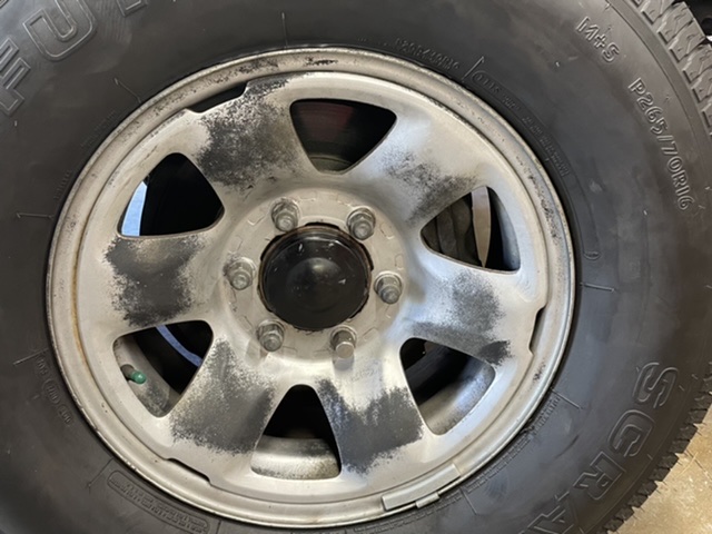

Tundra big brake upgrade, finally. This took care of more of my shaky steering wheel at speed, along with getting my sh*tty tires rebalanced. The tech said that each one was off by more than a gram, yowza.
Doesn’t look half bad, they do clear the stock 16” steel wheels by just a few mm. I can’t upload the photo though, you’ll just have to take my word for it that they clear…

So you used the 199mm wide rotor and the smaller caliper. Or did you use the 231mn with the largest tundra caliper?

This is the 231mm 13WL under stock steel wheels. When I was test fitting them, the wheel was binding up on the inner part of the outer piston housings, nearest the hub. It was as if I needed a 5mm spacer… what could that be… what about the damn brake rotor? Buttoned up with relief, had my son help out with bleeding the brakes. Original brake fluid came out absolutely black. Same with the clutch fluid (which is just DOT 3 brake fluid). Changed that out as well.

Ah they fit in with 16 inch steel rims ok.... The larger ones 231 mm 13WL will not fit 16 inch aluminum's.. I found out the 01 and 02 16 inch aluminum rims have more clearance then the older versions. The 199mm wide smaller tundra calipers will fit the aluminum 16 rims though.. So I was curious how you got the larger ones to fit. The answer is steel vs aluminum is how.. Good to know... Frank is moving along and looking good. :-)
They fit, but only just, literally a couple mm or so. On my prior 01 4Runner, they also fit nicely but close under the stock 16" aluminum wheels. If I recall it was super close to the inside of the wheel, so no stick-em wheel weights to balance as they'd hit the caliper if not placed just so.
Interesting. As I know the last 2 years are slightly different. As my 01 sport rims fit my 09 Tocuma. While my 97 98 aluminum rims will not clear the tocuma calipers.. I found this out the hard way.. ;)
