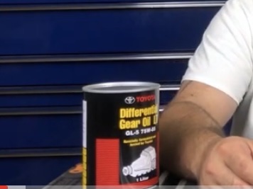

A Toyota Master Diagnostic Technician talks about differential and transfer case oil here How to maintain your Toyota Part 4 Differential fluid, Wipers and AC service - YouTube ... He recommends the expensive stuff for 2005-2009 Tacoma limited slip differentials at time 2:10, everything else gets bulk gear oil, time 3:15 to 5:10.

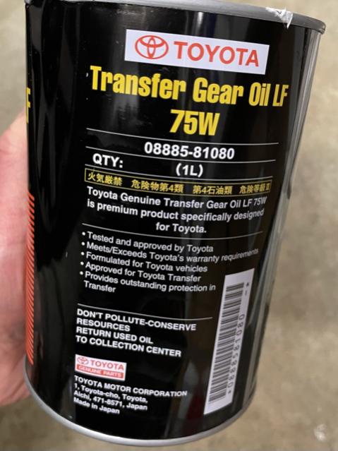

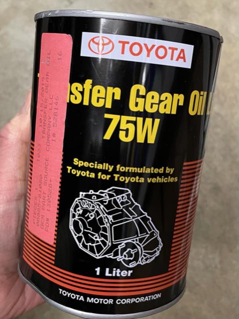

But did I miss something about the transfer case oil? He talks about gear oil and shows the can. Yeah, I agree that there’s no need for Toyota branded oil for your diffs, there’s lots of good synthetic gear oils on the market. But the big “controversy” is about the special Toyota 75 W transfer case oil. Different fluid from what he showed.
At time 0:40 the topic is introduced as differential AND transfer case fluids in both text and words.
