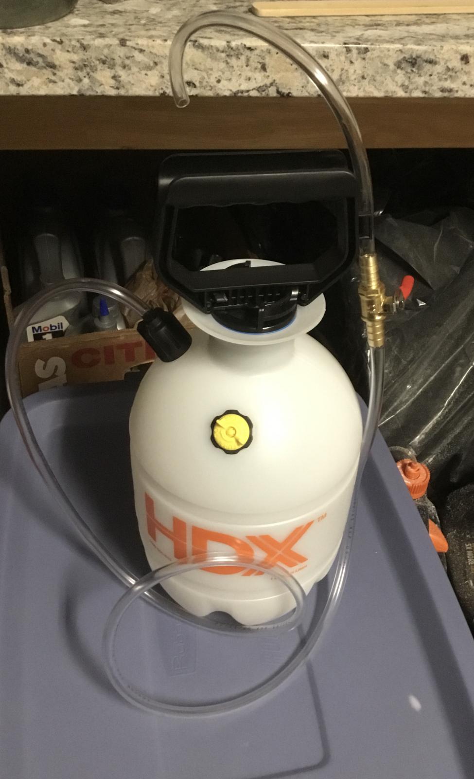

I ended up getting a one gallon sprayer at Home Depot this morning for $10. You don’t need to modify it at all to use as a fluid pump, just remove the spray nozzle for faster delivery. You can either clamp the hose or turn the relief valve to stop pumping. I replaced the black heavy duty tubing with 6ft of 1/4”ID 3/8”OD clear. Testing with water it pumped a liter in less than 30 seconds with 10 pumps.

I'm curious to see how well it pumps thick gear oil. I feel like it's going to take quite a while but you never know.

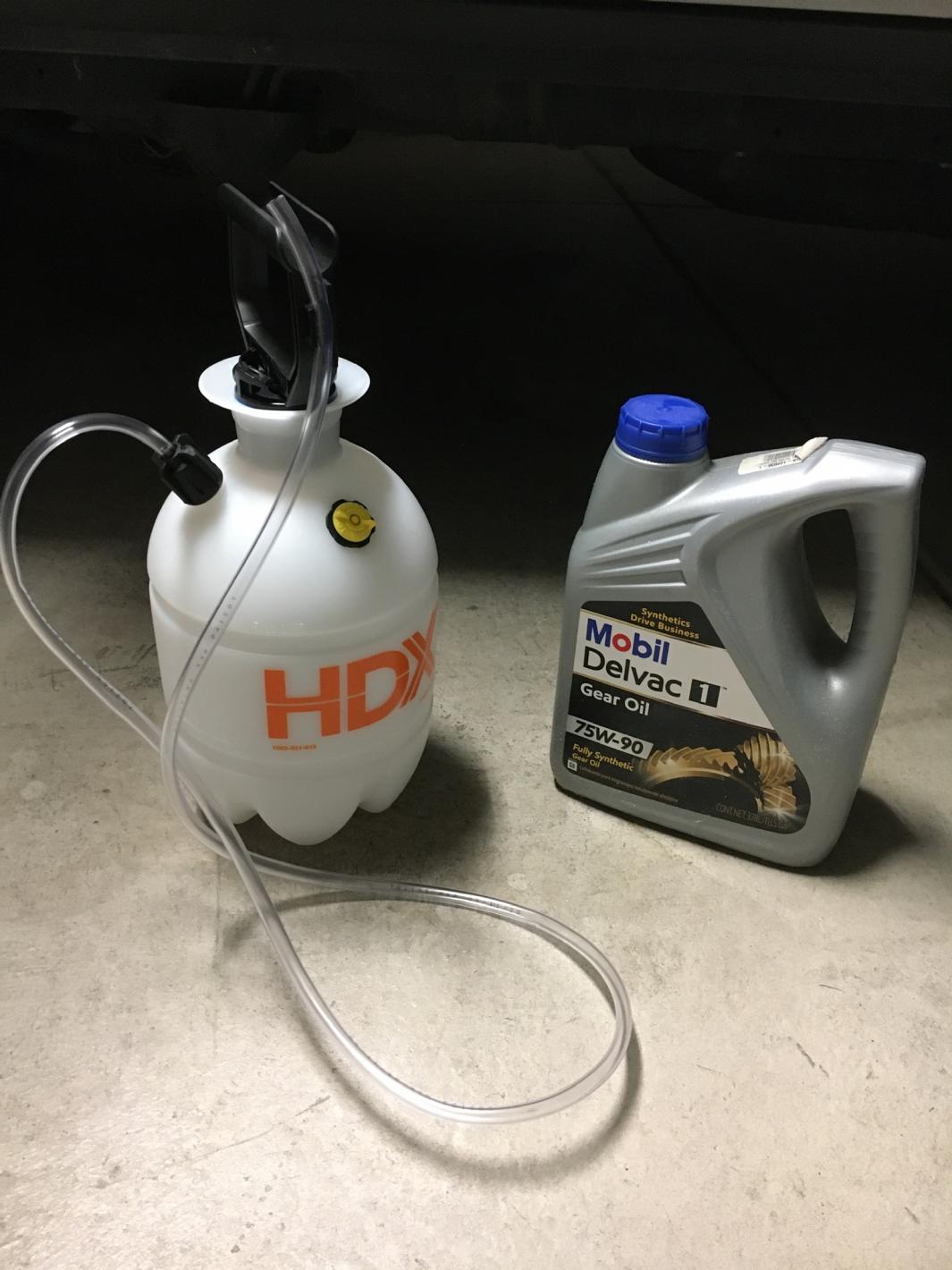

I added a 3/8” ball valve and tested my oil pump today with 2 qts of Delvac 75w-90. First I pumped the tank 30 times then another 10 halfway through. Took a little over 3 mins to transfer the oil back into its container. Only a few oz get leftover in the tank. I plan to use this pump only for gear oil so I left it in there. This thing gonna work great for the diffs and transfer case.
