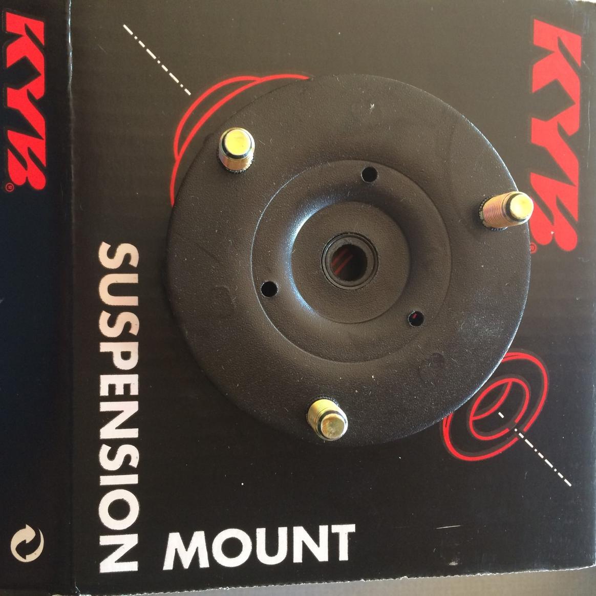

Really I should be RAILING at YOU!! If I recall YOU are the reason I went with the 5100's. LOL...just joking brother...just joking. I wish I had opened the 4600's as that would have helped me REALIZE...I was about to get Hit in the Shi%$# by Bilstein. Any way some good news today about my suspension....yep the UPS guy shows up with some parts.
AMAZINGLY ALL OF THE NEEDED PARTS ARE PROVIDED BY KYB!! OK...I think I will stop kicking this dog for a few hours.

Wheelers Off Road has a full kit....cost me $28 delivered....my local NAPA told me they could not get the parts separate "BECAUSE THEY ALWAYS COME WITH NEW SHOCKS"!!!!. Just for reference.

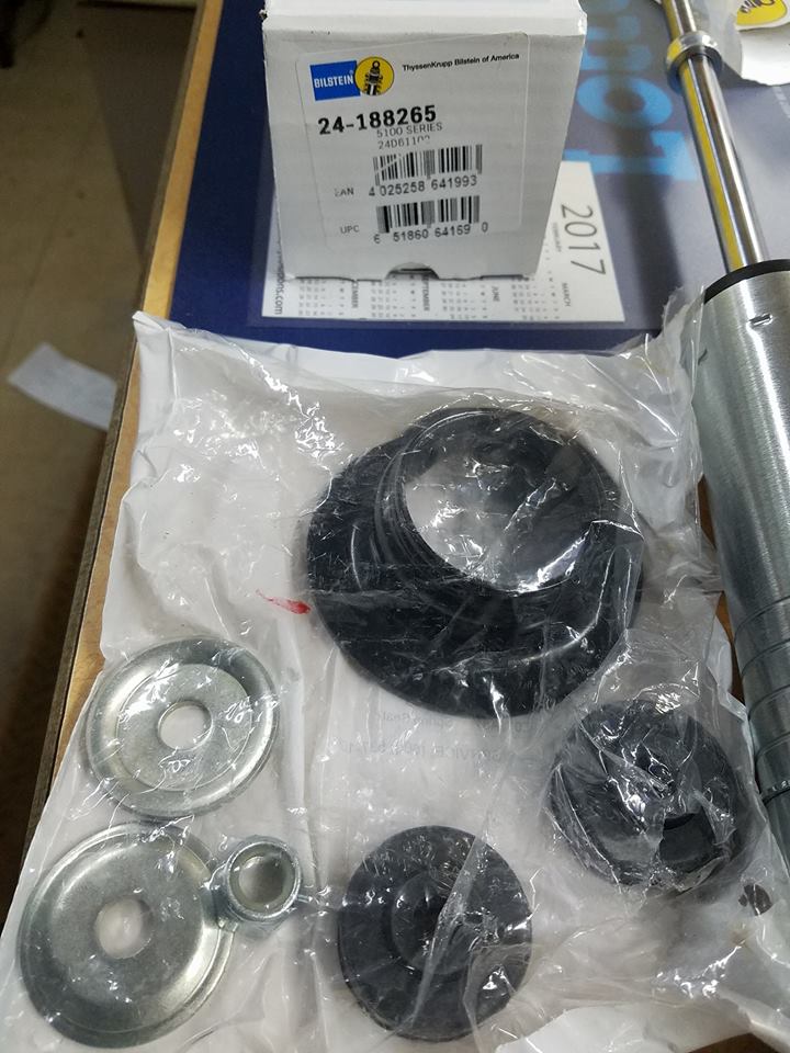

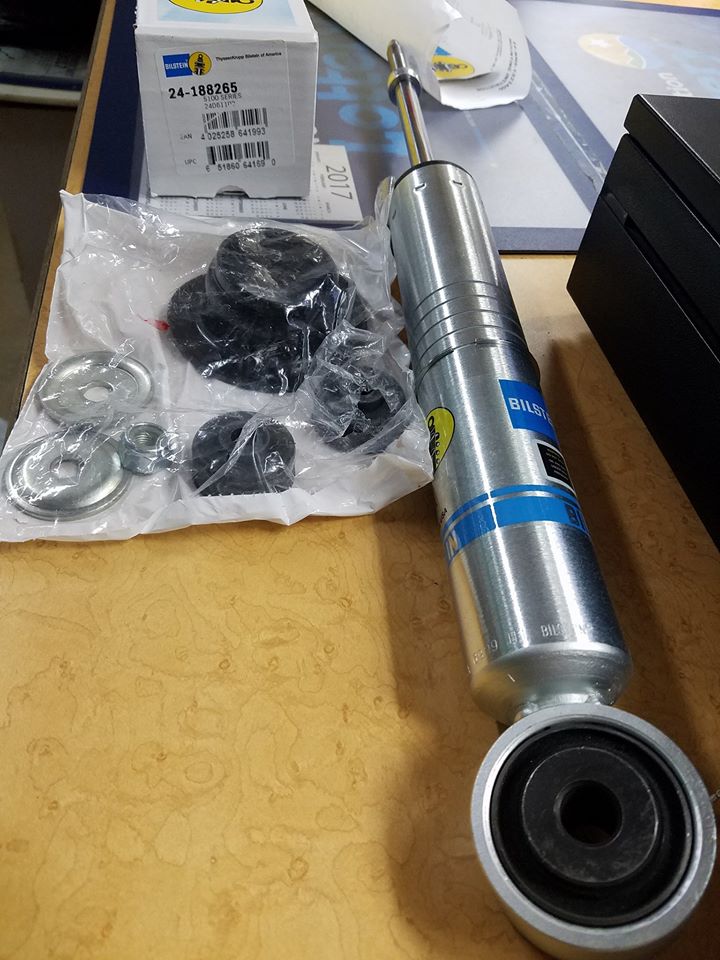

so i just got my front billy 5100 and they came with everything got them from [MENTION=87036]YotaDan[/MENTION] at wheelers off-road.
they are the tundra ones tho offered under 3rd gen t4r

That right there just reinforces how F'd up Bilstein is. I'm glad you got the expected parts....not wasting my time calling Bilstein back as I know their reply. I would get more information and justification from a bum on Skid Row. Happy for you but even more pissed at Bilstein for everyone else.
yes just looking back where i got mine this set in this link clearly says it doesn't come with the hardware and you need to reuse the stock stuff
https://wheelersoffroad.com/product...tein-5100-height-adjustable-front-shock-pair/
now these are the one i ordered from wheelers and they show the hard ware in the pics and came with it
https://wheelersoffroad.com/product...-adjustable-front-strut-set-for-99-06-tundra/
and for those that need the hardware its $20 from wheelers
https://wheelersoffroad.com/product...ein-138992/strut-stem-cushion-and-washer-kit/
You got the old 5100 for the Tundra 1999-2006 maybe that's why it came with the needed hardware.
FYI, the updated version of that shock is 24-261425. It is shorter by about 1/3 of an inch compared to 24-188265. There are other differences which Bilstein hasn't disclosed.
