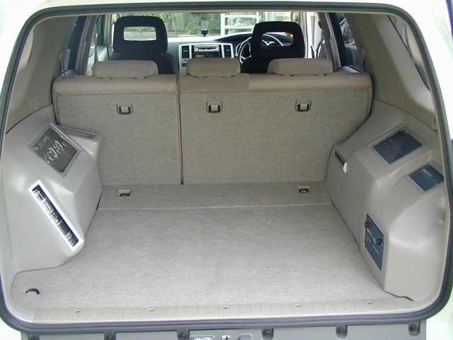

it appears from your pics that you found adapters to plug in to the OEM harness and then mated those leads with the HU wiring. Is this so? I assume you also had a JBL 6-disk HU....I didn't think anyone made these adapters for the JBL setup
Dude, I had the single disc toyota HU with no JBL. I just bought the standard Toyota wire harness and it worked perfectly. I can't help you if you have the 6-disc version. Sorry.

If you don't mind me asking, how tall is your false floor? Was that enough room to mount everything, or do you wish you made it taller?
I'll check today, but my first guess would be around 4". You can look at the pics to get a good idea of the height...just look at the front tie down loops or the wheel covers.
There is plenty of room because as you could see, all of my cables were secured to the underside of the box/floor. The only free cables are the two from the DSP to the HU.

Can you explain the role of the DSP unit? I have seen people use them to take a 2 channel source and synthisize a 5.1 sound, but you apparantly are not doing that. Is that an optical connection (or some other special cable?) between the HU and the DSP, or did it need 4 RCAs?

As for the install, my DSP (digital sound processor) performs the same function a home stereo DSP does. In my specific case, it accepts the encoded audio bitsteam from my head unit then decodes it to provide either Dolby Digital, DTS, Dolby Surround standard 2-channel audio to my amps. The audio then travels via short RCA interconnects to the amps. It also provides almost 5v of audio power versus 2 from head unit, which helps provide the cleanest signal to my amps. The fiber cable, came with the DSP, but aside from the connectors is no different than the fiber you may use on your home DVD player.
