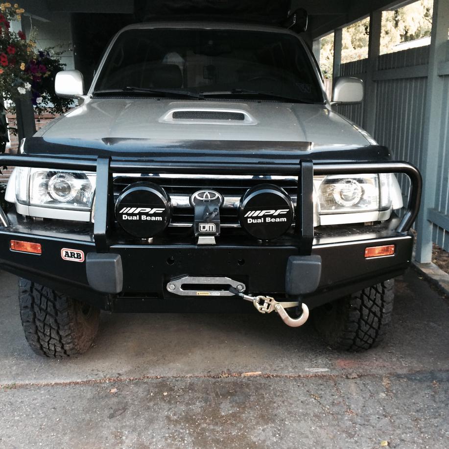

Here is a quick picture of the finished product on my rig. I'll get more pictures tomorrow as well as light output photos. These things turned out amazing, can't wait to drive it at night! Thanks Alex!
Thanks man, really glad you're happy with them. Stoked for the output shots.

So, after what seemed like the longest 4 hour drive, Alex showed up at my staged and ready 4Runner to upgrade the dreaded lights. I would like to say I installed them :lie: but I'd be lying. In a effort to save me from more pain Alex kindly installed the lights and helped with lining them up correctly. Really, I can't thank him enough, without his help I would have been forced to wait till my back fusion healed and that would have been hell.
To anyone on the fence about this mod, I only can say how amazing it was to drive for the first time at night and actually be able to clearly see EVERYTHING!!!
