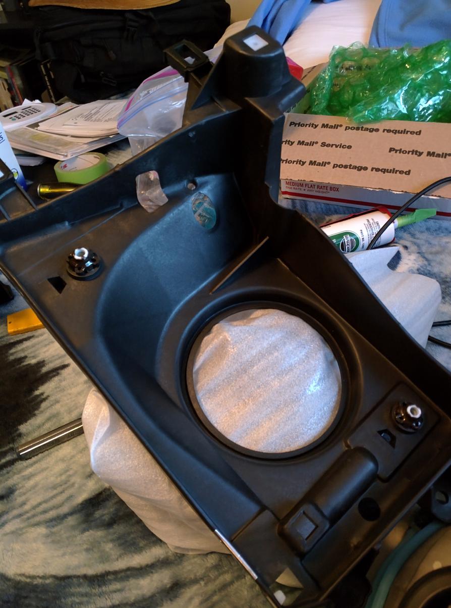

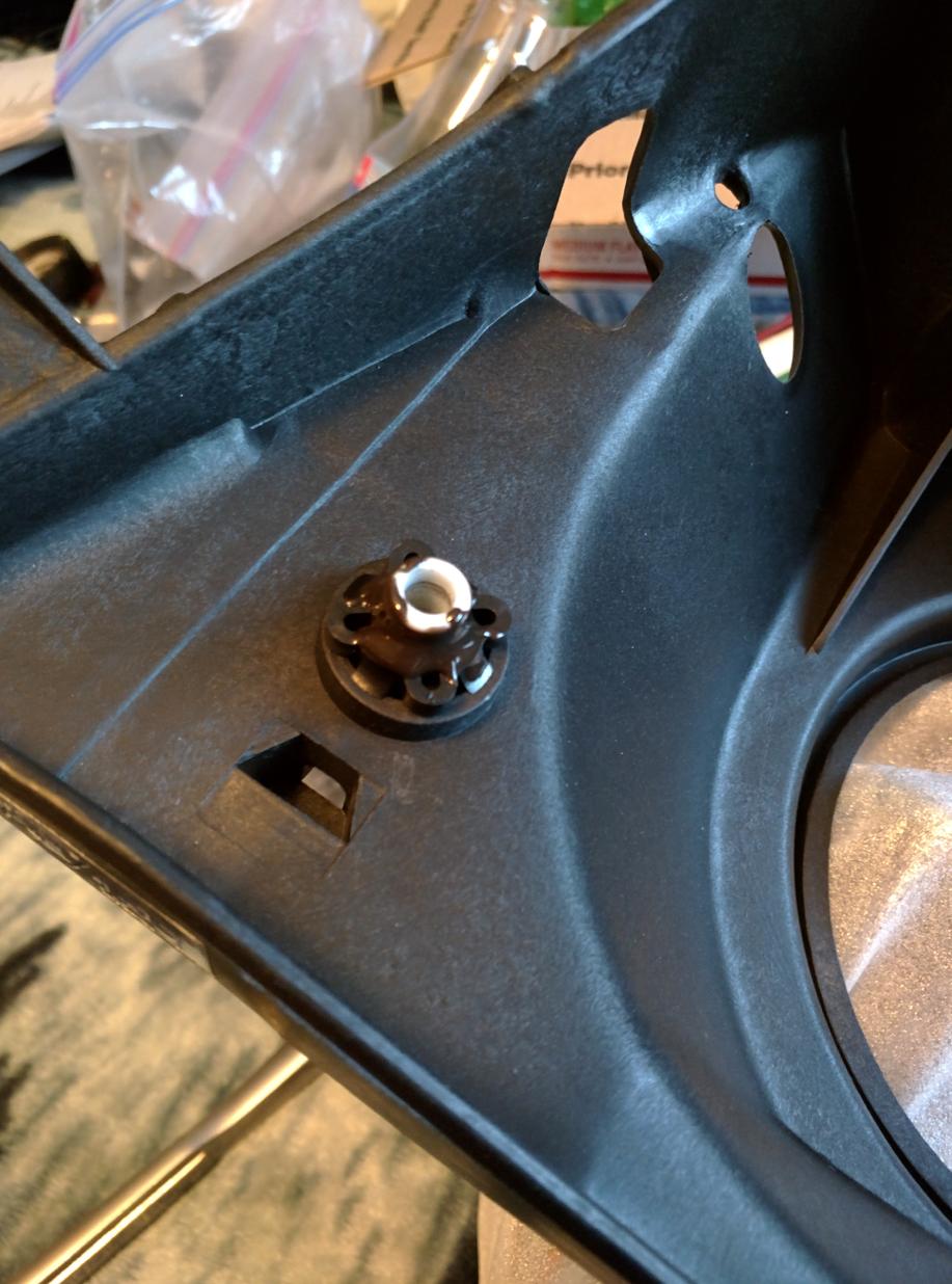

They shouldn't be aimed far far downward. I think what happened is the TYC white/black plastic adjustment shroud came apart. It's cheap material. It happened to me on 2 sets of lights.
Here is how you fix it. If it ever happens to you in the future.
* remove light from the Truck
* look at the white adjustment piece of plastic
* it should look right and not like it's falling apart
* if it came apart you need to remove the entire black adjustment plastic. Don't worry, it takes 5 minds and you don't open the actual glass light
* use needle noise pliers, and 10mm socket, use the pliers on the spring and on the square plastic clip, look closely at the square. Disassemble.
* now look at the white plastic screw driver driven adjustment piece.
* snap it back together
* clean both with alcohol
* very careful add JBWeld so it stays together for all time
* do not glue the 2 spinning parts to the black base piece. You want to glue to white and black spinning parts together but in a way that allows them to still spin.
* let it dry overnight (even with quick JB I still give it 6 hours)
See pictures for reference.
