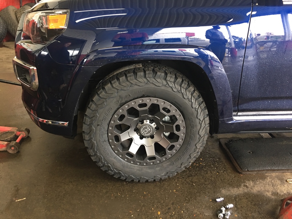

Quick question. I'm at Les Schwab right now doing a test fit of my new tires and wheels on my 2016 limited. They ordered +12mm offset even though I mentioned negative offset and was wondering what to look for other than rubbing the uca
Going with 285/65-18 on black rhino warlord 9" wheels with +12 offset
Lift is ordered and should be here tomorrow.
Basically is there anything other than uca rub and fender liner rub(haven't pushed them forward yet)?
Lift is a toytec boss ultimate with boss 2.5 upgrade on Front
Thanks!
Ok it rubs really bad in the front and on the mud flap. Should have went out in the rain last night and did the mod. Good news is that it is about 1.5-2" from touching the uca.
Think I will be ok after the fender mod, or should I wait until I put the lift on also?
