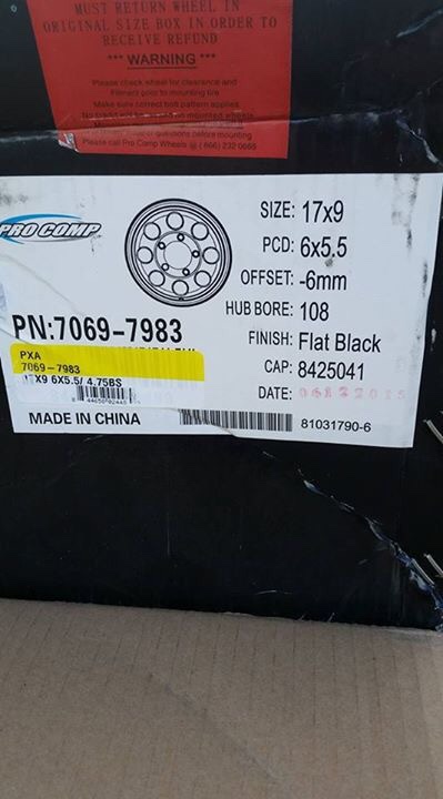

Does this wheel fit with a 2.5 inch lift on a 2011 sr5
