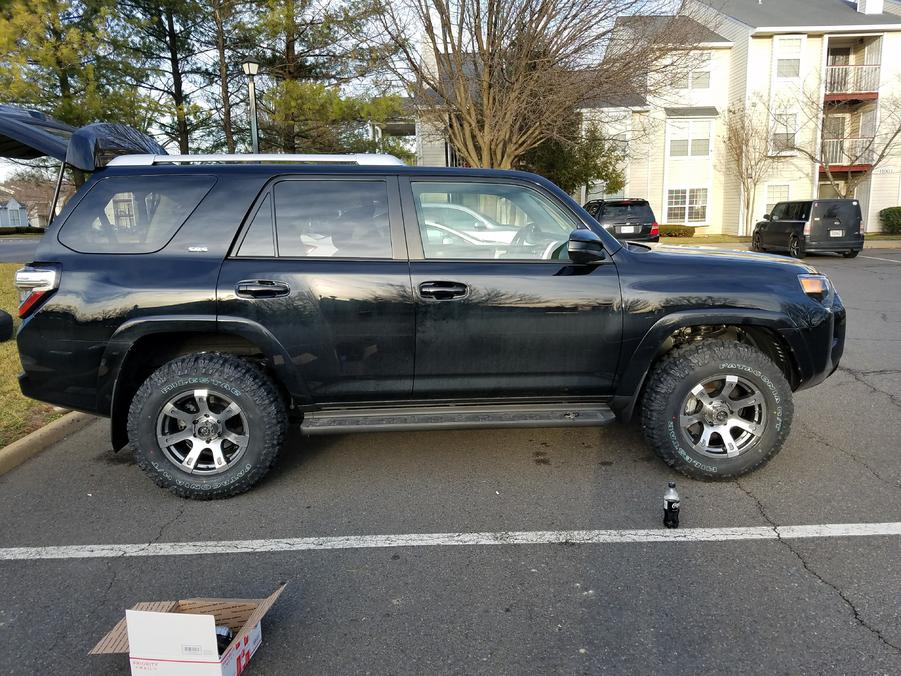

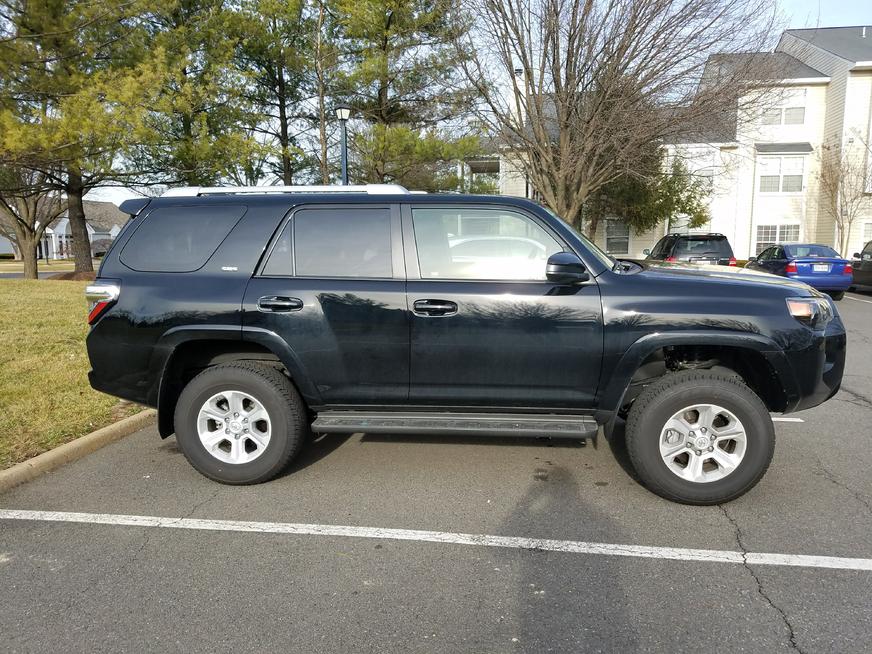

Coming from the jeep world tire fitment is not a big deal, but just wanted to stay for all the post and putting this together. Helped alot. stayed with stock 265/70r17. Milestar MT
Read through the majority of this thread and seems like the consensus is:
If I have a 2017 4Runner TRD Pro and use the stock rims and suspension, I should be all good with no rub with BFG KO2s in 275/70/17.
Am I crazy?

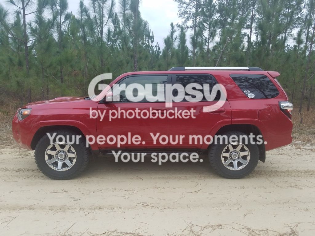

For anyone curious: i replaced by stock dunlops with Cooper ST Maxx 255/75 17s.
I'd always been curious as i found very little information on their true size (mounted or not). Just measured mine in the garage, on the vehicle. It right around 30.75-31" Stock dunlops measured right at 30.5" in the same spot. so they are ever so slightly taller. I was very close to getting the 255/80s, but the extra weight and e-rating scared me off.
As noted in reviews, they are very quiet for AT tires. They are slightly louder than the originals, but that's to be expected. Mine balanced right out. They also handle more light AT tires. Steering is lighter, a bit more "flighty".
Checked my speedo verses the waze app on an iphone and my garmin 60scx gps. Both now show the speedo only being 1mph high at 70mph.
I'm happy, i was looking for a tire a bit taller than the OEM, but keep the speedo correct (as can be), the ride compliant and my gas mileage (will see, but from the looks so far, it's fine).
