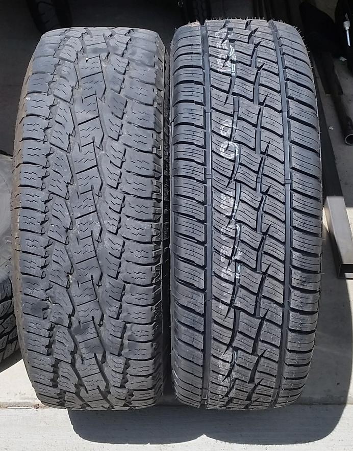

Finally got my tires mounted and installed. 275/60/20 Cooper Discovery H/T Plus on Limited 20" wheels.
The intent was for a set of street tires. For that they're great at first drive. Super quiet and smooth on the highway. Like the OEM tires, but 33" tall. No rubbing so far - I have trimmed mud flaps but untrimmed bumper and no BMC.
They're a bit taller and narrower than 285/70/17 Toyo AT2s I will keep as trail tires on the OEM wheels.
The Limited wheels are kinda odd in that they measure close to 7.5" wide (inside bead seat to bead seat) but are stamped as a 7.0 width wheel. Not sure what's up with that. Also they do sit a bit further out than the Trail wheels.
Oh - and $400 for wheels and the tires were from Amazon for $124 ea. $60 to mount and balance and $30 for a 2nd set of TPMS. Haven't bough a programmer yet.
If then had more street tread tires in a 33ish size for 17's I'd rather have 17's for comfort. Like a street tread 255/80/17. But these are as close as I could get.

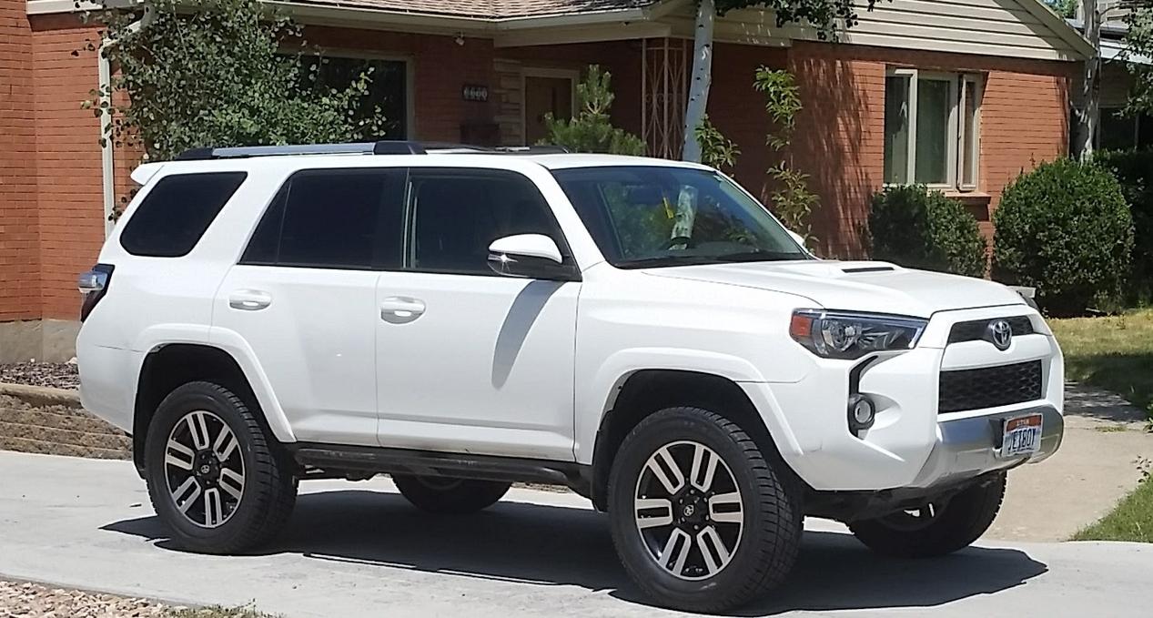

Minor rubbing on front fender liner and mud flap. Not the end of the world, just unexpected.
Take out the 2 bolts on the bottom front of the liner where it meets the bumper. Push the liner forward, put the bolts back in. Then have an alignment done and get 1* caster, rubbing likely solved. I ran a 285/70/17 with no lift and had zero rubbing on the bumper unless I was at full lock in reverse only. I'm now lifted but still, you shouldn't have rubbing unless you have some deep wheels. Can you post a picture? Pictures in mine before the lift.
