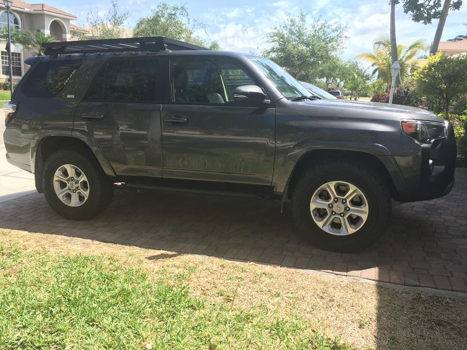

Even 275's will fit without rubbing. Just installed 275 70r 17 LRC Cooper AT3.
Stock wheels = No rub with 275's.
