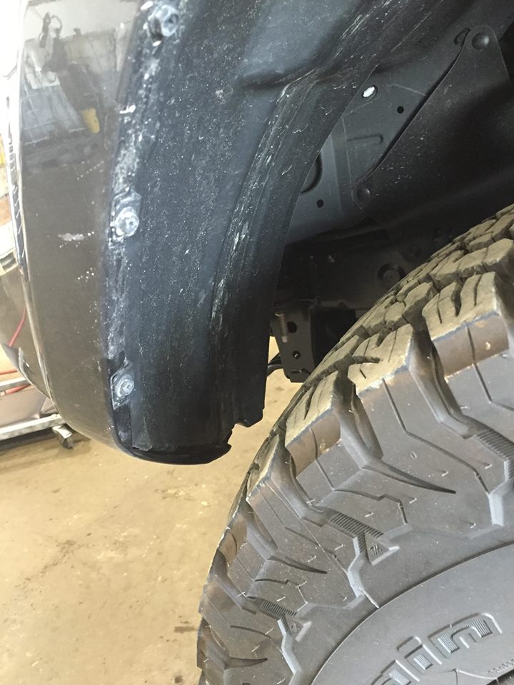

285/70/17 with no lift - Rubs a little. Trimmed front edge of bumper and rubs a bit on the mud flap. Easily fixable.

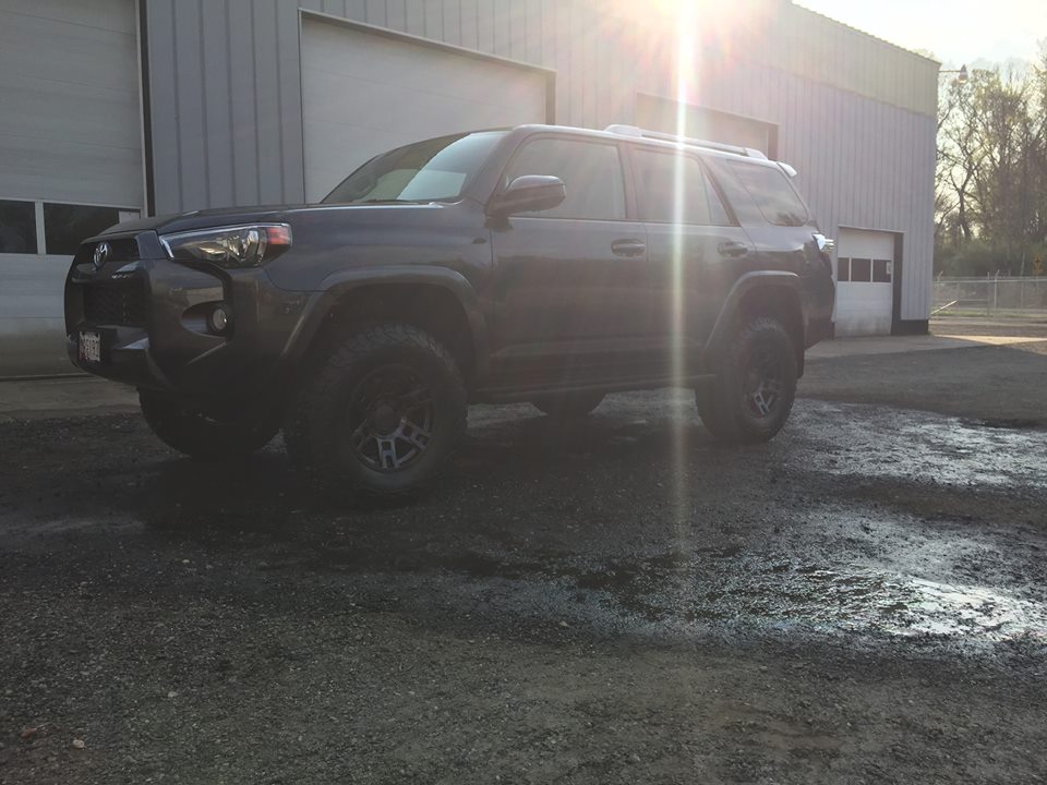

I did the exact same thing with mine. Removed the front mud flaps which I hated anyway. Didn't want to trim so I installed a 3" ToyTec lift. Guess what? Still had to trim the exact same spot I would have if I didn't lift it.

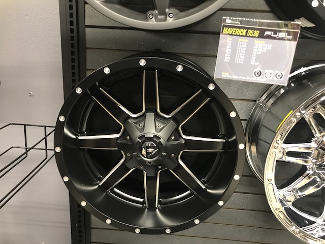

Want to change to 275 65 18's using a Fuel Maverick Rim 18X9.

What Offset so that tire will tuck under fender. I do not want it to be outside.

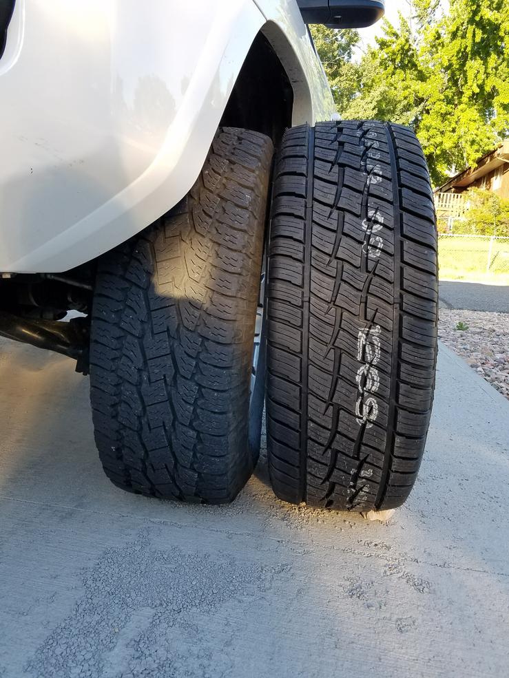

Just bought some Cooper HT Plus for street tires. Next to my Toyo AT2's - kinda hard to say the Cooper HT Plus aren't pretty darn close to the AT2's in terms of being an all terrain tire. I was hoping for a bit more "street" tire since I'll have a mud tire on the other wheels. I'll update with a review once I get them mounted and put some miles on them. The AT's are almost worn out at 20k miles.
AT2's are 285/70/17 and the HT Plus are 275/60/20.
