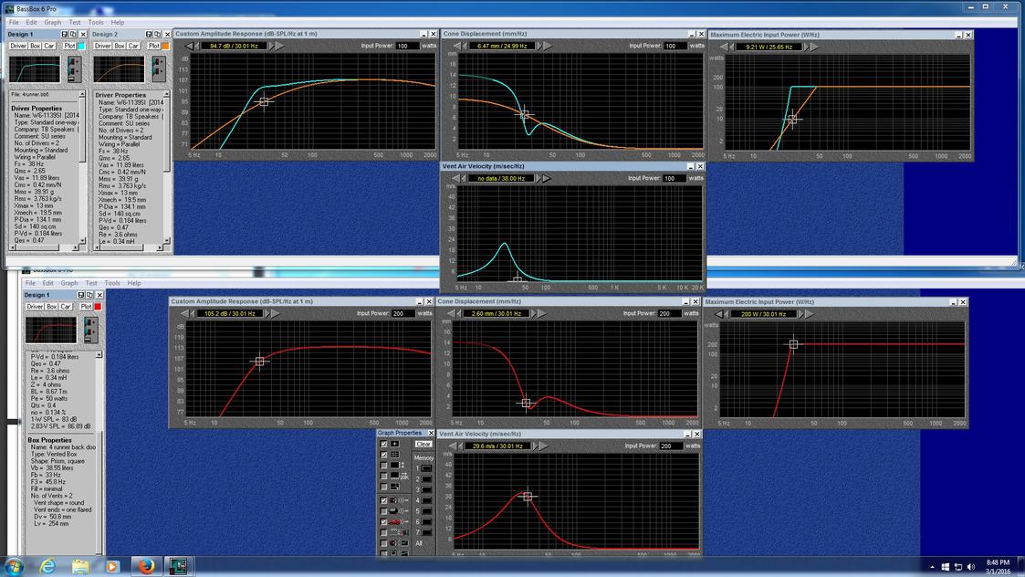

Ok here we go. TB6" drivers granted these are not really sub woofers but do perform really well for there size.
However I have used these in a home application he had 10 of these on each side of his big projector screen in a vented enclosure and could go all the way to 15Hz with out over excursion or thermal. it could cause physical pain at the main viewing position we got his system to hit 134dB at 35 hz.
ok on to 4 runner application
all numbers do not include "cabin gain" effects
The Orange graph is for one TB6 in each hatch location in a very large enclosure modeled as very Leaky
Typical roll off for this situation 100 watts RMS ( 50 each) down to about 48hz falling to about 18 watts at 30 hz
cone excursion is good across the board
amplitude is at 100 watts rms but abvisouly head unit will not put out this much power at these Fq
Blue graph is same as orange but with a true enclosure and vented.
No to bad for a dual 6" setup. a light fiberglass box could be built like this and attached to door.
thermally/electrically good at 100 watts RMS all the way down to 25Hz
Above 28Hz +100dB not to bad for 2 6" drivers
REd graph is 4 TB6" in vented enclsoure. If you are gogin to build a box for 2 ( blue graph) might as well go for 4 right
200watts capable all the way down to 30 hz
105 dB at 30 hz
Again not a "super sub" so not going to be able to produce lots of DB below Fs ( unless you are using a lot of them)
Cone will never over drive in any case shown

I don't think you could fabricate a box to fit in the hatch and still be able to roll down the window. And without a box, there is enough hardware in the hatch that it would rattle way to much for those drivers to ever work and sound decent.
The "real" enclosure would be on the front face of the hatch but secured to the metal structure under neath the plastic panel.
I have no doubt i could make auch a box. But unless one is looking fo a trick box that looks oem a small.box secured in the cargo area would be the smpler solution.
"Ok here we go. TB6" drivers granted these are not really sub woofers but do perform really well for there size.
However I have used these in a home application he had 10 of these on each side of his big projector screen in a vented enclosure and could go all the way to 15Hz with out over excursion or thermal. it could cause physical pain at the main viewing position we got his system to hit 134dB at 35 hz... ...Cone will never over drive in any case shown"
Hang on there bro, I'm on your side :hatsoff: lol! ... and no need to defend the driver...
It's the application that will potentially cause SQ problems! What I'm saying to you is, ALL subwoofer drivers depend on their inner chamber's surrounding environment to support the way that they were designed to operate. Heavy bracing in very low freq boxes prevent the cabinet walls from Sympathizing, moving and resonating along with the speaker cone; which will attempt to mimic the low frequency waves generated by the driver.
This condition also creates massive distortion or phase anomalies in close proximity of the driver's backwave. And since there's no legitimate way to seal, brace, or align (port-tune) the rear chamber, there's no way to prevent this destructive behavior. Here are a few good speaker system design website links that you may find helpful in your quest for better sound.

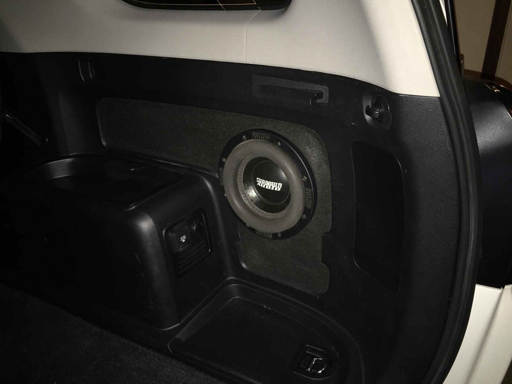

Ok, so I had a sundown 8" sub installed, Rockford amp under the drivers seat. The amp is a PBR300X2. Running 300 watts at 1 ohm and the sub is a Sundown SD....Dropped it of 2 weeks ago and told them it needed done by today. Not happy about remains of the cross bar, but they will fix it when I get back from a short trip
