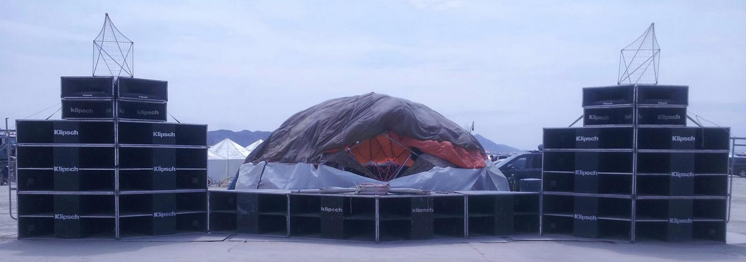

I know. I was just messing with you. I used to use some Klipsch stacks when I was DJ'ing many years ago. 6 stacks, 6 ft wide, 8 ft high. We called it the 36 ft wall of sound. Not very practical for use in a vehicle :doh: unless maybe you hauled a 40 ft. flat bed.
Our setup was similar to this but we used an array of 12 tweeters per stack. The setup came out of Rainbow Music Hall in Denver. They hosted a lot of rock bands in the 70's and 80's like Yes and Black Sabbath.

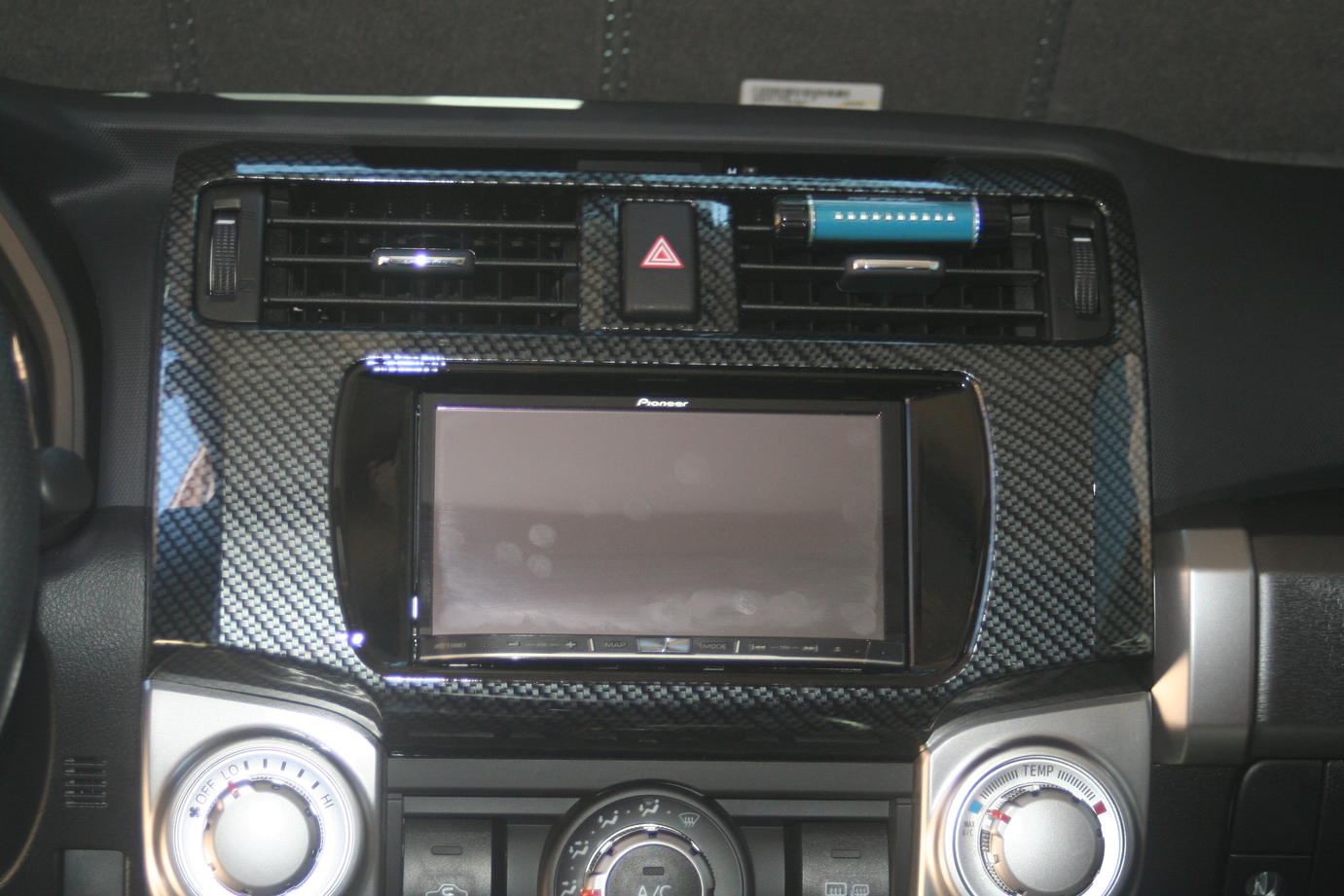

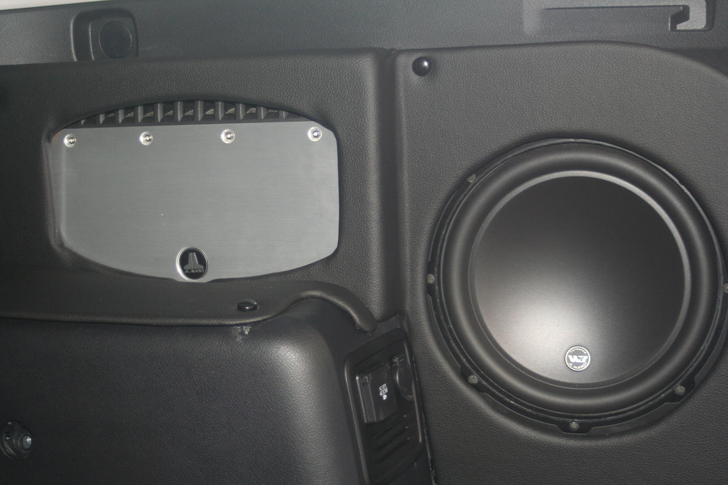

While certainly not in the same league as some in this thread, this setup is working fine for me.
Pioneer Avic 7100NEX
Focal IS 690TOY
JL Audio HX 280/4
JL Audio 500/1
JL Audio 10W3
