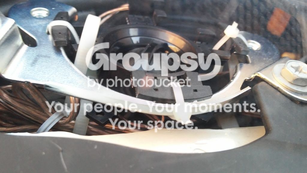

The removal of the ALPINE RUX REMOTE
rigtec-albums-riggy-s+workbench-picture36850-20151114-130703.jpg~original
"The wire portal"

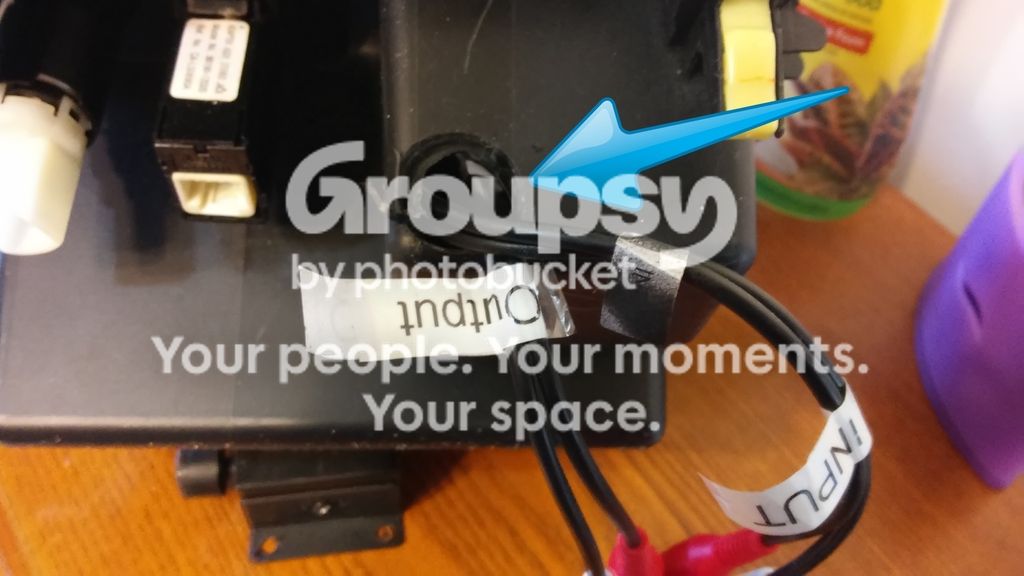

What the above picture shows (@Blue arrow) is that I was not be able to get the new RCA cables into the storage cavity like i did with the telephone line cord, so I had to bore the access port out more using the 'Uni-Bit' below:
rigtec-albums-riggy-s+workbench-picture36857-20151114-133826.jpg~original

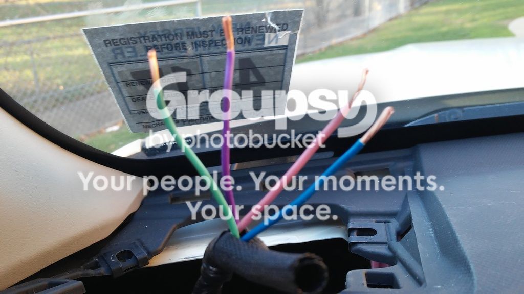

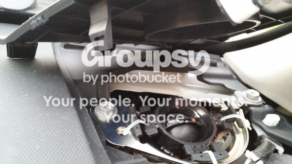

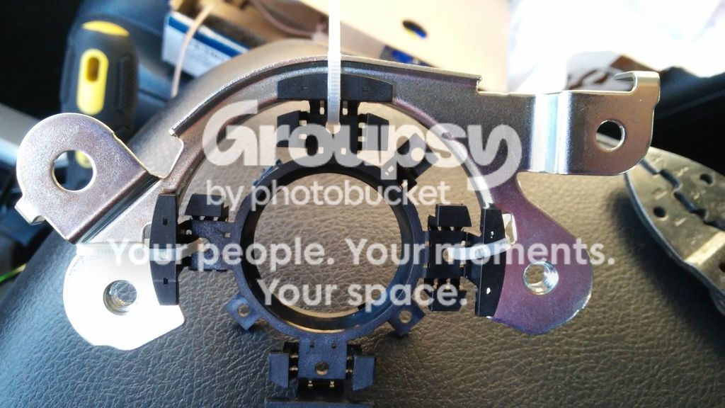

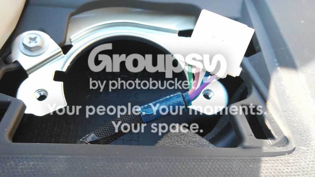

"THE O.E.M. (Uninstall)"
In the photo above you see the oem plug connector that joins the 'Driverside' 3 inch tweeter to the Driverside front door speaker. But the new Alpine driver doesn't have a harness connector plug to support that, so some 'Hokus-pokus' will be needed to make the transition! First we'll chop off that multi-feed connector to simplify things.

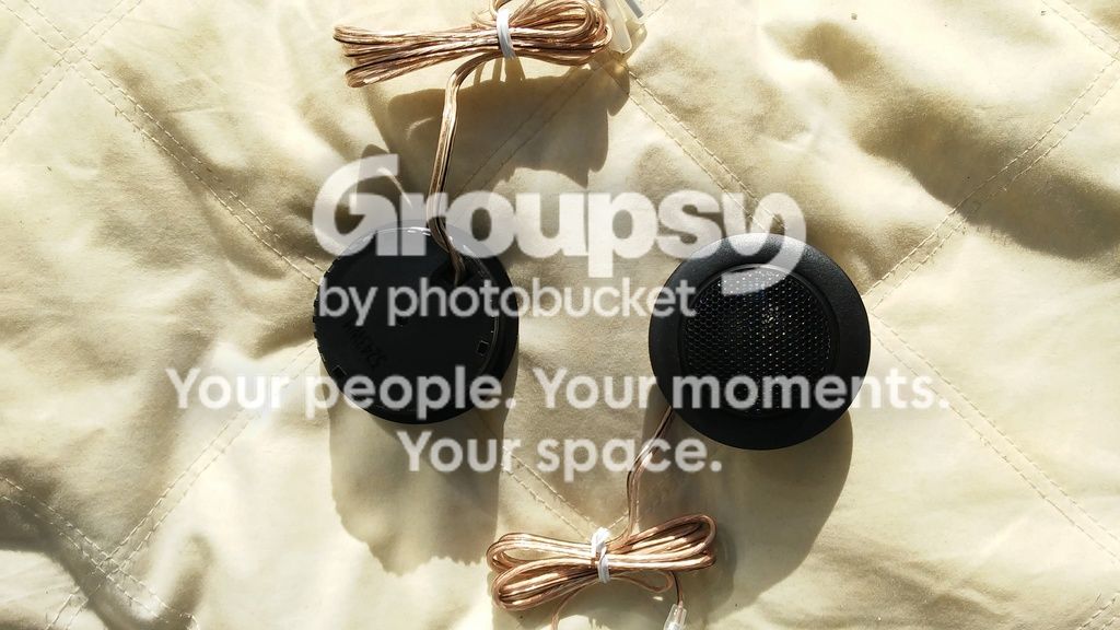

"HARDWARE PREPARATION"
The LT GREEN and BLUE wires are coming from the headunit and feed the tweeter. From there (via a jumper in the speaker harness network), the PINK and PURPLE wires go down to feed the door speakers (in parallel: 4ohms divided by 2 = 2ohms).

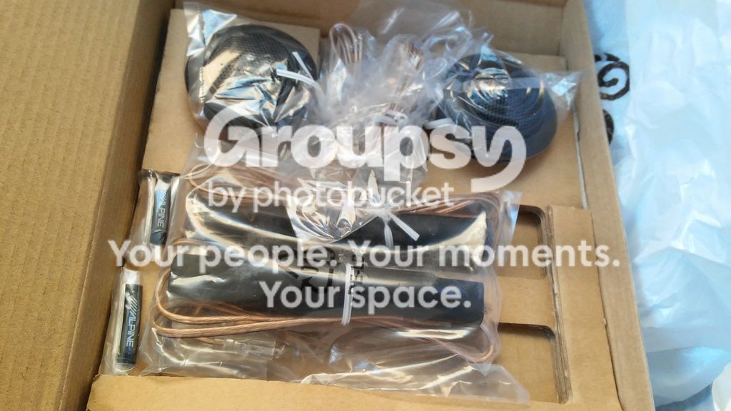

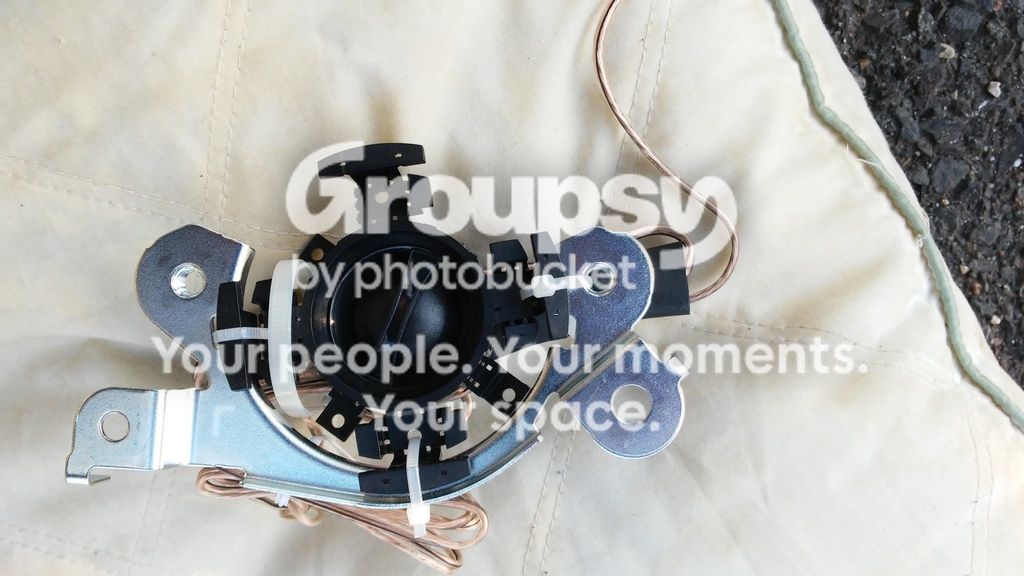

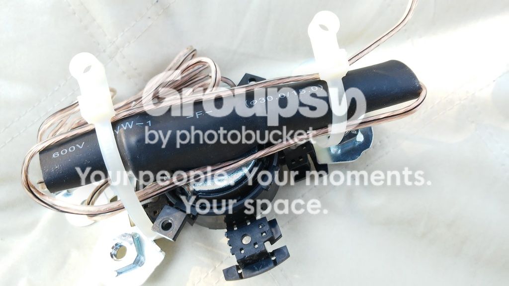

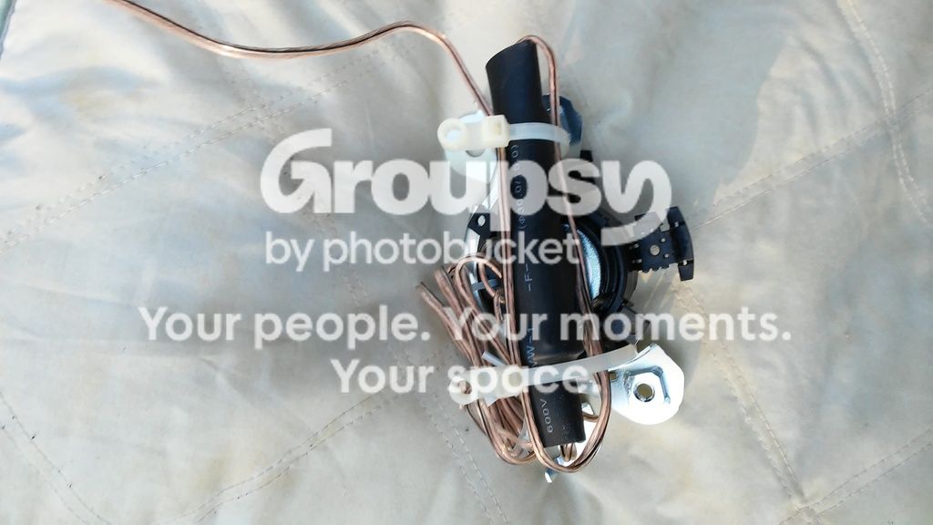

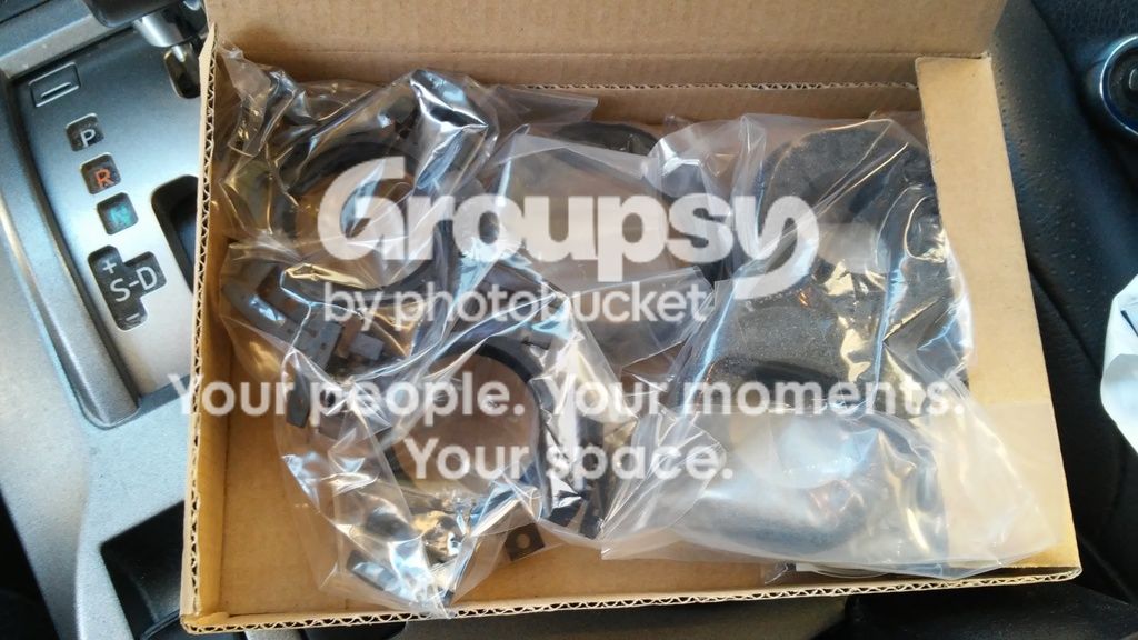

A QUICK ASSESSMENT OF OUR HARDWARE
Since no paperwork came with the driver kit, I'll have to do a 'visual assessment' to know what does what. There really aren't that many relevant parts in the boxes, just a bunch of make-shift (one size fits all) flanges to make it work!

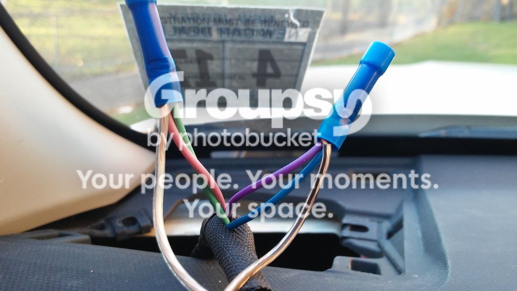

As you can see I've joined the purple wire, the blue wire and the clear wires w/black stripe together. And the LT Green wire, the PINK wire, and the clear wires together as well. When you're doing the wiring it doesn't really matter which wire you choose to be your POSITIVE (+) or NEGATIVE (-) as long as you choose the same colors on both sides. NOTE: The colors on opposite sides (driver-passenger) are identical except on the passenger side, they've replaced the PURPLE wire with a YELLOW wire, so... just remember that YELLOW replaces PURPLE on the passenger side when you're doing your tie-in's!
"THE FINALE"
I hope that this project will be helpful to someone who's considering swapping out your oem dashboard tweeters for something new! Rdgs :yo:

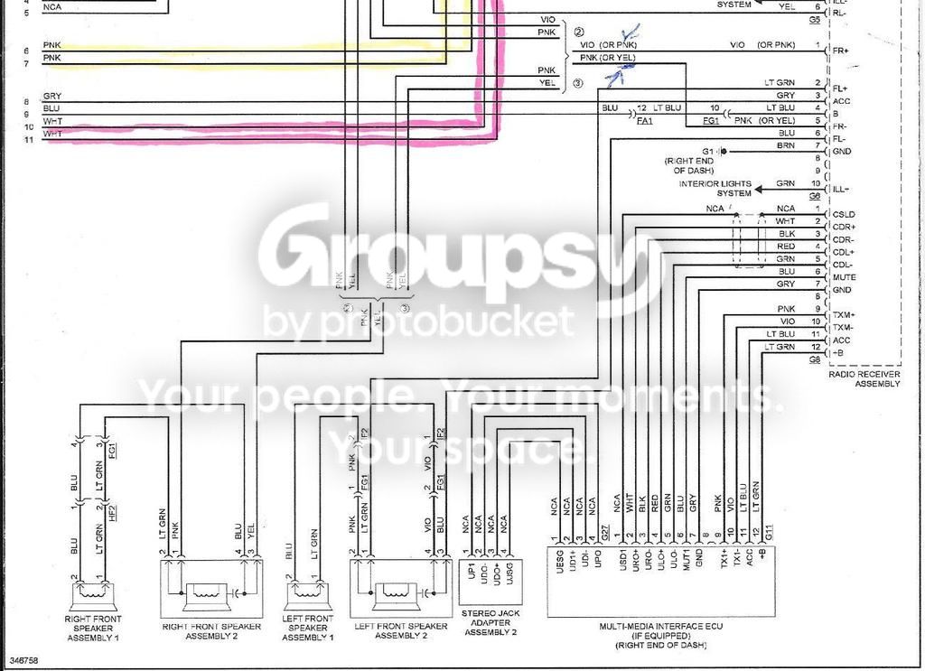

rig (Click here to see front speaker wiring schematic >>>"Front speaker wiring diagram"

Hey team,
After re-reading my last addition to this thread, "got bass", I just thought to put up the Front Dash & Door speaker wiring diag so you could follow it for yourself... "it's amazing the things you can forget to do @3:00am in the morning! :sleep: ...But at least I remembered to take pictures this time lol!" On the left side (driverside), the LT Green is POSITIVE(+) and the Blue is NEGATIVE(-). On the right side (passenger-side), the Pink is POSITIVE(+) and the Yellow is NEGATIVE(-)
...What I said about you having the freedom to decide which wires will go to the positive and negative terminals on the replacement speakers still stands... it don't make a tinkers bit-a-difference; just be consistent regarding the left and right channels or you may create sound anomalies that will degrade the performance of your new speakers!
'Best to you'!
