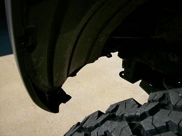

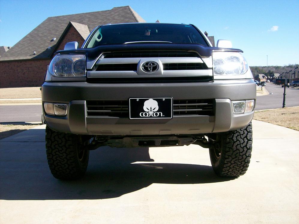

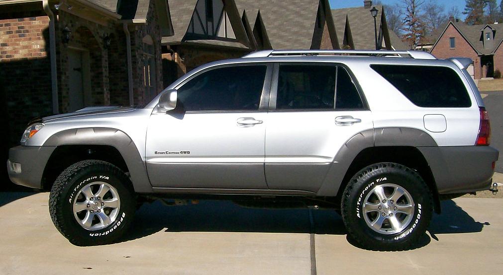

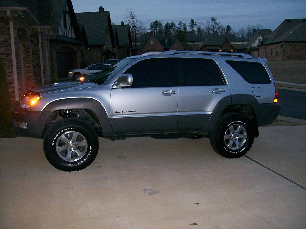

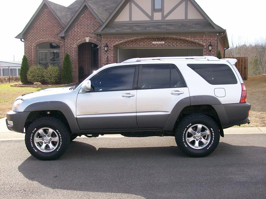

Yes, got 285/70r/17's about a week ago, I love'em. Just a little bit of trimming, took like 2 minutes, just cut straight across the inner fender taking that cup air deflector deal off.The tires only rub at full lock turn and its very minimum with an A/T,I almost got 265's again b/c all the talk of major trimming and wheel spacers to run 285's but from my experience none of that was at all necessary. I am so glad I went with the 285 BFG KO,S.

Looks Great! How is the road noise? MPG's as compared to 265's? At full lock, where does it rub? Looking at the same set up for my runner.
