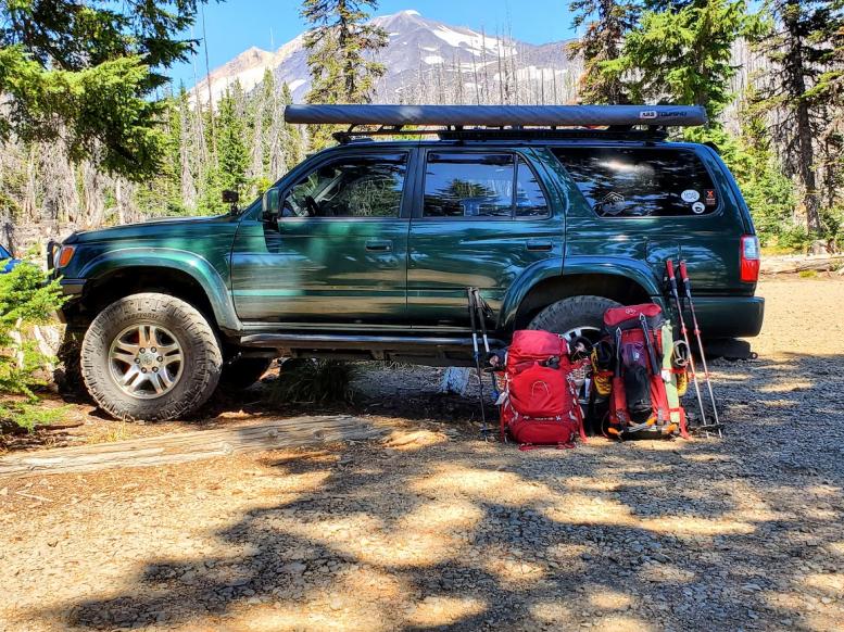

I wouldn't do a thing other than put tires on them. I love mine.

I don't have any answers to that other than you'll have to do your research.
I'm running 3/4" BORA wheel adapters in the front only with blue (medium strength) Loctite. A small bit of trimming on the wheel well liner. It very slightly rubs on the lower part of the frame when off-roading. 285/70R/17's Nitto's on a 2" body lift - Perfect fit. No spacers (adapters) in the rear.
