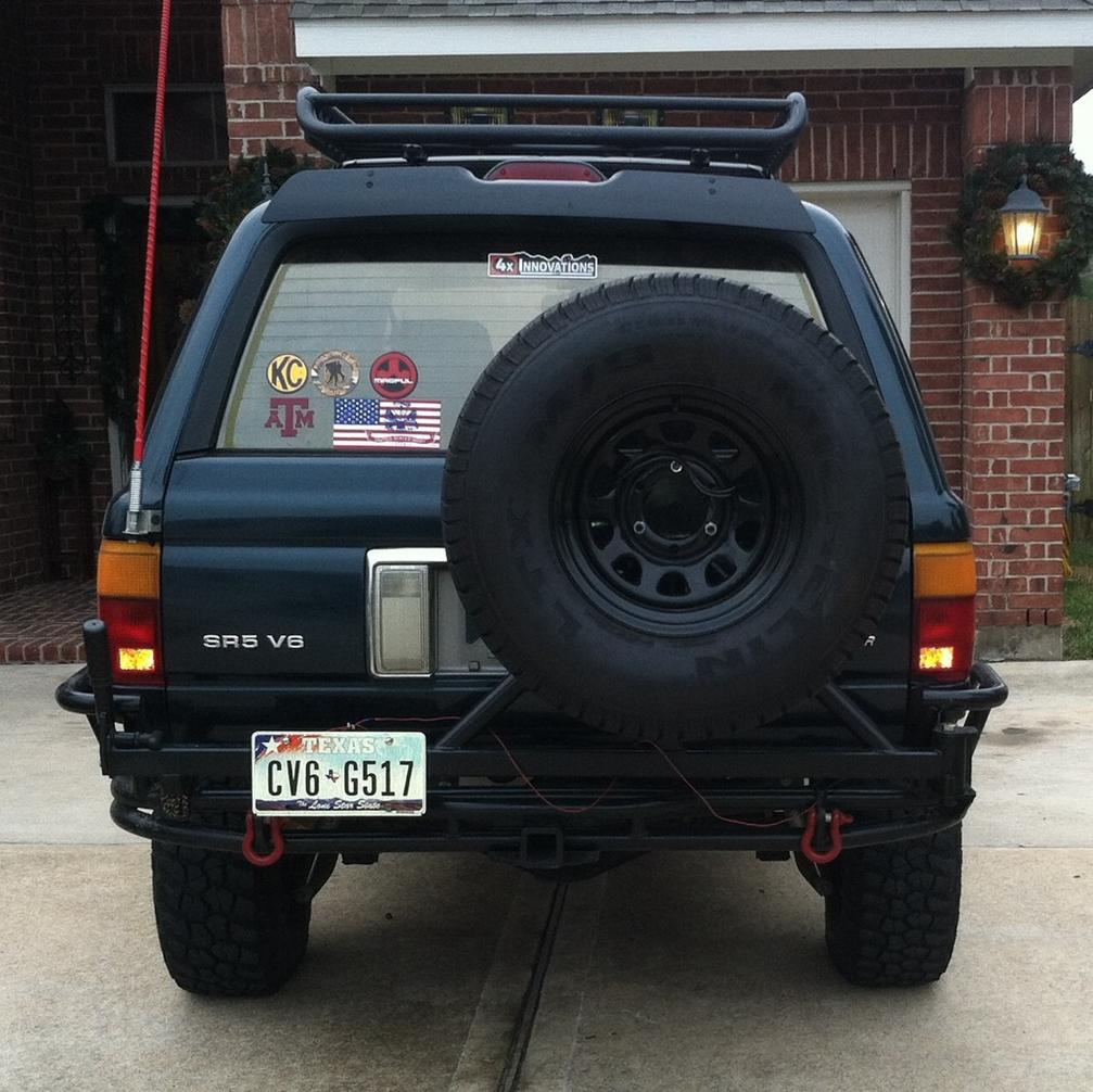

i would be careful about building too much more strength into it... all you are gonna do is move the "weak point" somewhere else, like the frame or the bumper or the hinge ect. and those might be harder to fix that the tire mount... its nice to have a weak spot that simple to fix and will save other parts or systems that are harder to fix/repair or replace... just my $.02
I should rephrase that: gusset the hell outta the sides of the tire mount so that (knock on wood) if this ever happens again the tire mount will bend down instead of to the side and into the tailgate

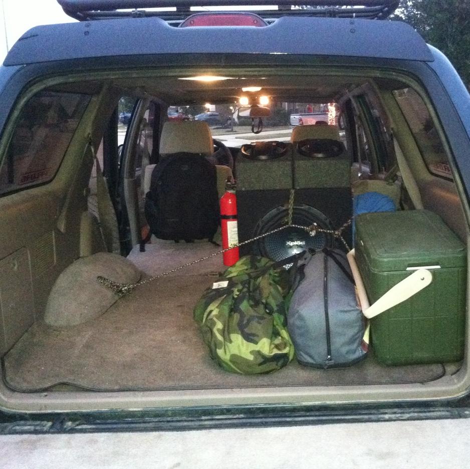

After a mucho cramped rainy camping trip where I was forced to sleep in my car because the tent was just not an option, I decided to ditch the box and do a little tlc. Took out the rear seat and played with some storage options. Imaginary cookie if you can guess where the Henry repeater is:D
