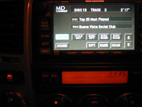

Just installed the unit in my 2003 Limited w/ NAV. The text works!! I will post a write up with pictures soon, including the place that I mounted the unit. The limited length of the cables don't give you much choice. Here's a quick peek at my nav so you guys know I ain't lyin'!!
:rocker:
*mtnrunner - re-program your unit to imitate 'MD-Changer' mode instead of 'CD-Changer' mode and you should see text. This is opposite of what the VAIS manual and gRunner says, but it worked for me. The text didn't work at first in CD Changer mode and I was bummed. But I decided to try the MD Changer mode just for kicks and it worked!
<b>Could this be the very first visual confirmation, in the world, of Ipod text on T4R nav? </b>
:D

Good Deal Slogin and Grunner, congrats
Let me ask you this; what version iPod's are you testing with? I used the iPod photo 60 GB for my tests and did switch between MD and CD changer modes and no text.
I'm actually meeting Eugene sometime next week, turns out he's only 15 miles from my work. He's going to re-program my AIC for Ipod Video support at which point I'll also ping him about text and rear seat audio.

My Bad, Text Works!
I feel really dumb after testing another 60GB Photo iPod today: Text worked! :bash:
I must have ignored the "Title Off" button the first time around.
However, names of Disks, (play lists) don't seem to appear except within the title song display.
But this does provide greater value for me and I do apologize for the earlier misinformation!!!

all the info should be there. the playlist name will always show up in the DISC box, and the song, album, and artist info will always show up in the TRACK box. You can toggle between the 3 by pressing DISC SCAN. Good Luck.
p.s. - another hint, by pressing the SCAN button, you toggle the on screen up and down arrows from searching the current song to skipping discs.
