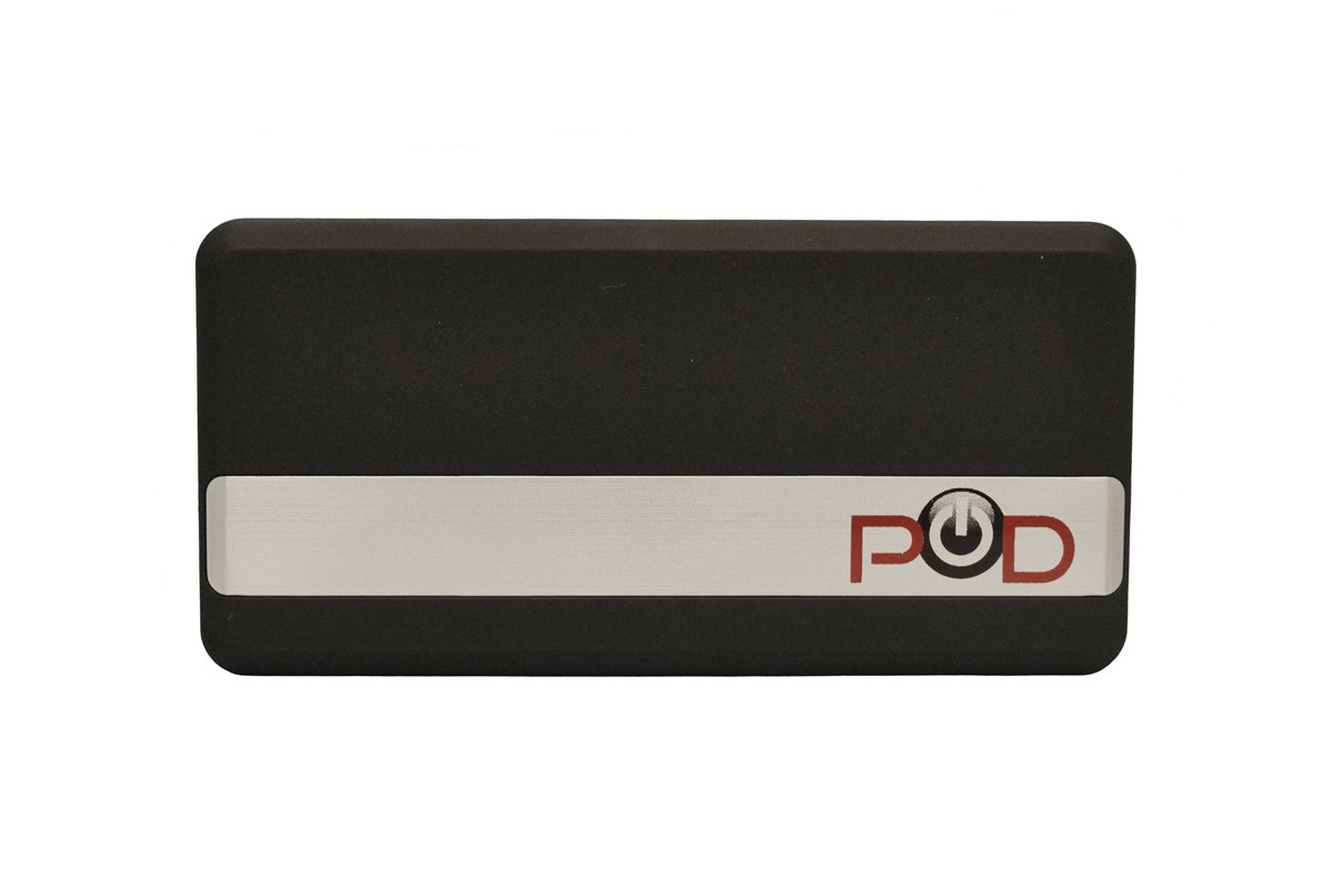

How often do you jump start people that this would be worth it? I would just get one of the small lithium ion jump packs.
The small litium battery packs work awesome. They don't cost very much. They can also be used to power gadgets. Your vehicle does not need to be in position to jump start. The battery pack allows you to jump yourself. If the other vehicle has a dead short battery it could ruin your vehicle. The small battery pack becomes sacrificial. I call it acceptable damage.
I have two. One of them is rated to jumpstart a Diesel engine. Which it can do.
Which do you have?
Both of mine are from Fuseled. I have used the diesel version a few times on diesel and gas engines. I just received the smaller gas rated version. Have not used it yet.
