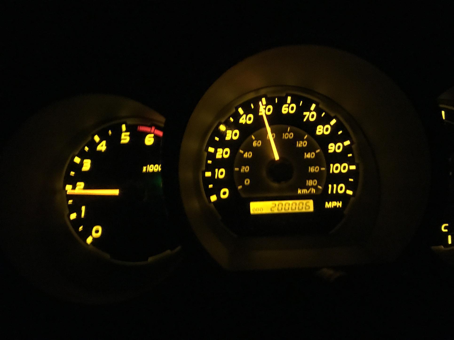

I have an 04.
Just hit 200,000 a few weeks ago.
Still going and no head gasket (knocking on some serious wood right now!!)
