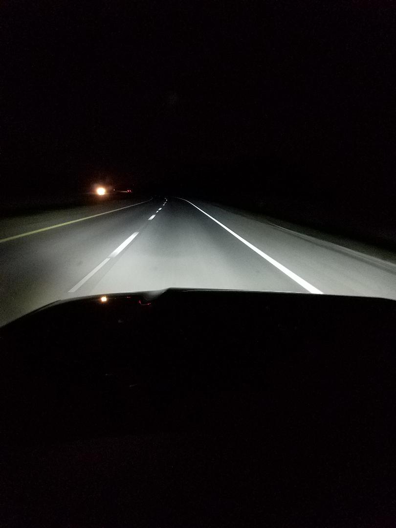

Good set of LED headlights should help.. I hated driving at night before installing my LED’s

They are objectively terrible
2019 Toyota 4Runner
That's phenomenal. My 2020 has lights that are an embarrassment relative to any car with factory HID lights. My C63 has adaptive HIDs and those are the single best set of low/high beams I've driven in a span of 25+ cars and 35+ years of driving. Hell, my wife's three year old Prius has low beams that blow away the current year top trim 4Runner. That's just a joke.
That said, the 2020 TRD Pro, and I imagine other trims as well, have a set of excellent LED foglights that do a tremendous job of filling in the foreground, but more importantly, the sides of the road when used in conjunction with the shitty halogen projectors. I recently replace the halogens with LED bulbs in the projectors and higher output halogens for the high beams and while the improvement is significant, the fogs are still required to see what's happening off axis when driving down the miles of dark desert road I'm on frequently.
your cut-offs are fuzzy b/c the projector lens is not designed for the diod placement. HIDs in the low beam, LEDs in the reflector high and fog. I took it a step further with rigid sae dualys in my fogs, but the output is not much better, just reliability.
Plenty of pics with hids in stock halogen projectors showing how the cut offs are clean. Clean cut offs are important because you can have tons of usable light without blinding on coming traffic.

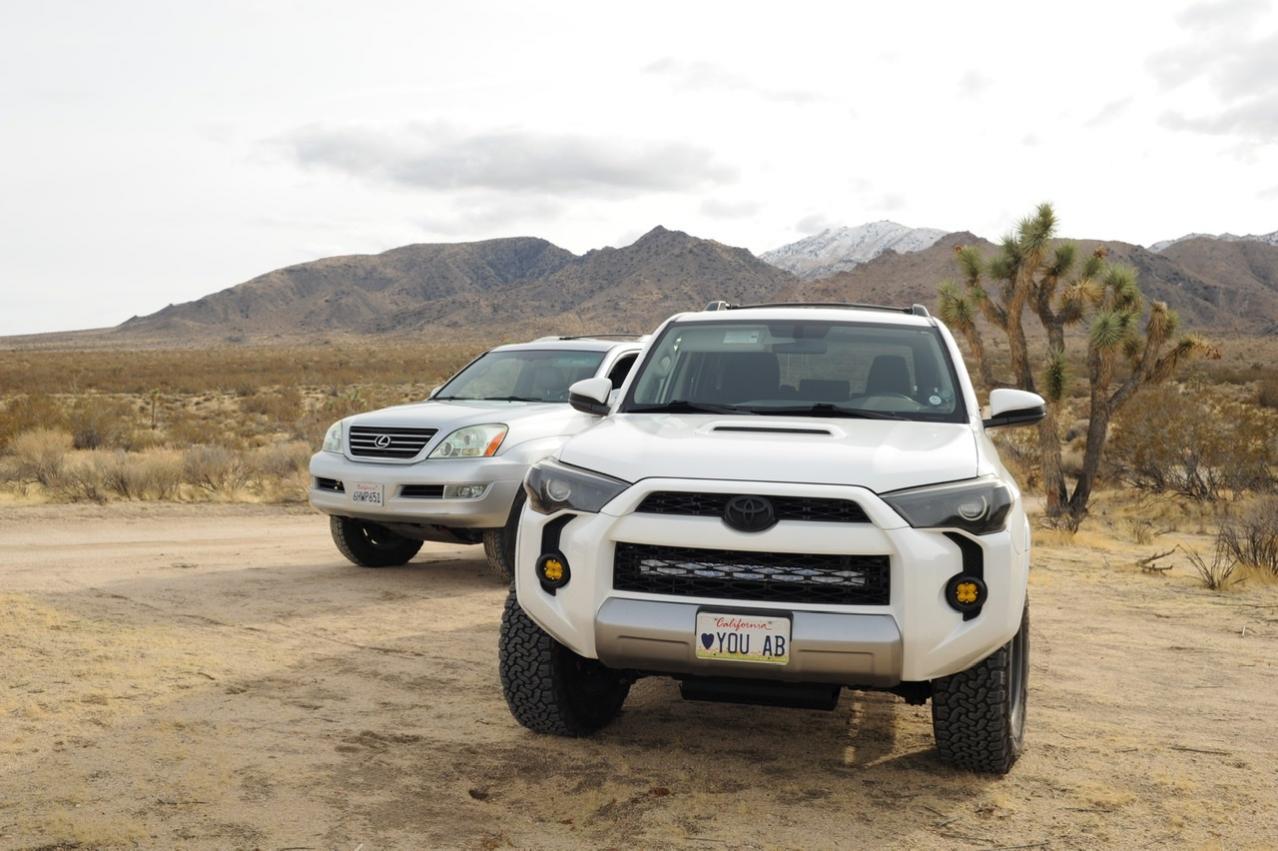

I replaced my stock halogens with Kustom54 LED retrofits. The LEDs light up the road so much better, and the cutoff is excellent. Totally worth it.
