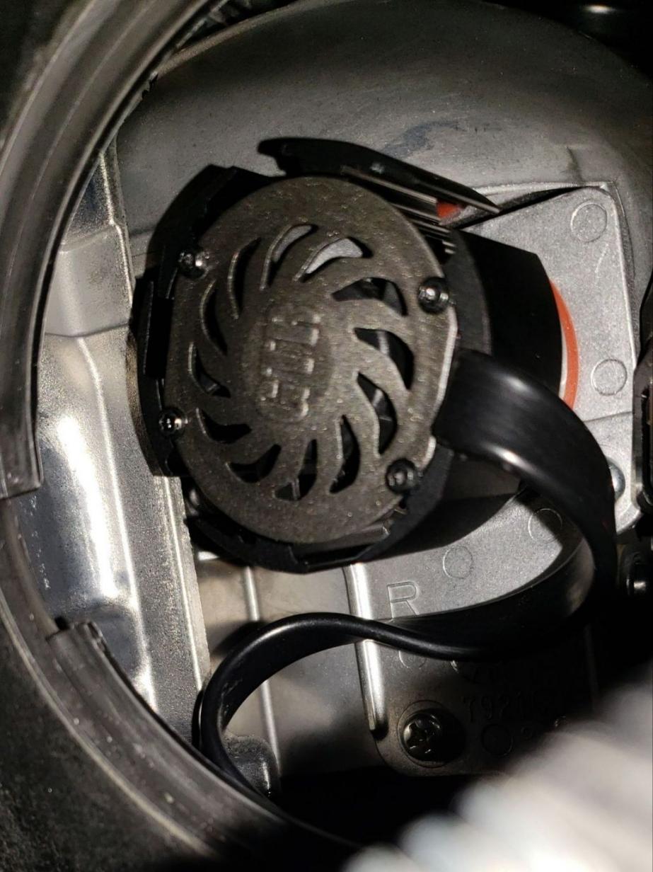

Can you snap a pic what it looks like under the cover? I know its fan cooled, my question since its a closed housing, where does the heat go? Do the run hot? thanks
I don't know how hot they get, and I am happy about the lifetime warranty (need to read the details of that), but they fit easily. I do wonder how hot they get especially inside the enclosure.
Thanks, did you have to adjust the alignment? One video said its needed and another said its perfect out of the box
