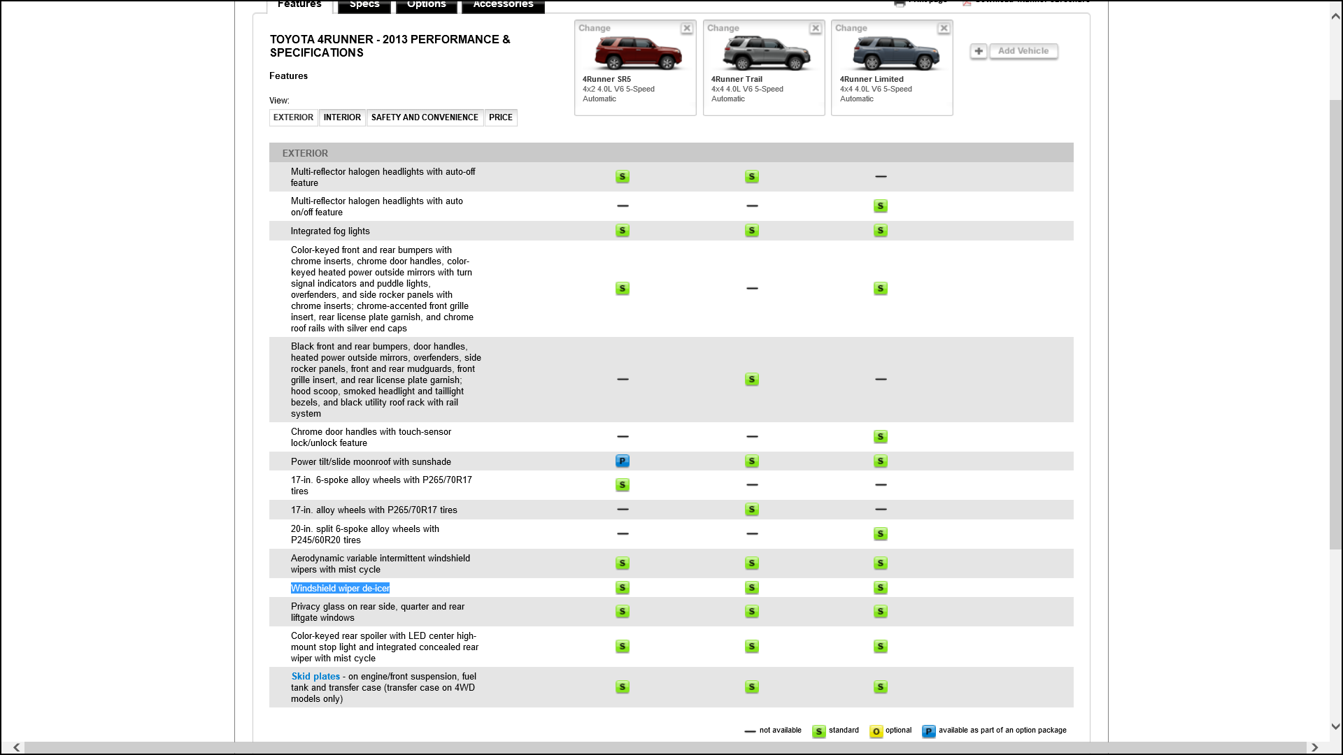

I checked my windshield this morning before work and it has the heater on the wipers like the previous thread with the picture. Made in Japan means original Toyota parts so I am happy, as for you I know the folks there must think you are difficult but its a 40K truck I mean its not a Yarris or a civic you paid for it so even if they hate you for making them change it too bad for them just go to another Toyota dealer if there is one close to do your maintenance or explain to them it comes as STANDARD ! Page 312 in the manual book.
There's an older thread on the heated windshield where a bunch of people were confused about who had it and who didn't. I seem to recall the feature being a mid-year addition in 2010 or something along those lines.
Yes, you are absolutely correct. Some of us (2010-2011 t4r owners) don't have heated windshield because it was added to the production at the end of 2010 production year.
If you have a button to turn heated windshield it means your windshield should support this feature.
