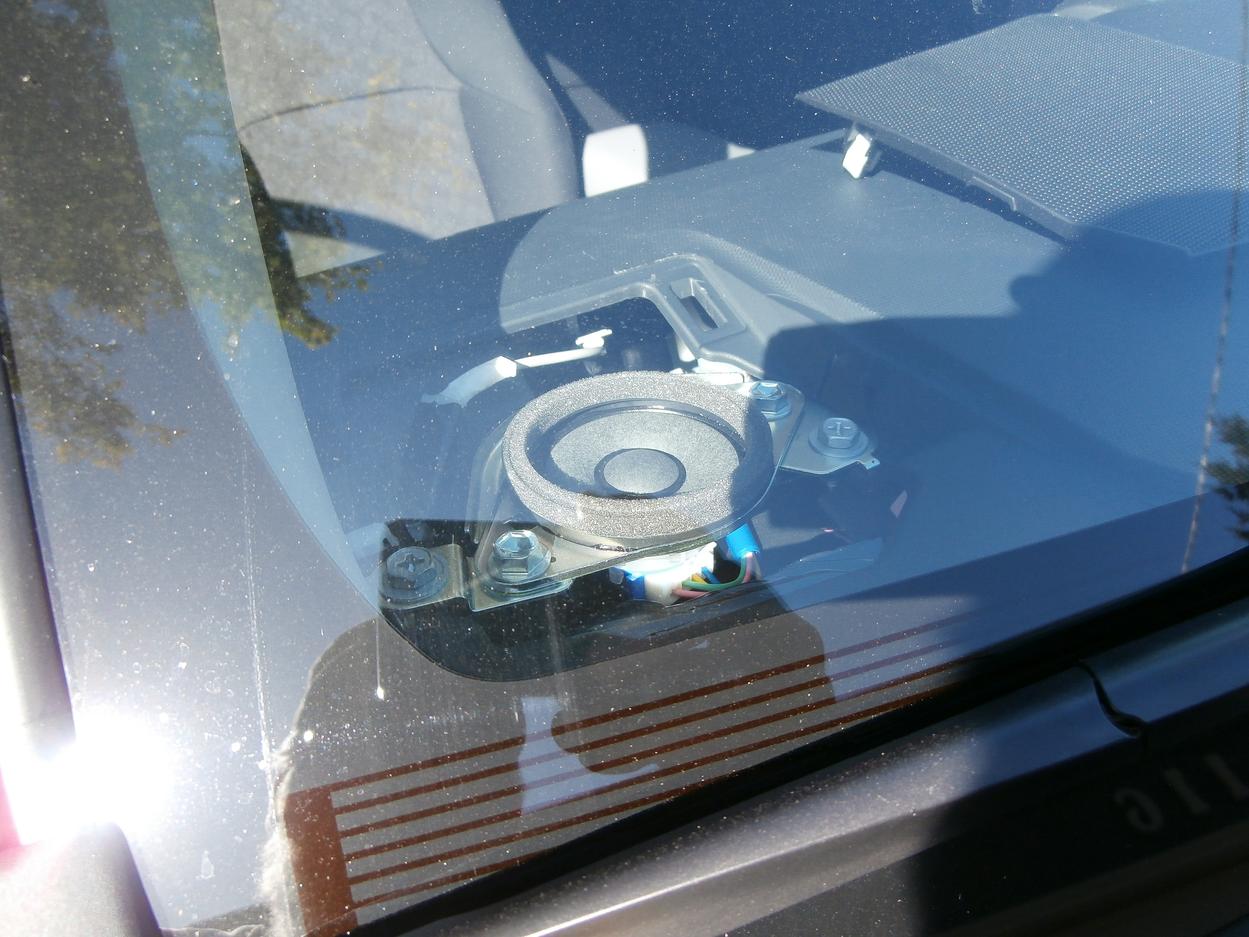

Hey guys.. i purchased my 2010 4runner in march of last year Certified.. it has a heated windshield.. but the windshield was replaced before i bought it.. i'm not sure whether they replaced it with a compatible heated windshield vs a regular windshield :der: .. are there any clue lines or marks that heated windshields have vs regular ones? i really would just like someone to take a pic of theirs if they know what the difference is and show it so i can compare.. if so i'm gonna MAKE them replace it with an oem one! THANKS GUYS!!

Pretty sure someone else will chime in with the correct answer but I believe it has lines at the bottom of windshield similar to the rear glass
yeah, im 99% sure there are 'lines' or 'dots' on the bottom edge of the windshield that heat up, and warm your blades.
I'm 100 percent sure there are lines. Get a flashlight and shine on windshield where the wipers rest. You should see a grid of lines. If not the windshield is wrong. You do have a switch on the bottom left of the dash right?

And to OP, there are very obvious defroster grid lines directly under the two area where the wipers rest, no way you can mistaken it if you have them.

Here's a pic I took when replacing speakers. You can see the traces near the bottom of the glass where the wipers park.
yea i definitely don't have those lines and yes i have the heated windshield button. it wouldn't be a fuse cuz the button also lights up and yes the rear wiper works.. ok.. so now i go to toyota here get it in the record that it doesnt and call toyota of michigan where i bought the thing.
