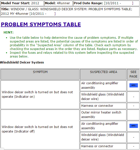

So... is there an easy way to debug this ?
I was looking for a haynes or chilton manual for 2012's and there doesn't appear to be anything available.
I've validated that the fuse is good. Switch is there and lights up.
I did have the windshield replaced, I don't see any toyota etching in it so I'm not sure if it's aftermarket (probably is) but it does have all the requisite thermal wires in the glass at the wiper level and up the driver's side A pillar.
I'm tempted to open up the passenger side A pillar and validate that the wires are attached but haven't done this before and prefer not to mess with things that could set off the air bags :)
Thoughts ?
