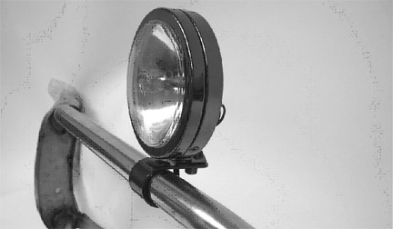

Auxiliary light bracket kit attached
been looking for a way to attach my Hella 500 to my Waag FrontRunner. I have located this as an option
AUXILIARY LIGHT BRACKET KIT

I checked those brackets out last year. I like how they attach, liked the cost and they look like a much simpler solution. Ultimately, I decided to do something like momo because I wanted a certain placement that I didn't think I could get with those brackets...

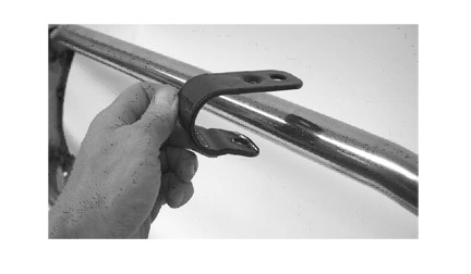

FYI... for those that want to see a visual of the brackets mentioned by thomasugenius... here are some pics of the brochure that WAAG sent me for their brackets...

Hello 500 floating front bumper mounts
I like the mounts very much. In fact, I have been looking around for various solutions to mount additional lights in the front, instead of on the bumper and I think you have found it.
You said that you got the metal bracket parts at HomeDepot. i was wondering if you did and have measured the dimensions of the bracket needed as well as where the bolt holes need to be
drilled.
I am ready to do this project this weekend if I can get a few starter tips on materials & dimentions.
Nicely done Momo.
Ok... So thanx for the write up on this... great idea and placement of lights... I bought an 07 last saturday and put my lights on last night... the wiring is very simple... there are two wires coming off the back of the lights... the BLUE wire is GROUND.... I attached this to the bracket bolts and it is a great ground... the BLACK wire is the POWER for the lights... this runs to the relay supplied in the kit... the RED wire from the relay is CONSTANT and needs to go directly to the positive terminal of the battery... the BLUE wire from the relay is GROUND... I attached this to the drivers side of the engine bay with a Self tapping screw... the YELLOW wire goes to the SWITCH to turn provide switched power to the relay... The GREEN wire needs to go from the SWITCH to the POSITIVE side of the battery terminal just like the red wire... the small BLUE wire is the GROUND for the switch so the switch itself will illuminate... so two wires need to run into the car... Yellow and Green... the rest are all in the engine bay... let me know if you have any questions... the wire colors are not normal colors... good luck and thanx again for the write up....
