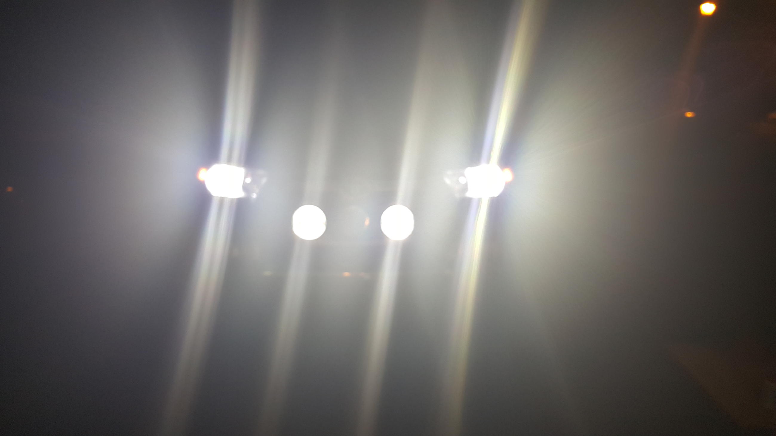

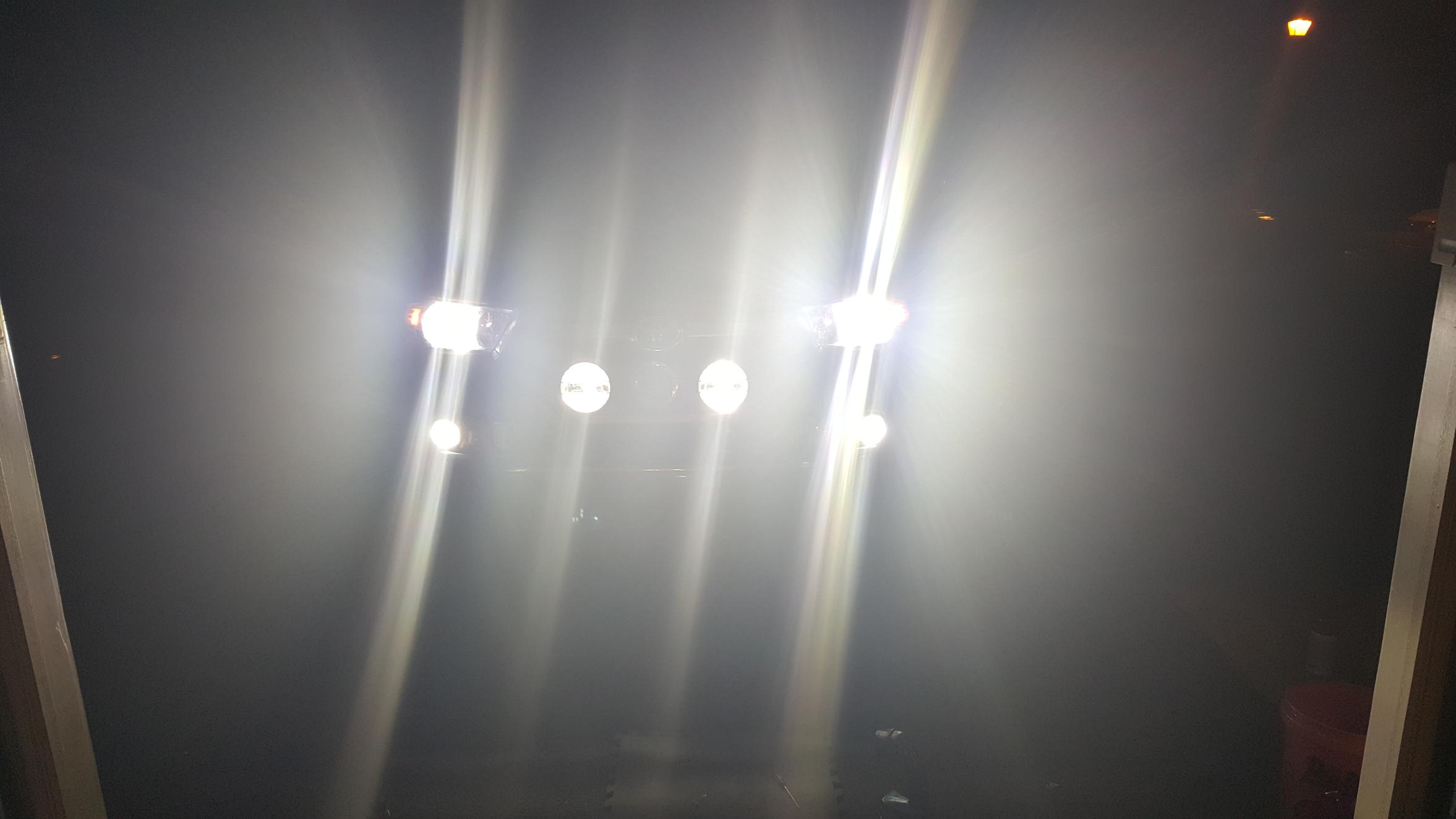

Amazon H3 led conversion. You just have to bump out the back of the hella housing or drill a hole. I went with heating it up with a blow torch and pushing out with a screwdriver handle and using a piece of pvc to use as a mold.
