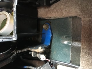

I don’t know about the tub lining up. I did mine years ago but I don’t remember having to do anything to it.
As for the handle, crooked to the pass side is correct. Look at where it sits in the new console. It’s on the pass side. It should line up.
Edit: I pulled the console up for a look. It looks like I may have beavered out the holes in the tub to match the body. I for sure did not put new holes in the body. Here’s a pic for what it’s worth.
I would imagine offset to the right towards passenger would make sense, but on that last photo, do you see how it's more-so "pointed" to the right? I'll go out and take a look at the 99+ console and see if it looks like it would line up.
Hey thanks for pulling that off to check.
Take a look, I slipped the console on over to check the fit. Can you confirm this is correct? I tried to get the camera angle as straight as possible to show the brake pointing off to the right.
2nd question - Would it be possible to just leave by 1998 tub in? I did notice the 99+ tub's hole for the brake line does actually come in at an angle (pointing right) which would line up 'more' correctly than the 1998 tub hole.
At this point, i'm thinking of like you said, 'beavering' out the 99+ tub to line the holes up correctly with the pre-drilled holes in the body.

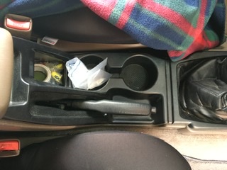

Here’s how mine looks. Right or wrong it’s been this way a long time.
Sweet, thanks for another image.
So i'm going to say mine looks just like that, great!

Only thing I can think is that the new tub lines the cable up with the handle a bit. I honestly can’t remember what I did but I do remember it was late at night after work. I may possibly have left the original in also. Sorry can’t confirm, too long ago.

[MENTION=174982]bryanbgw[/MENTION] Looks like it was answered in this thread, pointed to the right is correct, the ebrake is supposed to sit crooked so you clear the cupholders. If it was straight it wouldnt clear.
Also, if you truck was built prior to 4/98 you will either have to notch the holes on the Ebrake cup, OR take a dremel to the opening in the floor for the ebrake cup.
Also, The 96-98 ebrake cup is straight, the 99+ is angled to account for the angled ebrake handle. You can use the 96-98 ebrake cup but it will bind the cable slightly. Not a super huge deal, but I always provide the cup so it doesn't bind.
