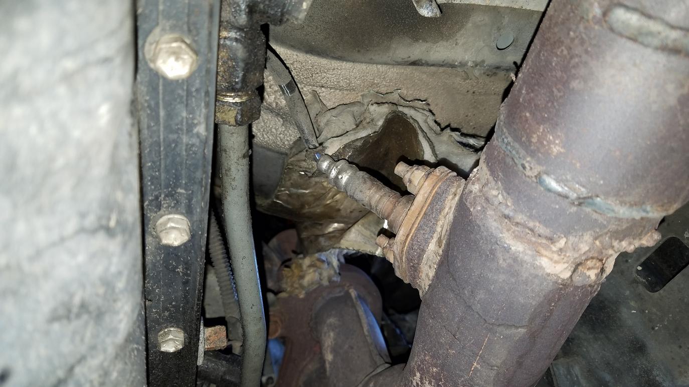

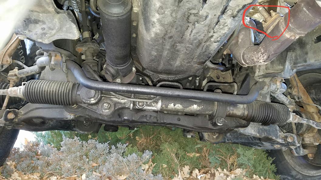

i could be wrong so maybe someone on here knows. i was under the car taking pictures yesterday so i could have for future references. i circled in red what i think is the sensor and the other pic i think is actually it.
Hopefully someone here can double check it before you think it is the sensor because i am not 100%

Yes, that is front O2 sensor.
