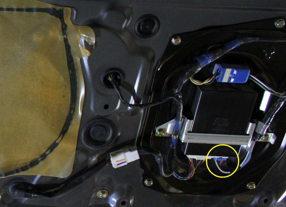

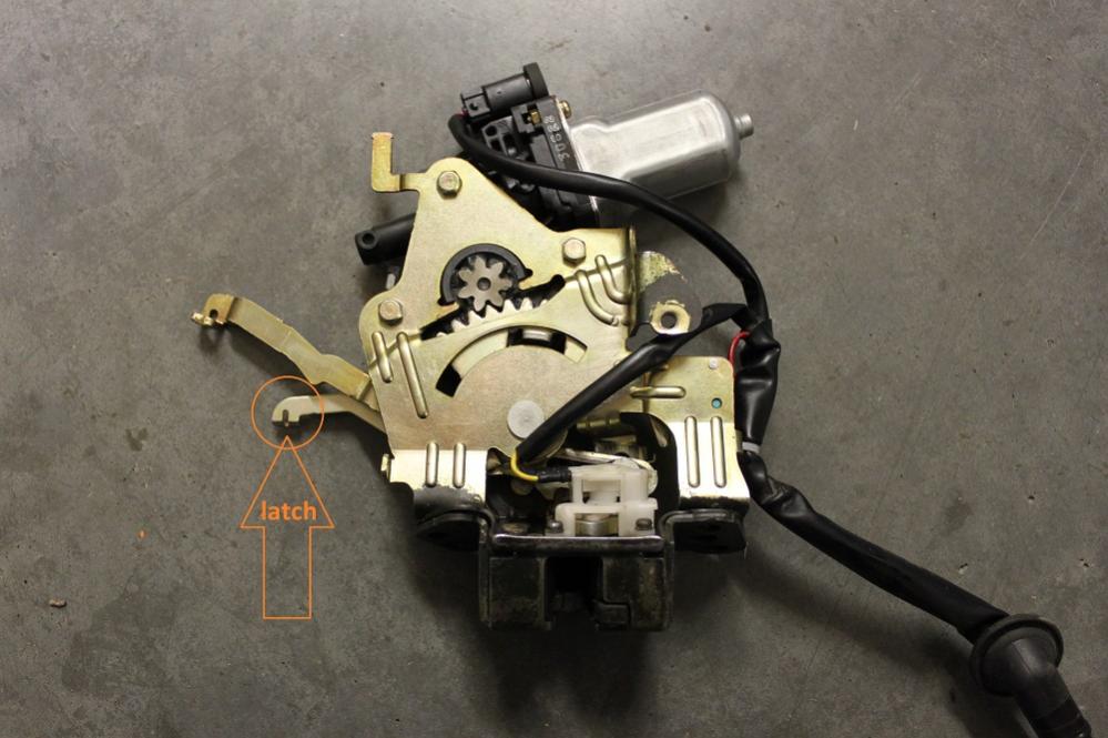

This tailgate deal got me last sunday.
After cleaning the lock assembly out the switch would not work.
Unpluged the bottom right side tailgate ECU for a 10 count then a 2x unlock with the key fob...now it works.
Also that left side of the white plastic cover pulls straight up and off.
And if your pulling the wrong lever you could be Superman and it wont unlock the latch.
