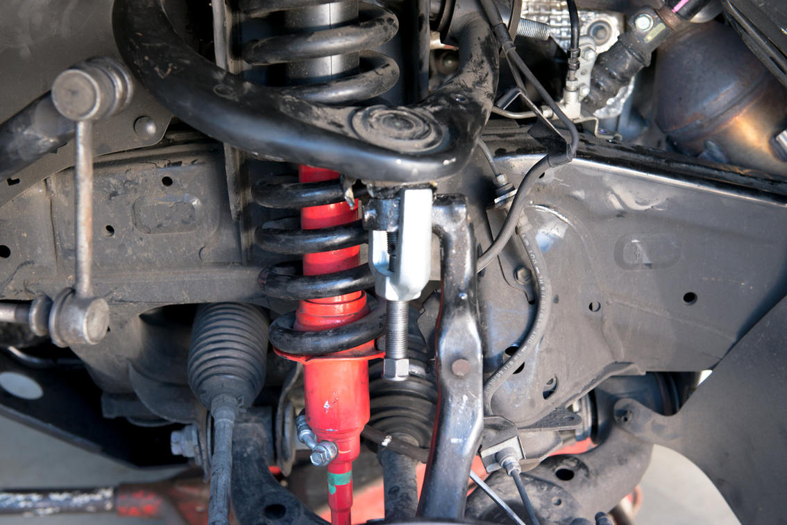

late to this, but one of these pitman arm pullers from Autozone Loan-A-Tool makes super short work of the job. OEM/Pitman arm puller 27016 - Read 7 Reviews on OEM #27016

[MENTION=65614]Antman[/MENTION] that's what it was "Pitman arm puller"
Here it is in action:
You better delete that photo before someone reports you for UCAA.

UCA puller
