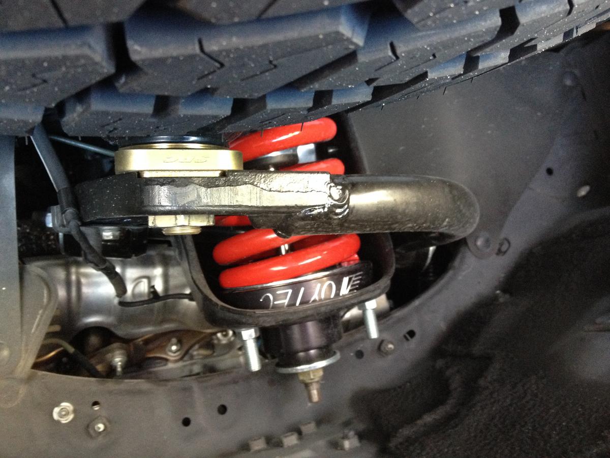

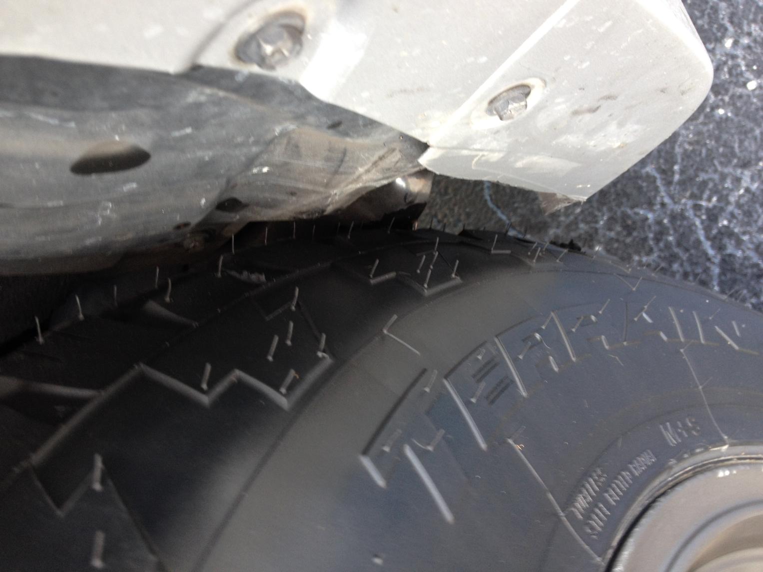

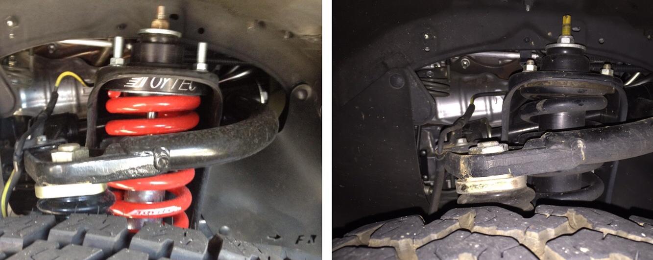

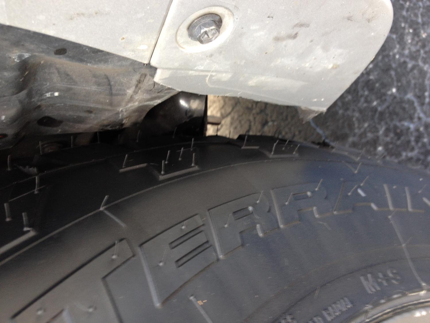

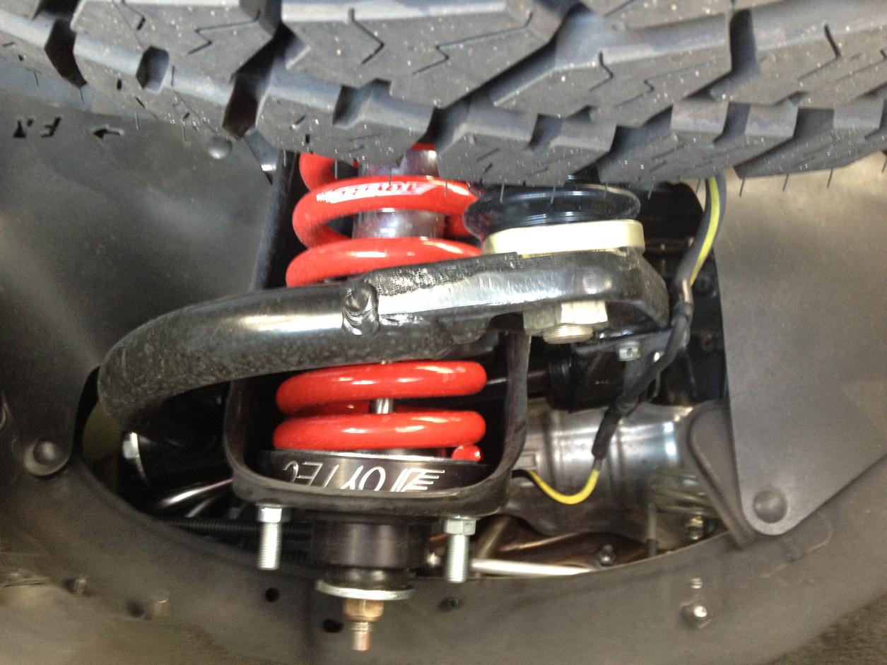

Ok so heres an update. Im mainly rubbing the metal from the wheel well on the back side where it wraps around. Im going to attach pics. I measured from the middle of the wheel to the bottom of the wheel well and I'm at 23" now. It is rubbing rubber though and its just on regular roads. Toytec thinks they may have done the alignment wrong with the LR UCA's.

You shouldn't need a BMC with the 33" tires and correct offset wheels you have. I'm with Toytec that the LR UCA's were set up wrong. Probably set them up at the -2 setting or more instead of 0 to begin with. That would push the wheel back as a starting point . They already have -2 built in at zero.
SPC logo should face outward!Let's see pics of the the LR's
I think the only width those wheels are available in -12 offset is 9". If so, a 9" wide -12 offset wheel is pretty aggressive. You would rub a bit more than someone with a 8" 0 offset or 8" -10 offset wheel would.
Holy SH!T man. They ordered the wrong wheels. They got the 17x9 and not 17x8. I can't believe I didn't catch that.
Umm ,They installed them up side down!!!
But seriously ,those LR UCA's top cams actually look like they were set right.
Do you know what they actually set your alignment to? especially the caster setting?The higher the caster setting the more it moves the wheel forward in the wheel well and thus less rubbing in the back.Easy to adjust the front liner so it doesn't rub there .Specs are 2.2 to 4.0 with getting the camber real close to 0 but alot of us are running 5 or more and still get 0 on camber and what I prefer.
